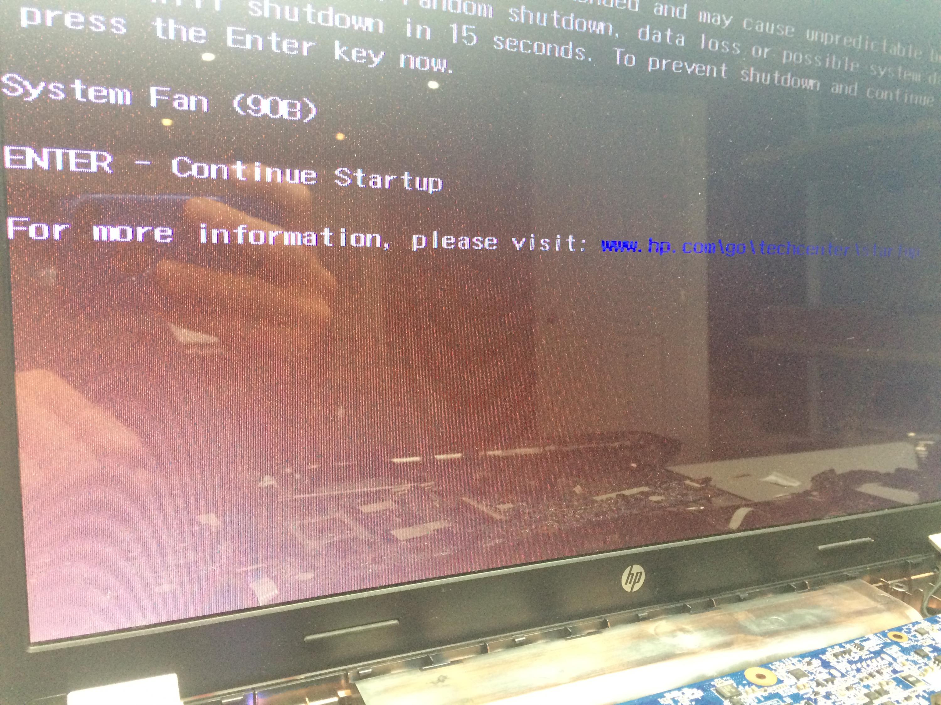

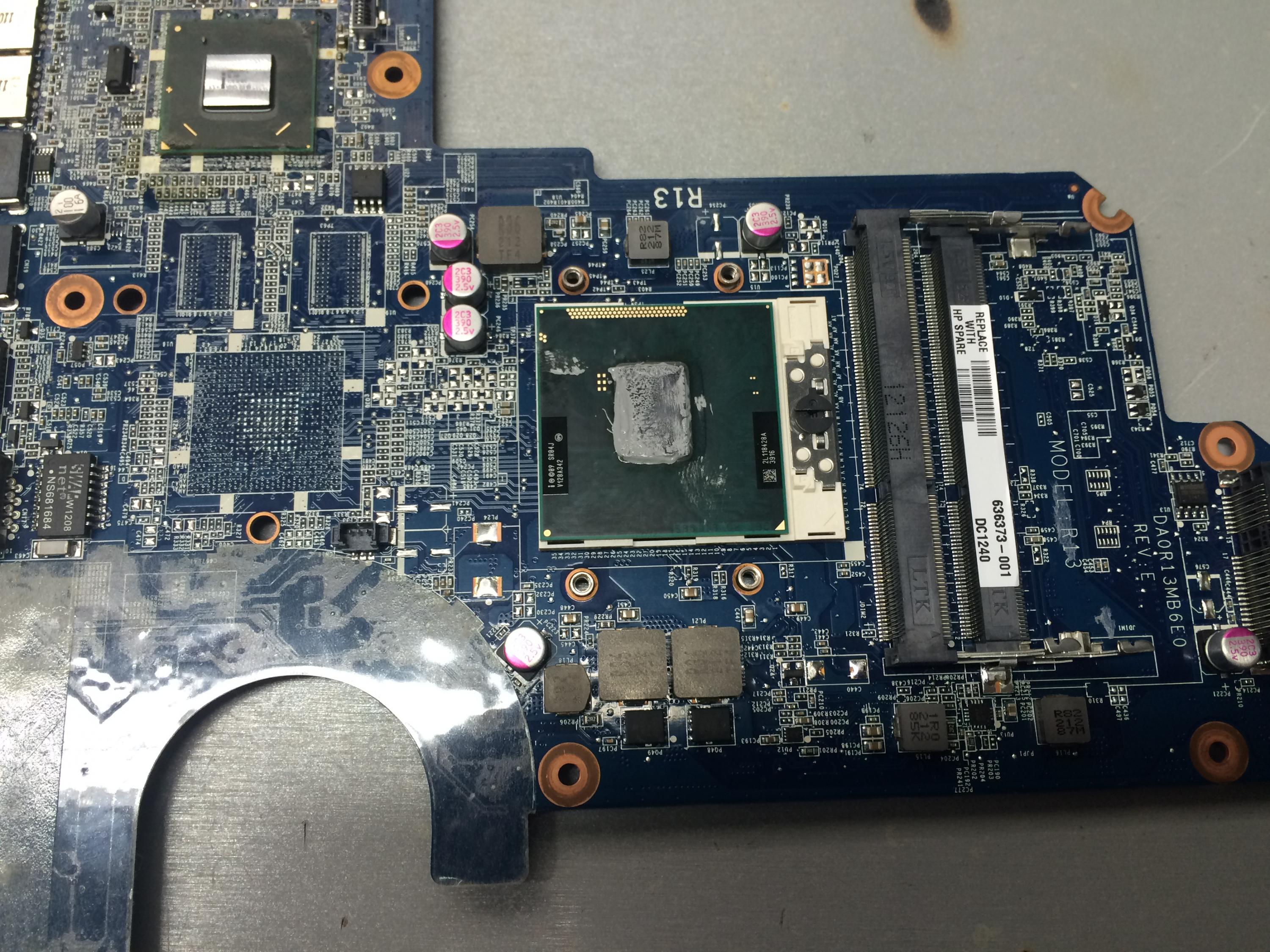

    Hello, here i have this HP G7 laptop with snowy red display on both lcd and external. I've tried reflowing the GPU but no dice. Any ideas on this one ?
    I have another identical board with another issue, usb ports are fried.
    Anyone thinks it's the GPU ? Would it be possible to do a GPU swap, or waste of time ? Thanks for any input.

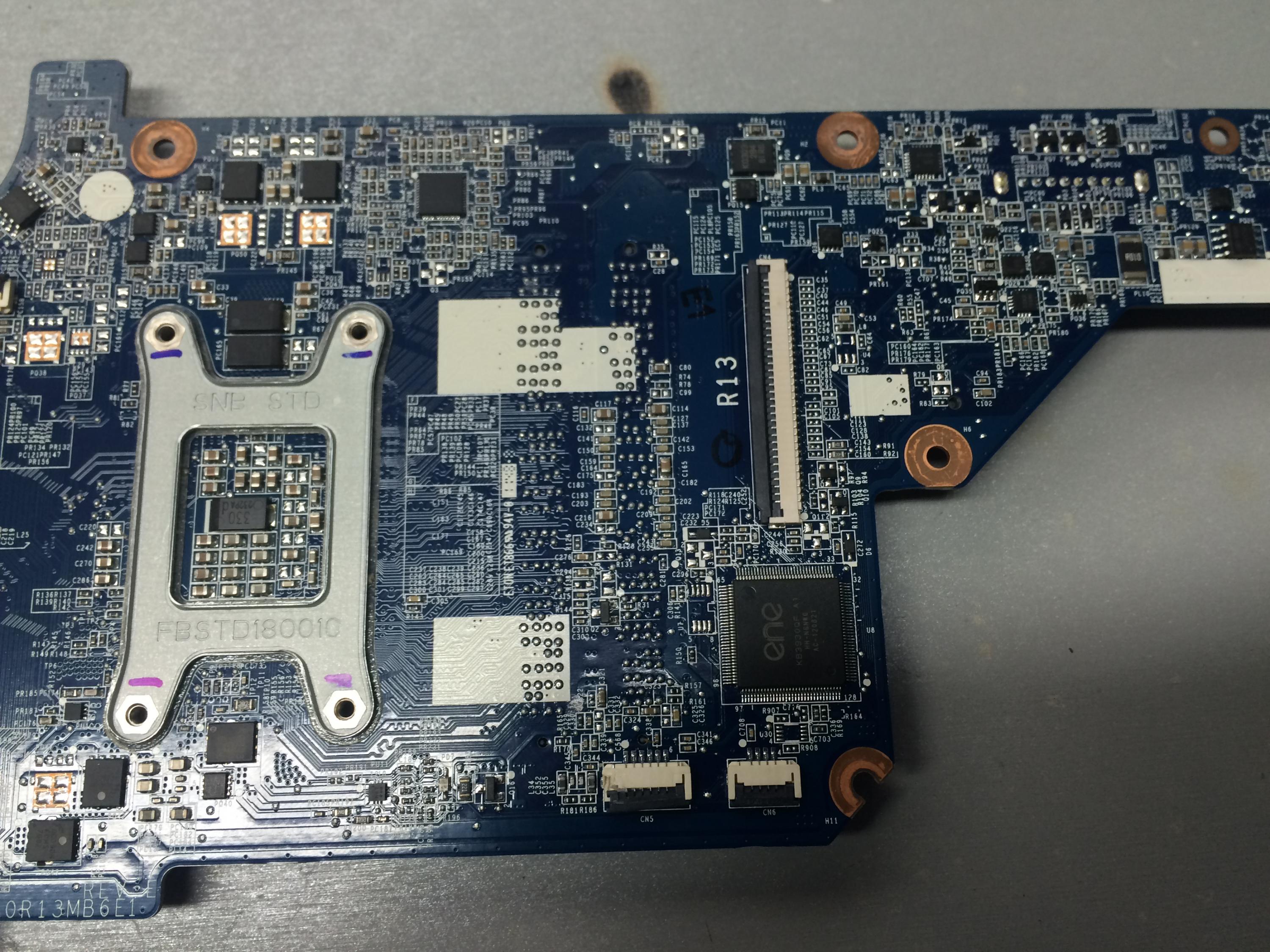

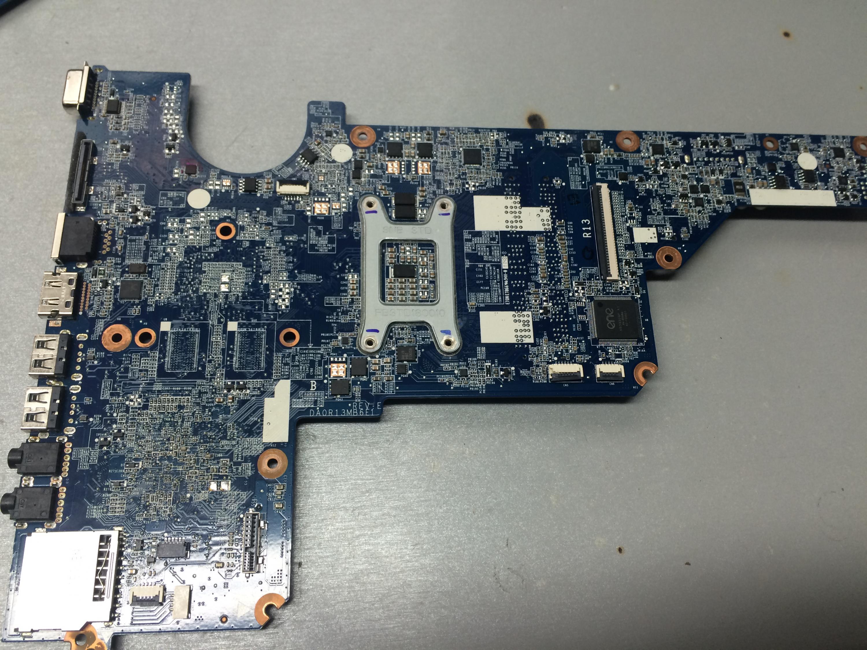

    Take a picture of the board. Isn't this one of those boards which have the eDP-LVDS converter on them? If so, that could be the culprit, not the GPU.

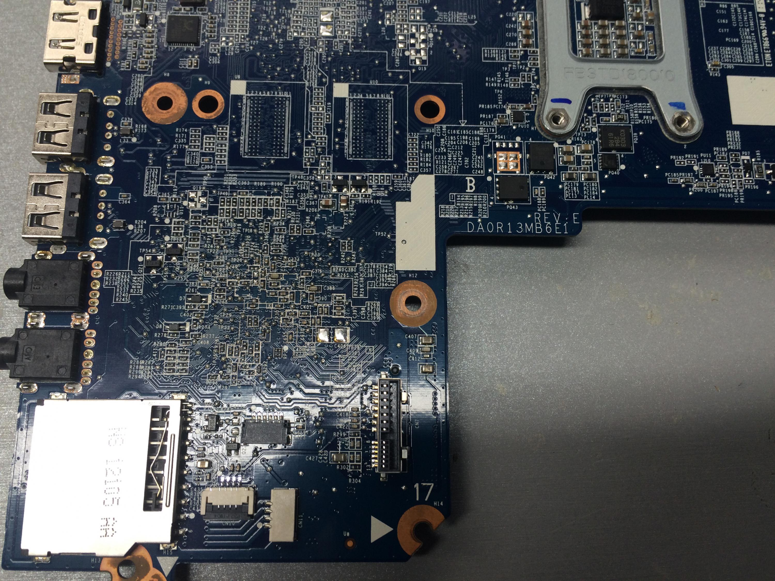

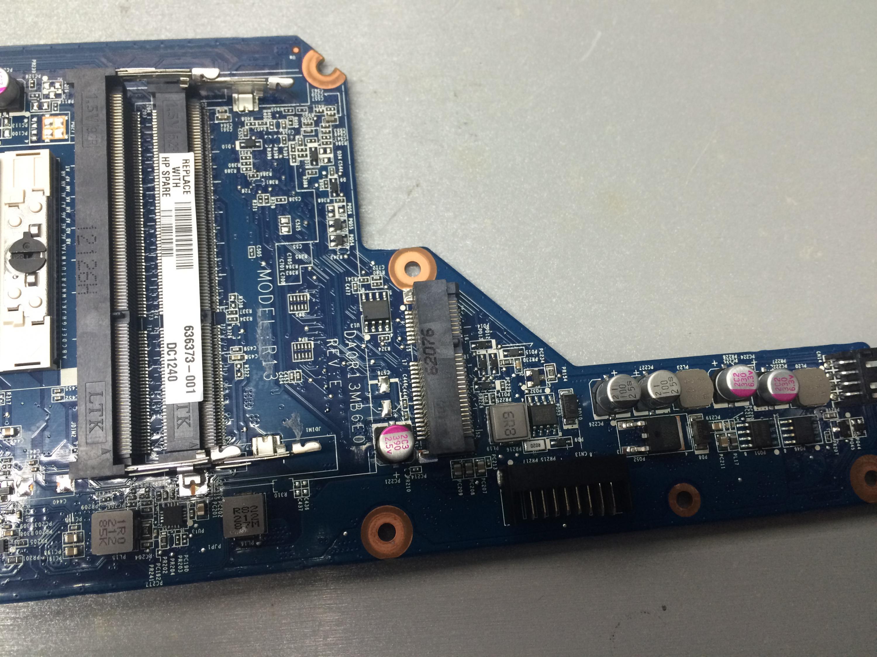

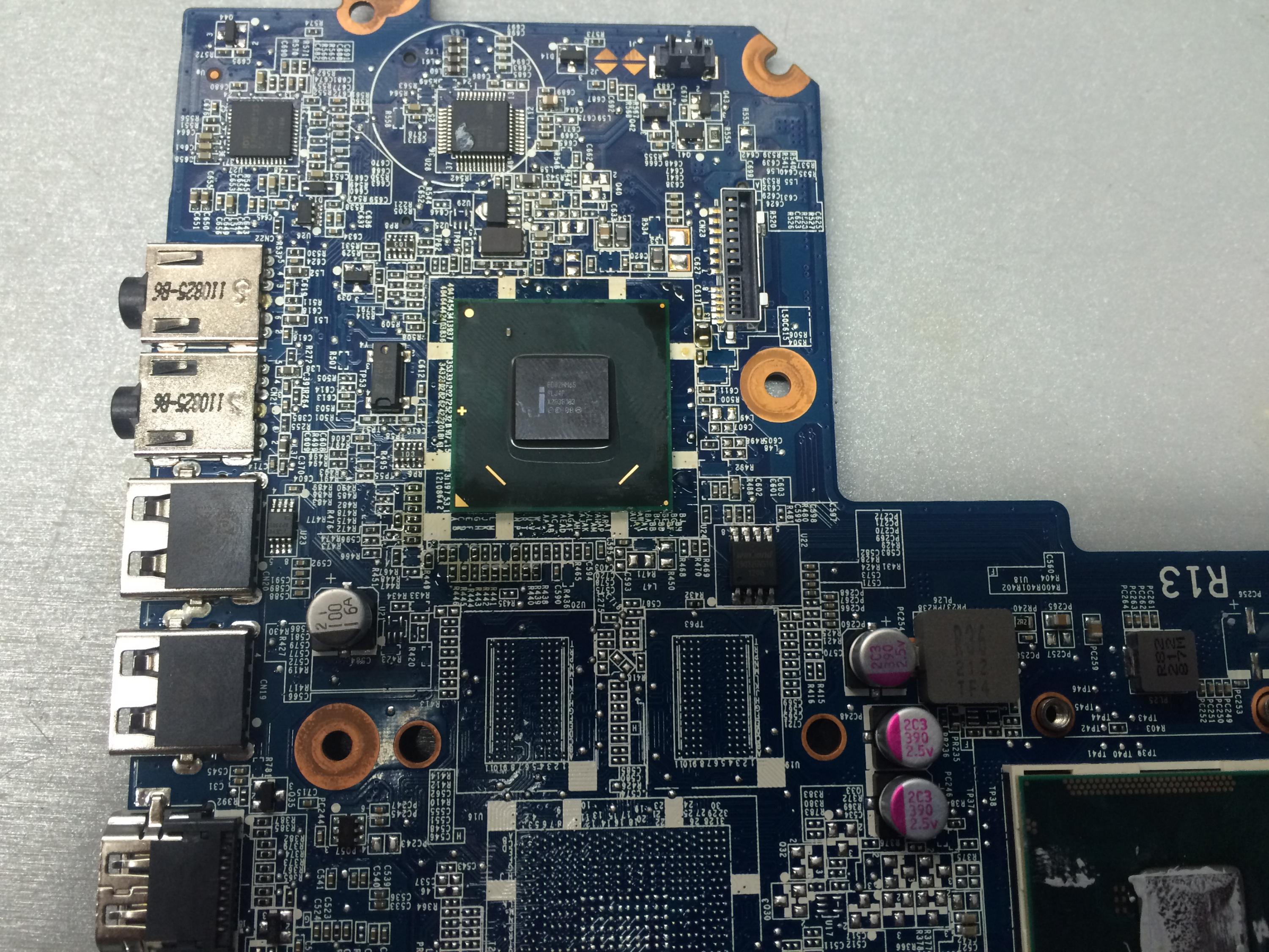

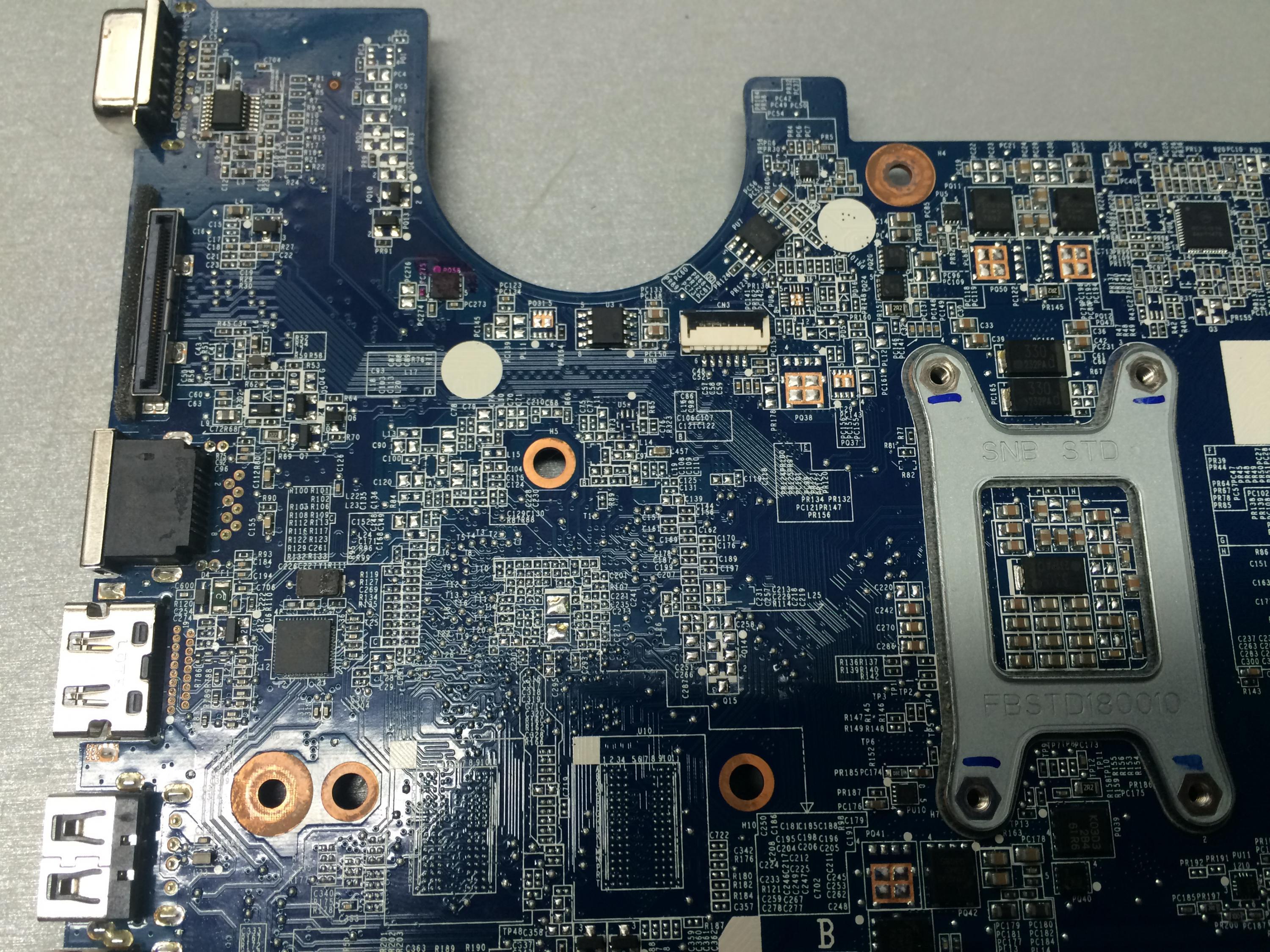

      Ok, here are some pictures of the board ! If you can help fixing that i'd be quite happy, i might be dumb but i couldn't figure out where on the board could be a t-con (or lvds converter) !!

        Th3_uN1Qu3 whenever you have a minute check these, i'll repost and try to get a better quality if needed.. Thanks

            Try with another processor , if not working , change the intel HM chipset

              Ok, the intel HM chipset has the included graphics i guess ? Another processor won't change much, tried it.

                I had a same failure, mine was little bit mor of Orange (RED) it was a GPU!
                It was a ATI GPU

                  Okay. So the failure is the gpu. Worth it to change the chip ? I got a IR preheating station and some hot air.

                    at your mainboard gpu is intel HM chipset
