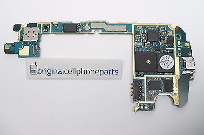

    Does anyone have a schematic for a Samsung Galaxy S3 T999?
    The phone reboots under heavy load on the internal flash chip(rom backup / flashing). It succeeds when placed in a freezer to flash. I have tested it with the CPU maxed out (no load on the flash chip) with a battery discharge program and have no problems.
    So, it seems to me, to be a flaky flash chip. I assume the bga needs a reflow.
    I'm thinking a few minutes in a pid controlled toaster oven could cure this. Alternately I could reflow the flash chip (if I can find it) with a hot air station. Or I could do a ghetto repair by putting pressure on the chip with some paper to hold it down.
    Any ideas? Thanks!!

    Post a picture of the main board and i'll show you where the flash chip is. Hint: It's large, it's near the CPU, and you can find it by a simple google search of its part number.

      Here is a pic i took from ebay. The only camera i have is my phone...
      By your description, the chip with the round white sticker?
