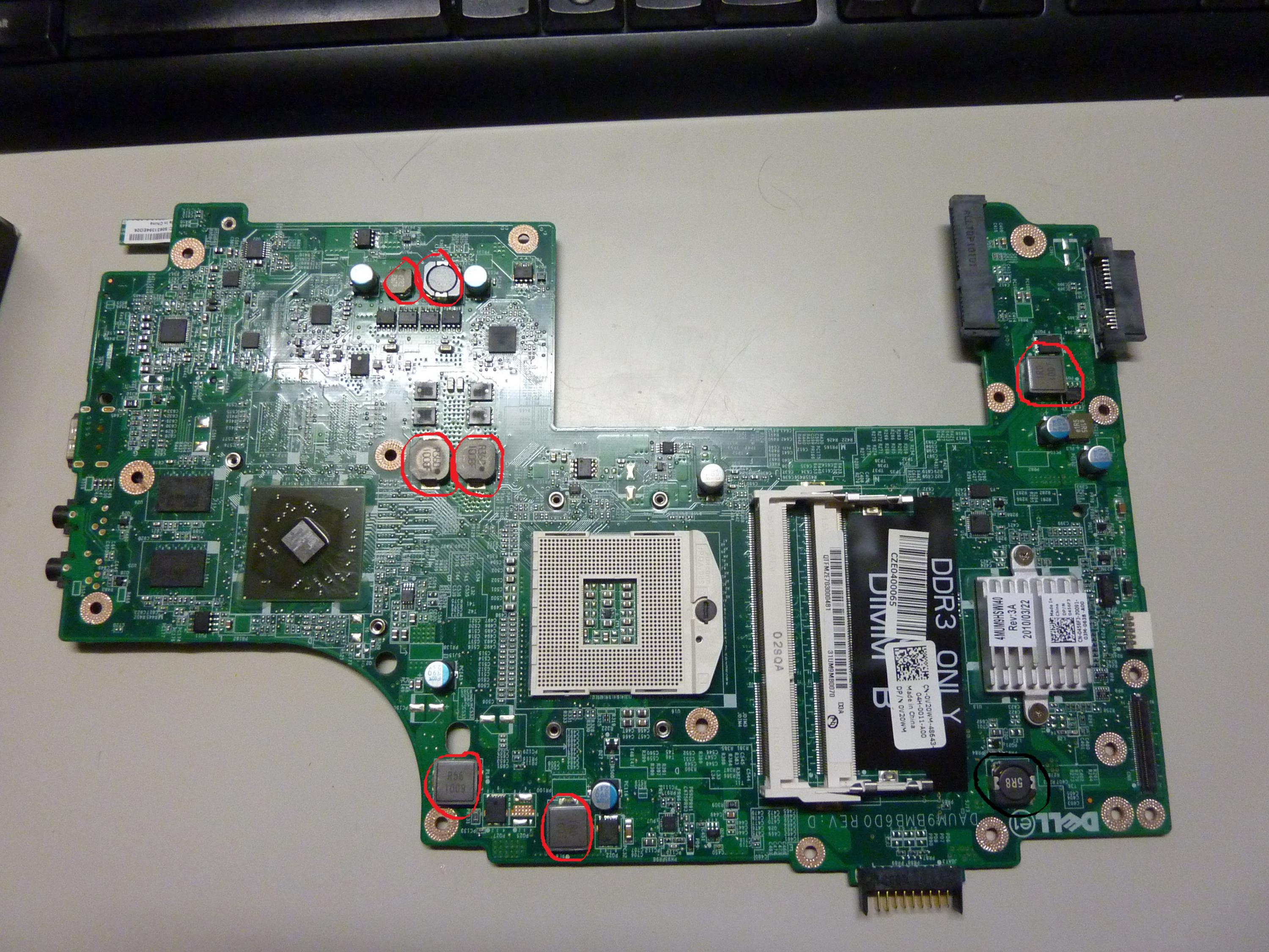

            I don't know if what I did it right.
            I took a picture.
            I tried all components encircled. I hope there is no more coil on the motherboard, but to be fair I am not sure.
            So I tried both side of each. So, with a black circle no beep, and purple circle, all beep.

                • dj_ricoh
                  • Jan 2013
                  • 2073
                  • uk
                  Re: Dell inspiron N7010 won't turn on
                  continuity its when the dmm Beeps.
                  caps for instance beep on one side because they are connected to ground.
                  so if you probe a cap it needs to beep on one side then other NO.
                  for instance there are FET`s that are connected to ground as a pull down Voltage.
                  but most of the time you find the short eder on coils , fets or caps.
                  if you don`t find any short on coils or fets and you find short on caps UNDER PCH or GPU then bga work its required. (thats where i stop cuz i don`t have any xp)

                    • dj_ricoh
                      • Jan 2013
                      • 2073
                      • uk
                      Originally posted by Smilo_
                      I need to go further in my research. I think, if I know how to read an laptop schematic should help me a lot. Because I have some problems to link the pages.
                      A lot of coils on the pcb beeps but maybe only one component is short and this one link a lot component to the ground. I need to probe to the beginning of the schematic, but I don't know exactly where to start. From the power, but I have some problem to follow. I will try to understand how to.
                      But thanks a lot, I learnt something. Perhaps I should find another pcb with a easier problem, this one is maybe too hard for me.
                      first rule on probing coils its to take cpu out.
                      lets say if you got a short on the gpu coil then you need a bga station.
                      but the cpu you can take it out.
                      every coil got a marking aside. write in pdf on search bar and it takes you.
                      here on forum you tell us what coil its shorted and we all look and say what wrong there. what to look for. what can be wrong.
                      for instance if you desolder a coil a short must be on ONE side.
                      the hard part is to identify the side. where it goes then we trace.
