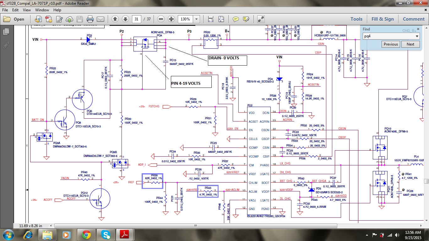

    hello i have a problem with acer aspire one 722.
    The gate of the p-channel mosfet is high and no voltage measured on drain.
    but the mosfet is good.. please help
    i attached the schem for other info ..

    You have a short after mosfet that is why you have low vontage on pin 4.
    Your gate is 19v, and to open should be ~25-28v.
    Check with a laborator power supply, give like 1-2v and see how many amps "eating"

        isl6251 pin2 voltage is?
          0.7 volts sir

            Check pr24 and pr28 resistances. If they are ok - PU2 might be the cause.
