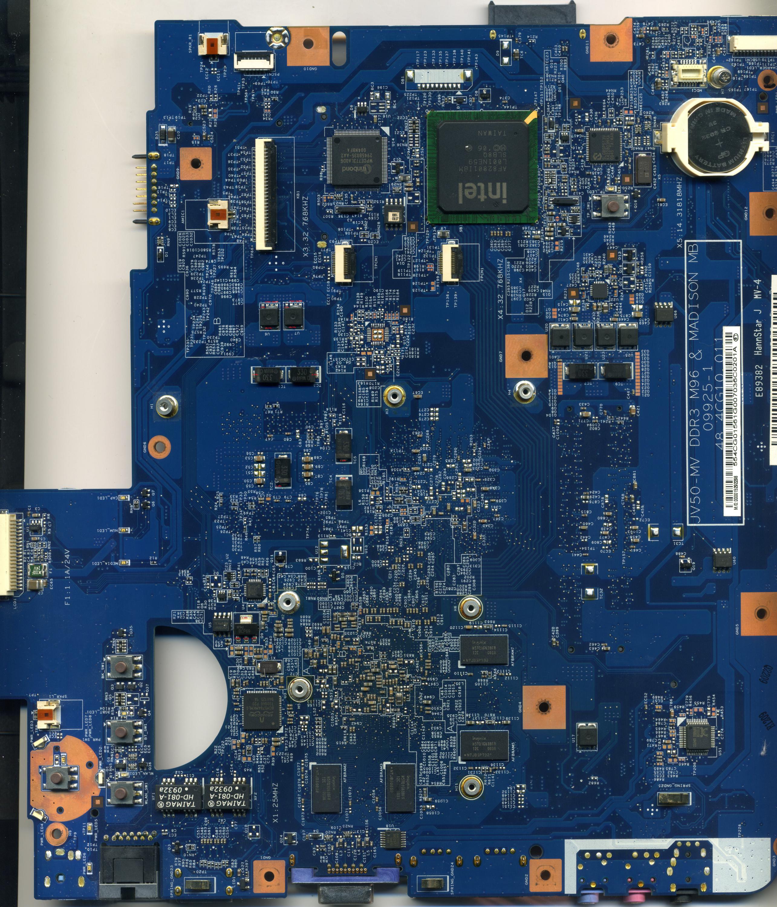

                        • age80
                          • Jun 2013
                          • 55
                          • Greece
                          Re: Acer Aspire 5738G continuously restarting
                          Is this your board?
                          https://www.dropbox.com/s/alnnbzj66t...50-MV.rar?dl=0
                          • sopik78
                            • Nov 2013
                            • 519
                            • Czech Republic
                            yes, that's exactly the same board
                              same board! only nvidia chip.
                              let`s start this.
                              1st coils! the pic with cpu and gpu
                              voltages on them. i`ll take the voltages and write them here.

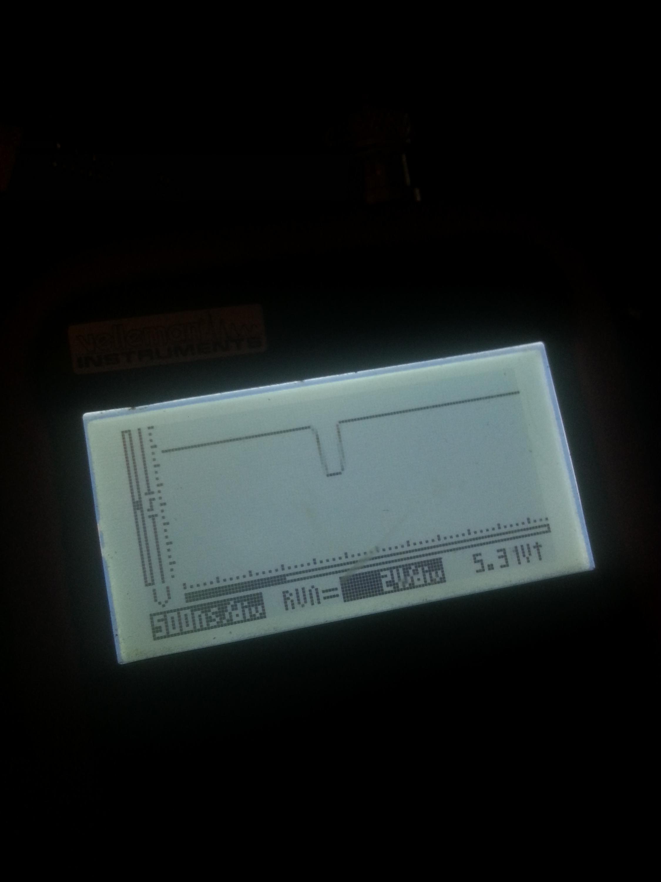

                              • dj_ricoh
                                • Jan 2013
                                • 2073
                                • uk
                                its not 100% the same
                                L19 its a bit out of place!
                                L19=24-19v --> 1.33v
                                u41= pin1,2,3 -->19-23v; pin 4 25-26v ; pin 5,6,7,8 19.41v
                                u40= pin1,2,3 -->7-20mV; pin 4 5.31v(see pic)
                                L26 = 19-24v -->1.6v
                                L25 = 19-24v -->1.16v
                                U39,U35 like U41
                                U38,U36 like U40
                                • dj_ricoh
                                  • Jan 2013
                                  • 2073
                                  • uk
                                  your board its brown under the GPU!
                                  did you consider you got a problem there? even burn layer in PCB or bad chip?
                                  • dj_ricoh
                                    • Jan 2013
                                    • 2073
                                    • uk
                                    did some measurements.
                                    i`ll do more !
                                    it will be nice to KBC
