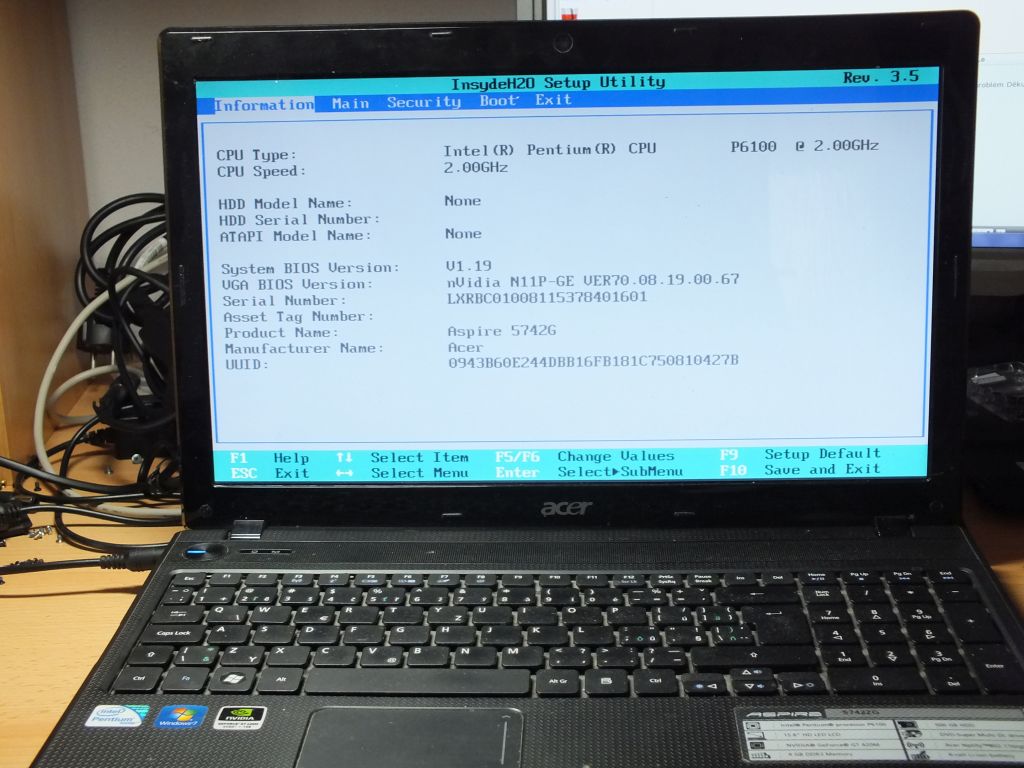

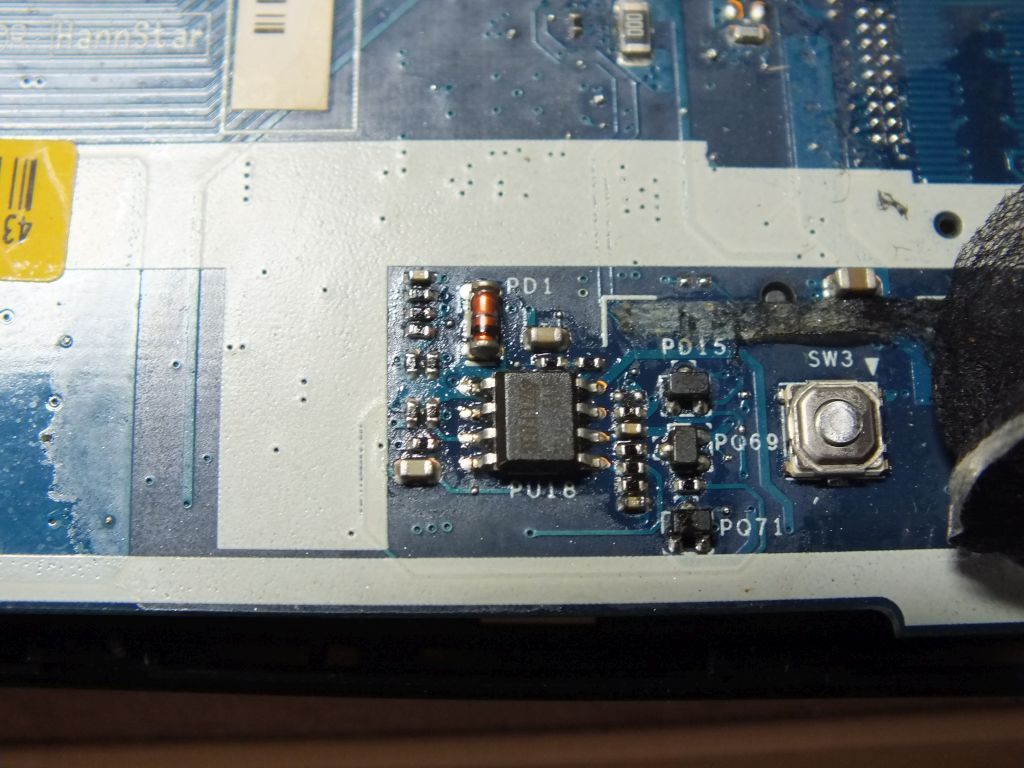

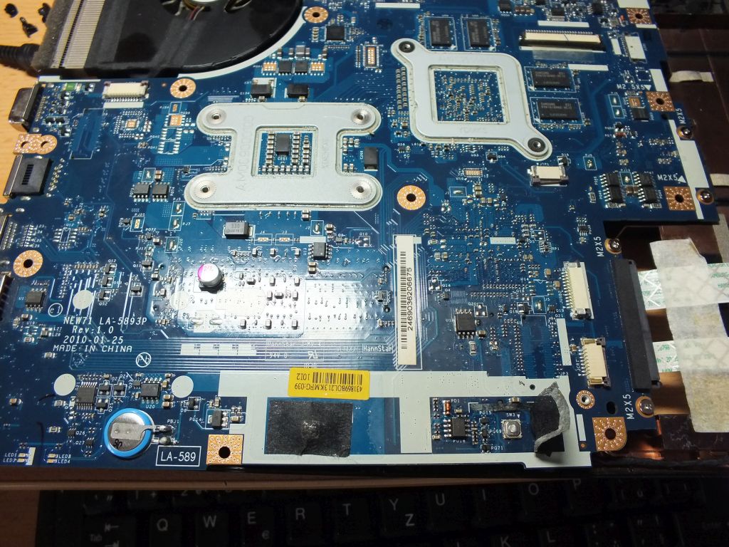

    A customer send me Acer Aspire 5742G with Intel Pentium P6100, 4GB DDR3 and GeForce GT420M. Problem - not powering on, not charging. I found no 3VALW and 5VALW as well. First I tried flash BIOS and EC which I had from before. No change. After some hours of searching I found problem on power comparator PU18 LM393 and some oxidated parts near this IC. After changing PU18 and reflowing oxidated parts laptop works again
    Could help to somebody..
