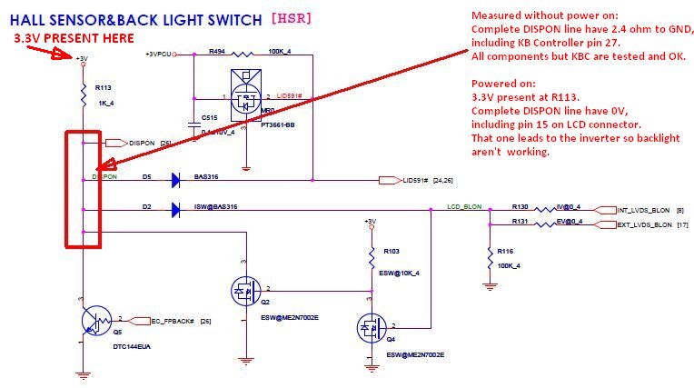

            I did some additional measurement and find that complete DISPON line
            are grounded as is visible on picture. Probably due to previosly bad damaged flat cable. Any sugestions?
            It's so hard to find components scattered all around this huge mobo!
            And anyone have board view for DATZ1CMB8F0 Quanta TZ1C rev:F motherboard?

                Tried everthing that I can, without proper schematics and limited experience. At last I disconnected pin 27 of EC (Winbond WPCE775CA0DG) from board. and found that pin 27 (DISPLON) has only 1.1 ohm to the GND. Pad undernaeth pin has 11k ohm! That EC can't be good, or I'm wrong? And where is lid switch located?

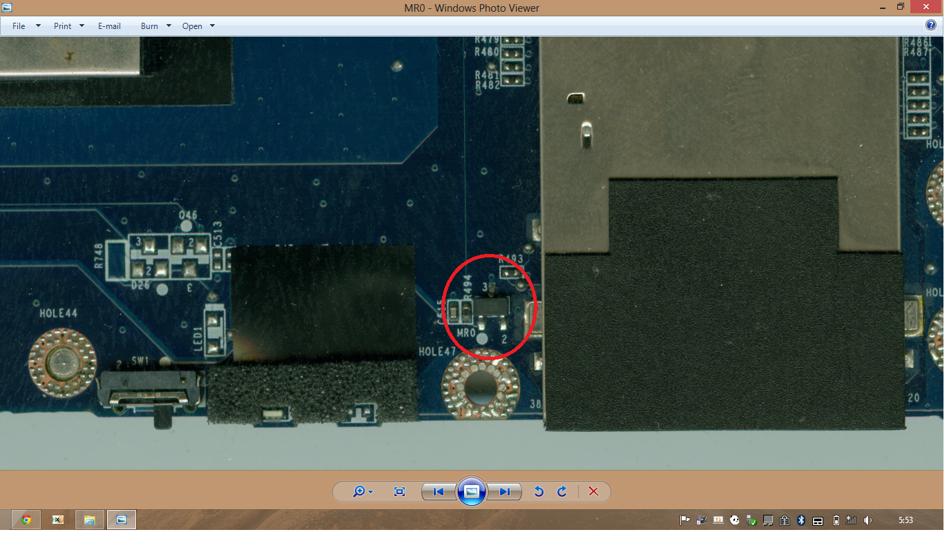

                  check voltage MR0
                  I thought its could work cause react with a small magnetic on LCD/LED frame
