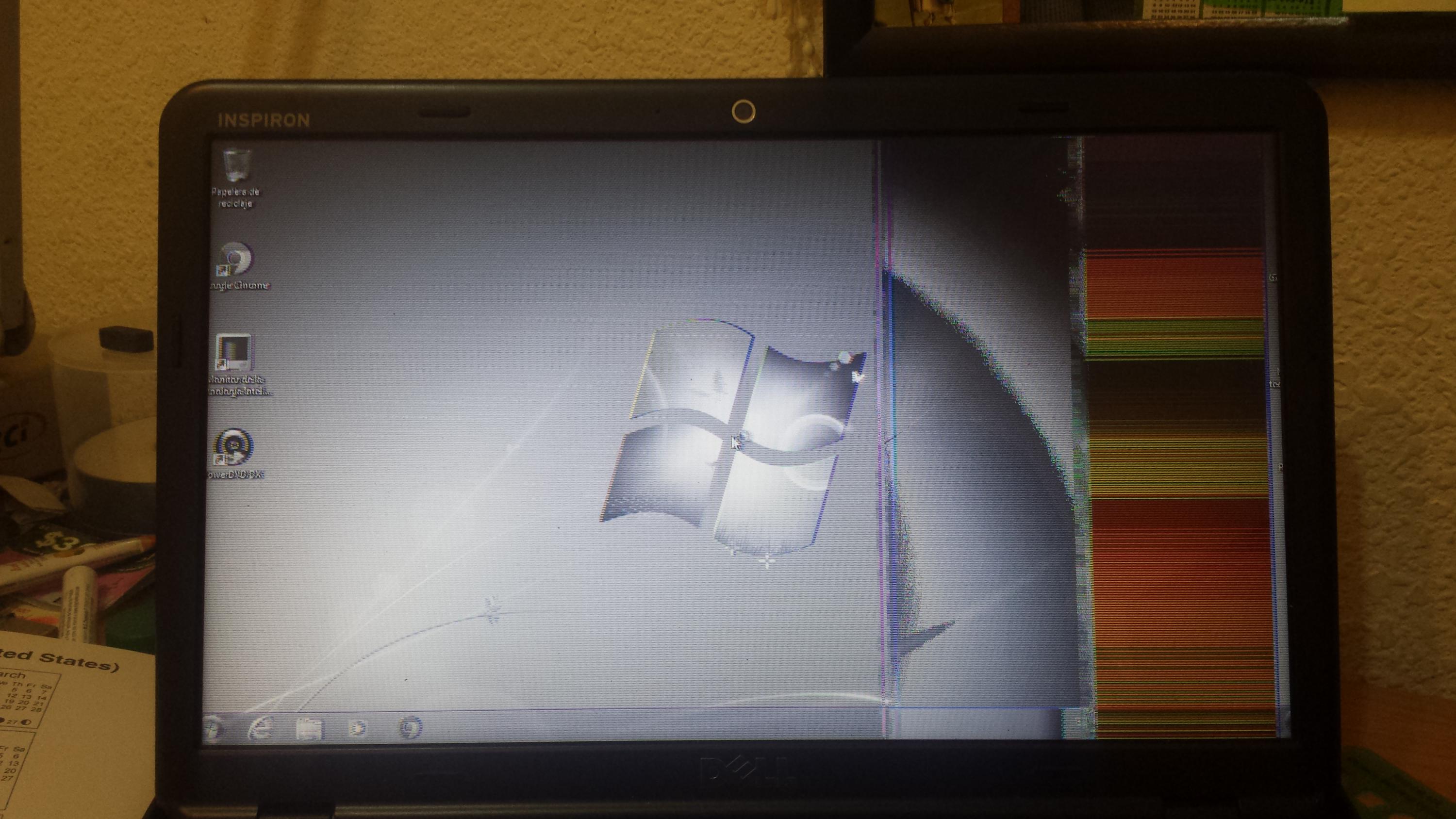

    Hey Fellas.
    I need you opinion on this laptop.
    Recently I replace the battery of this laptop and everytime as soon turn on the screen start acting weird.
    This only happen when is used with the battery.
    When I turn on the laptop plugged, everything is normal. no problems.
    The battery charge good and my video driver is updated.
    Any comments!!

    Do you have another battery to check that the problem is with the battery or something else

      Re: Dell Inspiron 14z-n411z Video Flickering
      I check with the old battery and is doing the same
        Looks like an LCD fault to me
          same here... LCD panel issue
            LVDS cable will drive the entire panel as a whole... So as its broken up like that I would 100% say the panel is screwed
              Today I testing using hdmi cable connect to external monitor and everything is fine even just with the battery connected.
              Really weird.
