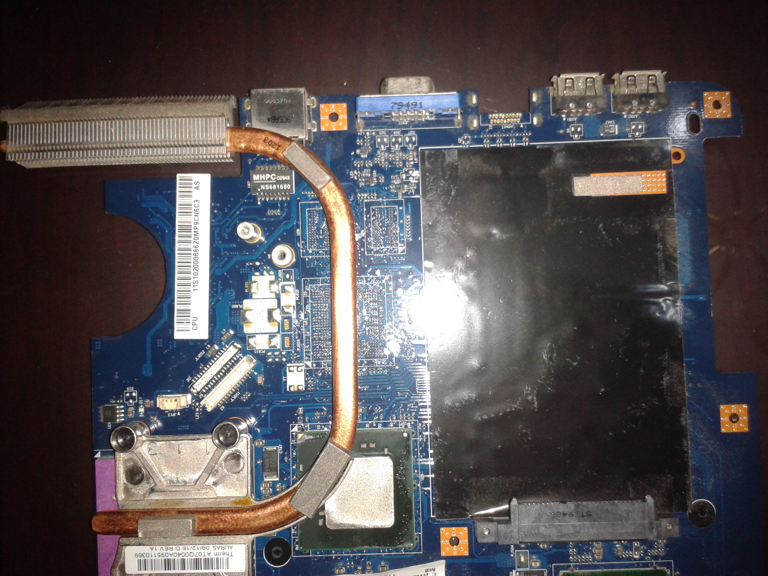

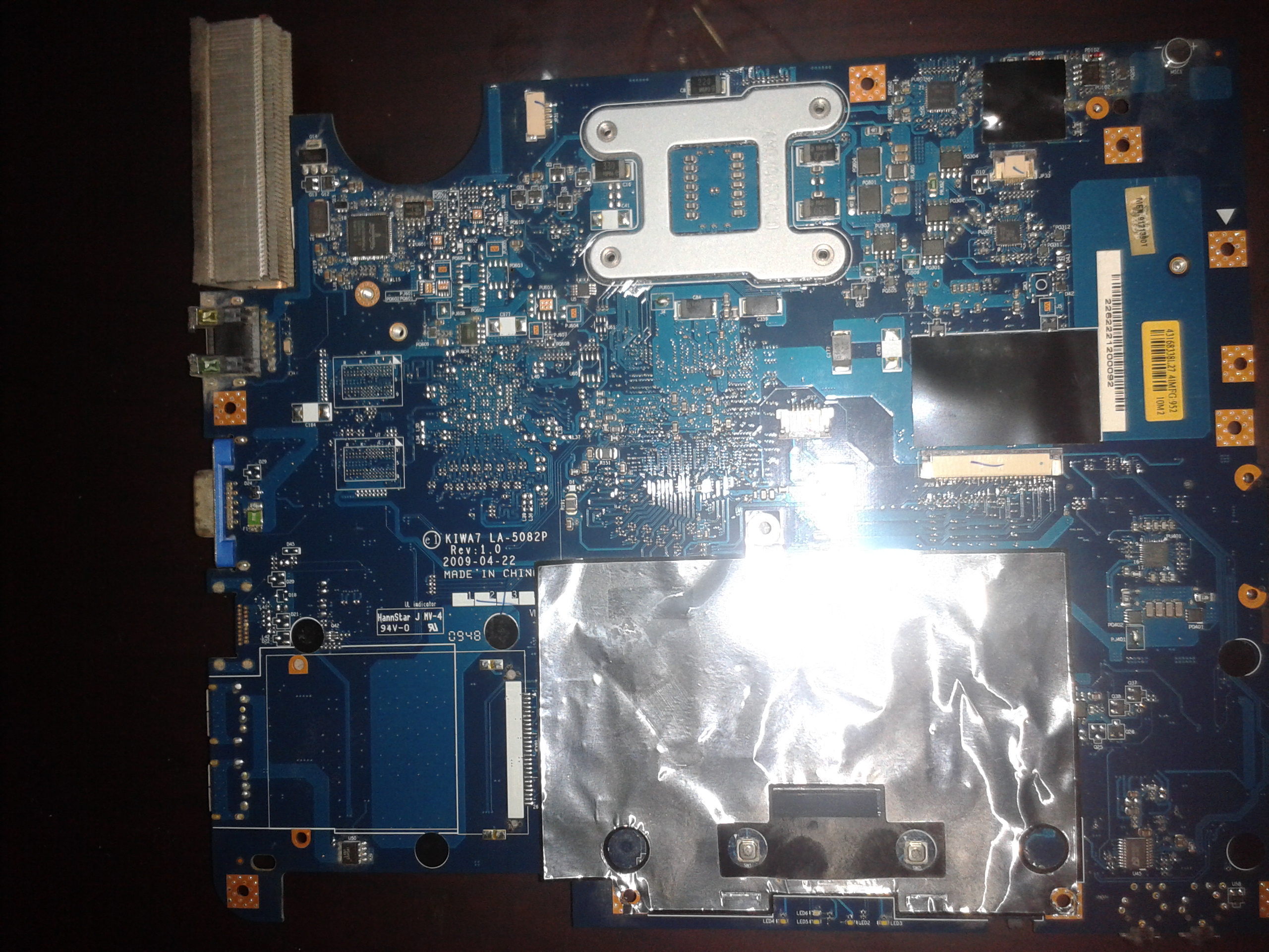

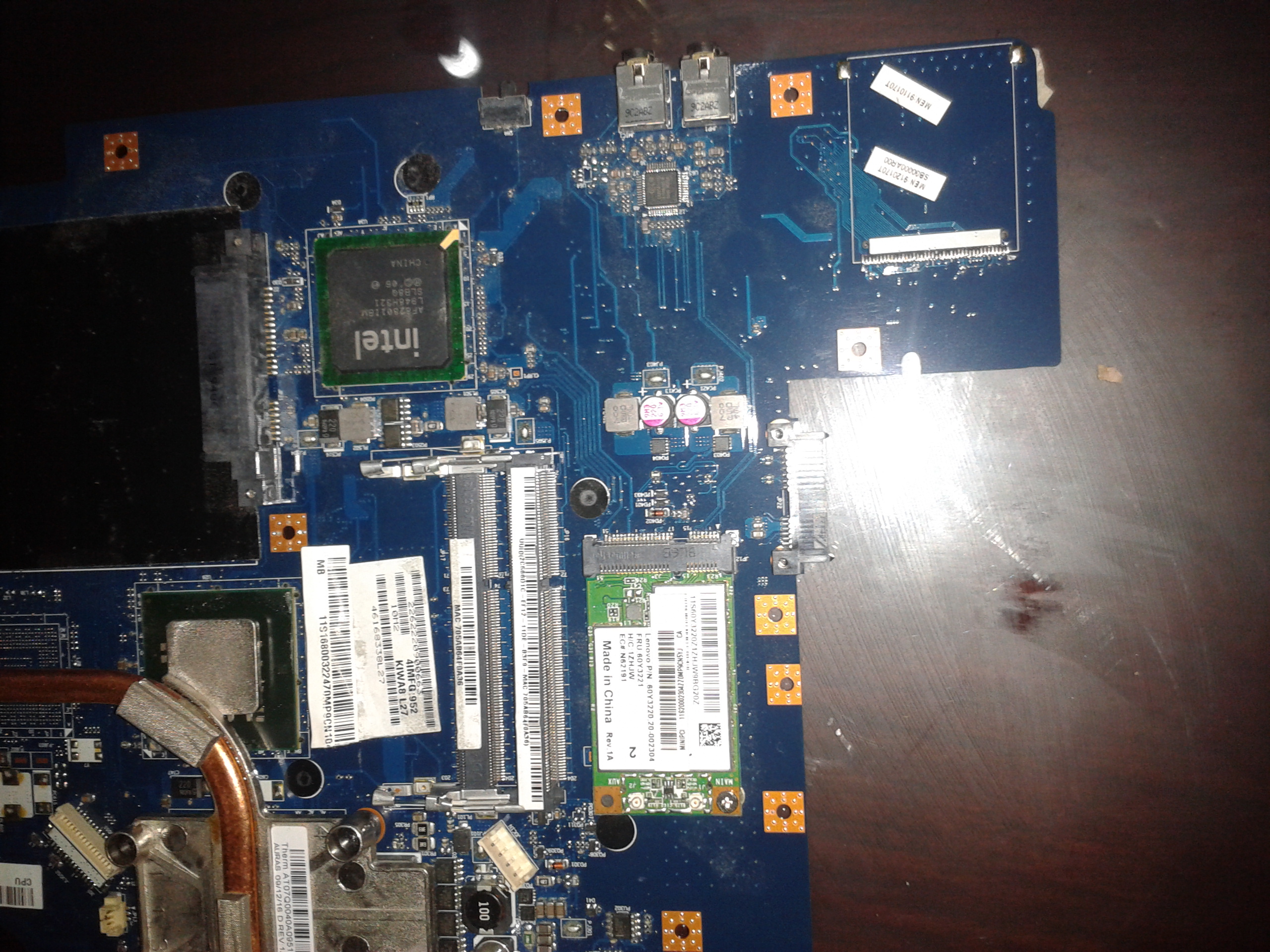

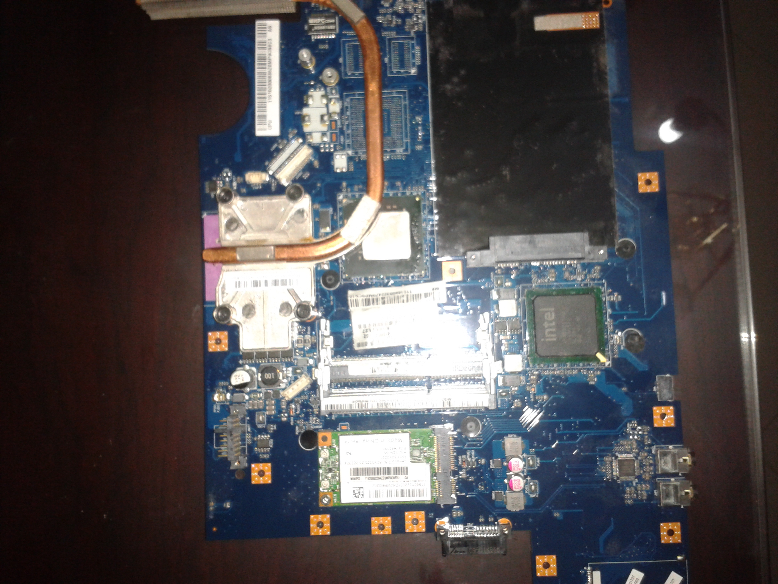

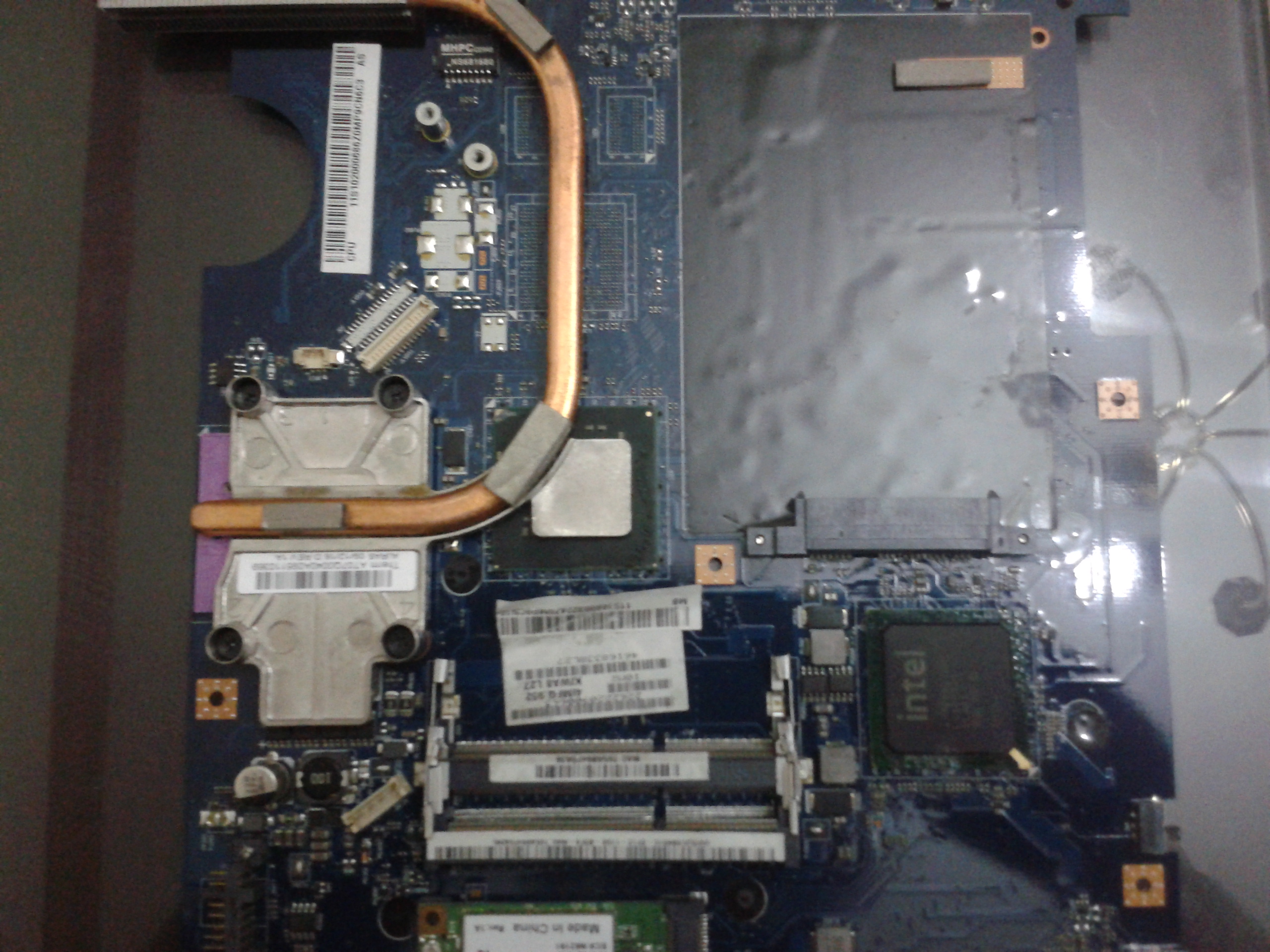

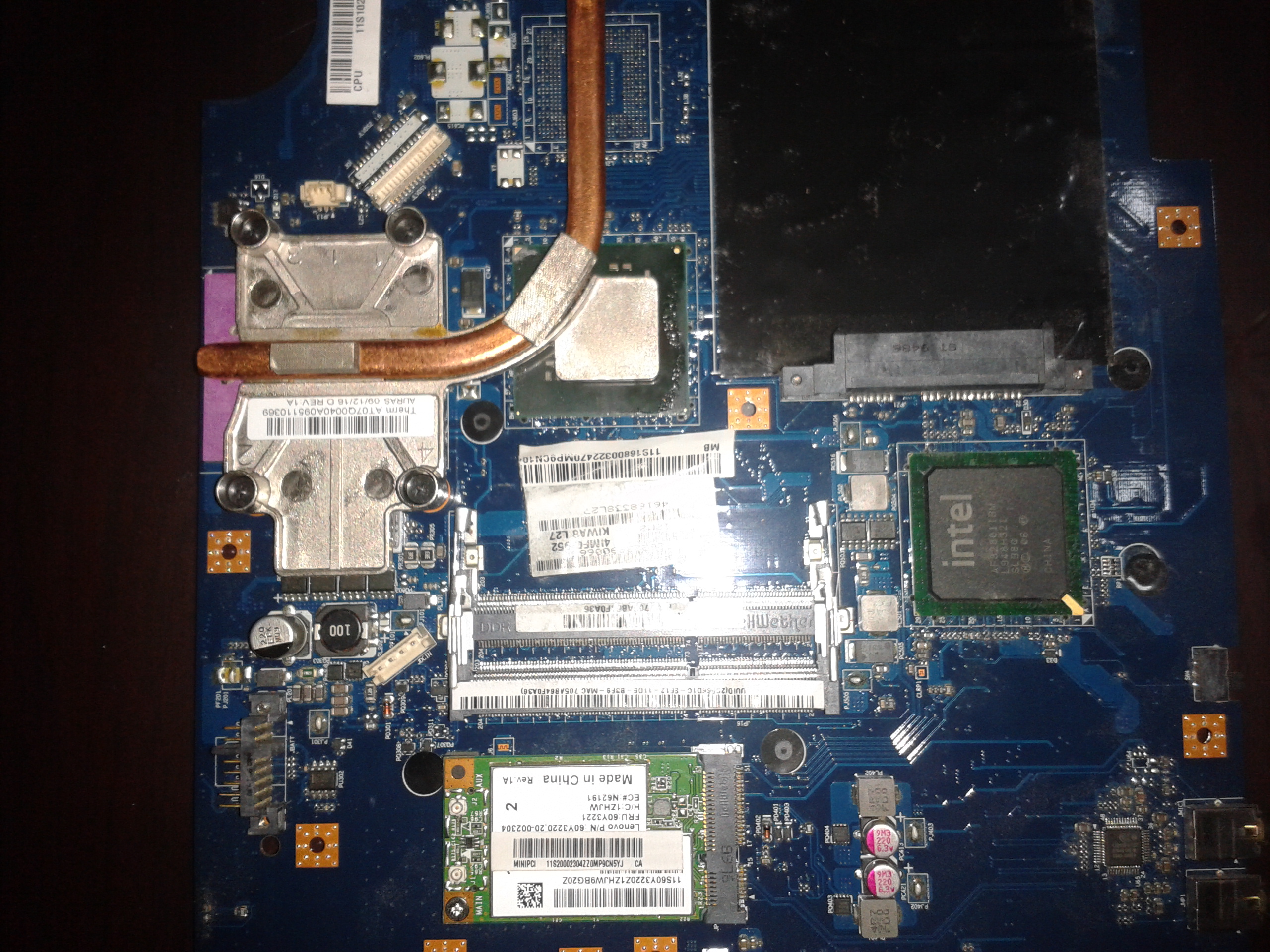

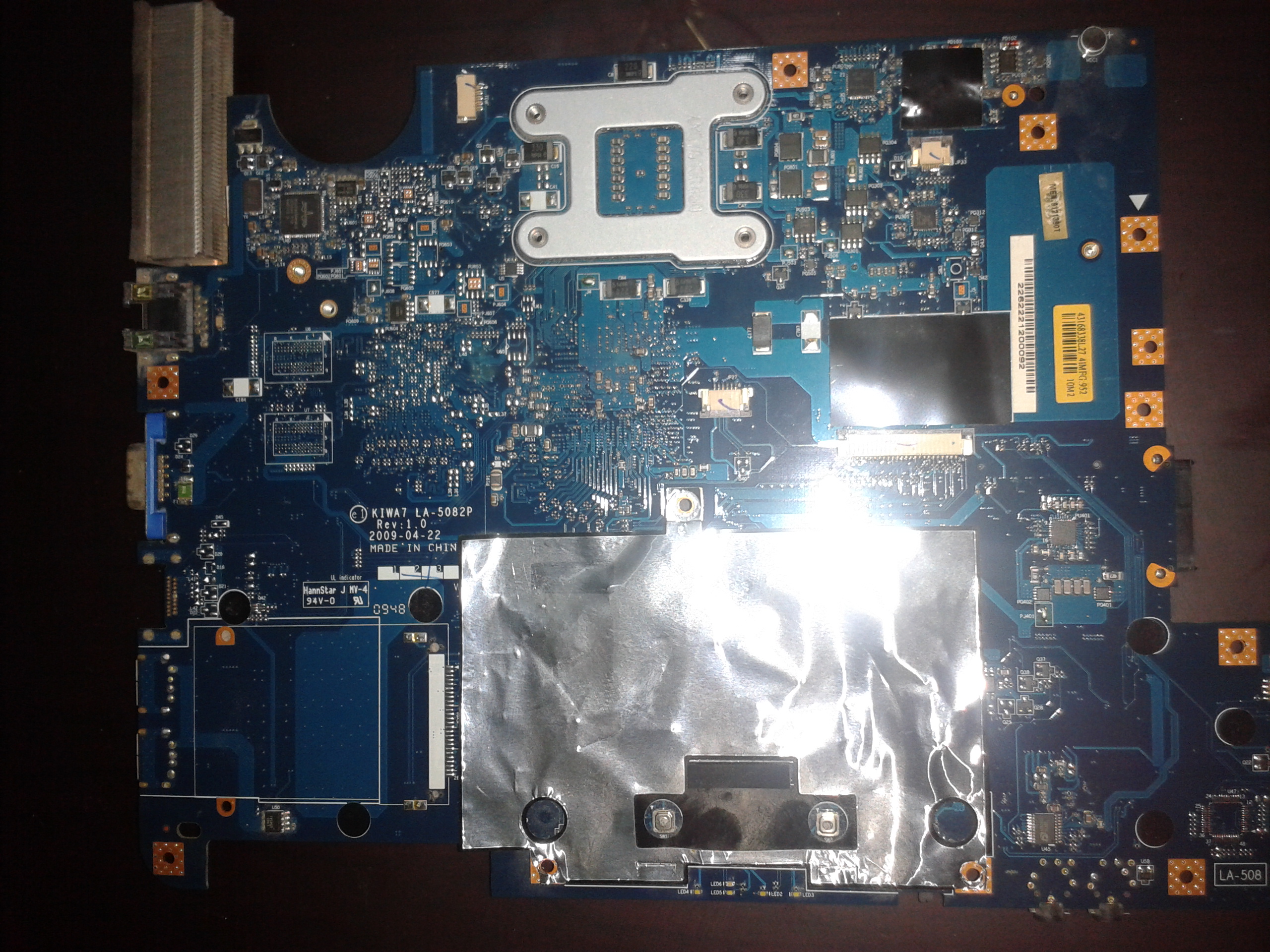

Hi, I have a lenovo g550 model 20023 when I press the power button ,only the power led and the WiFi led are on . and the fan worked then stopped. Thanks in advance
lenovo g550 with no screen display

made some tests and i found the following
1-i found some shorts on the processor pins when i take random points
2-Q802,PQ803,PQ805,PQ806: no voltages
3-PQ801,PQ804
when removing processor :
pin 1->4 : 1.48 v
pin 5->8 : 18.7 v
when attaching processor
pin 1->4 : 0 v
pin 5->8 : 18.7 v
4-PU801
pin 26 : 5.18 v
pin 36 : 5.18v
pin 37 : 1.72v
pin 39 : 1.25v
pin 31 : .16v
pin 2 : 1.72v
5-capacitors in the processor base :1.48v - when removing processor
please i need your illumination , thanks in advanceLast edited by georgealbertwadie; 04-20-2015, 11:12 PM.Comment
