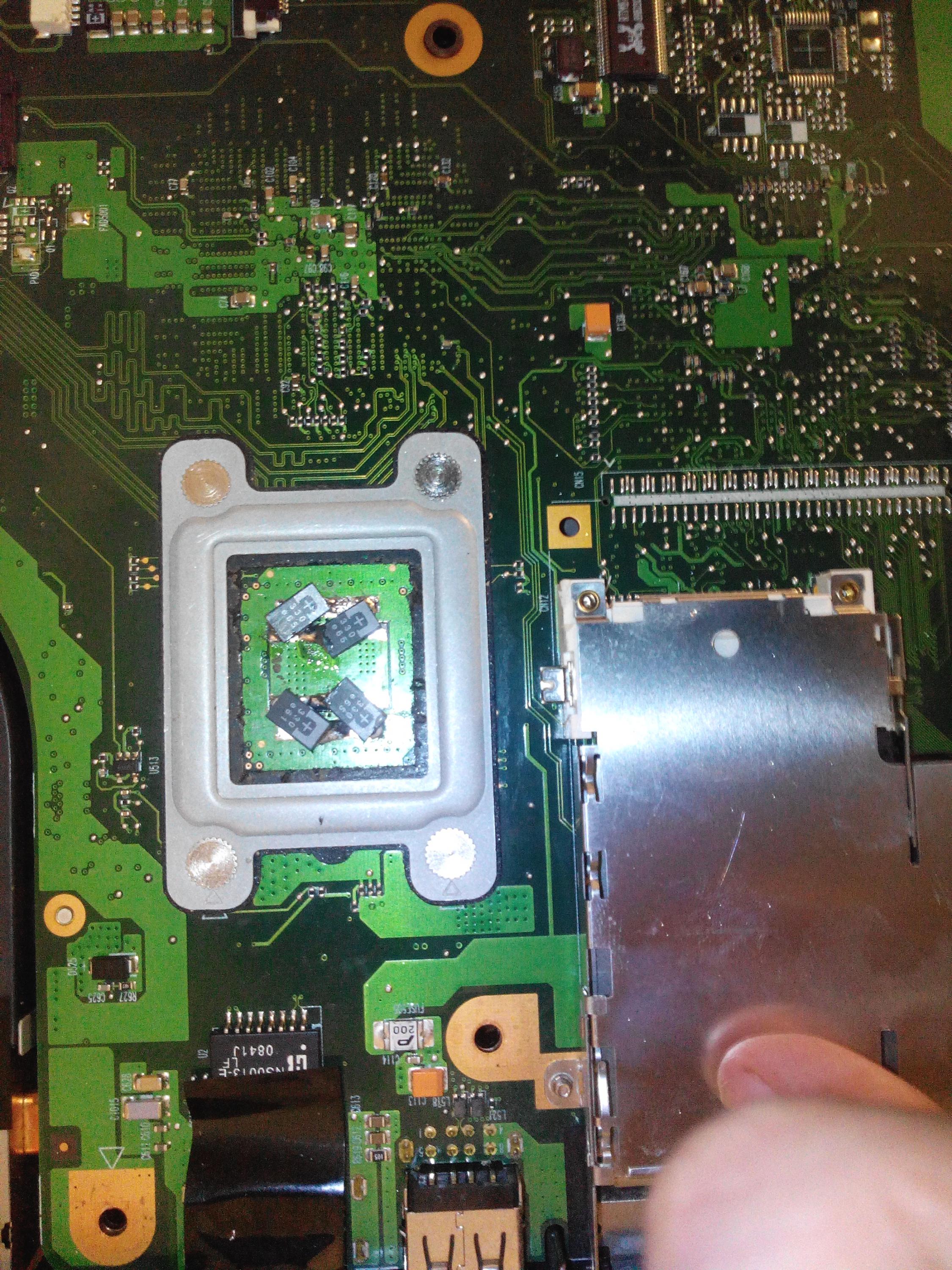

    Hello... First I want to apologize for my english (i´m using google translator)
    Then, I have a Toshiba Satellite pro L350 with the NEC Tokin broken.
    After searching the NET I found out that I can replace it with some ceramic capacitors but, every site says a different capacity...
    what exactly are the values for it ? I have 6 new 337uf, do I use them all or what?

    The ESR is important. What is their part number? Where did they come from?
    The most information is on this thread, https://www.badcaps.net/forum/showthread.php?t=8991

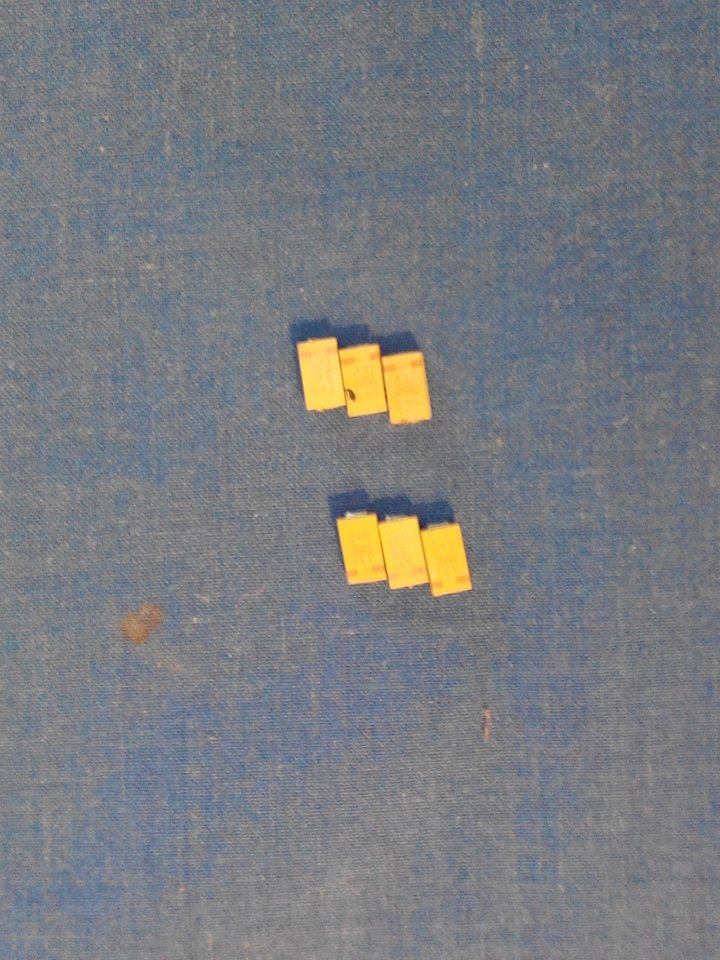

      you can used only 4pcs. 4 x 337uf (330u). but voltage 2.5V
      post the result please..

          So let me see if I get it...
          I must get 4 330uf 2.5v or 2 660uf 2.5v right ?
          I want to get the right values

            values not important. u just need to reach 1000uf an have low esr

              You don't necessarily have to buy new, you can buy a broken laptop motherboard for dirt cheap and scavenge it for parts. All boards have at least six 330uF tantalum capacitors suitable for use in this modification and many other parts.

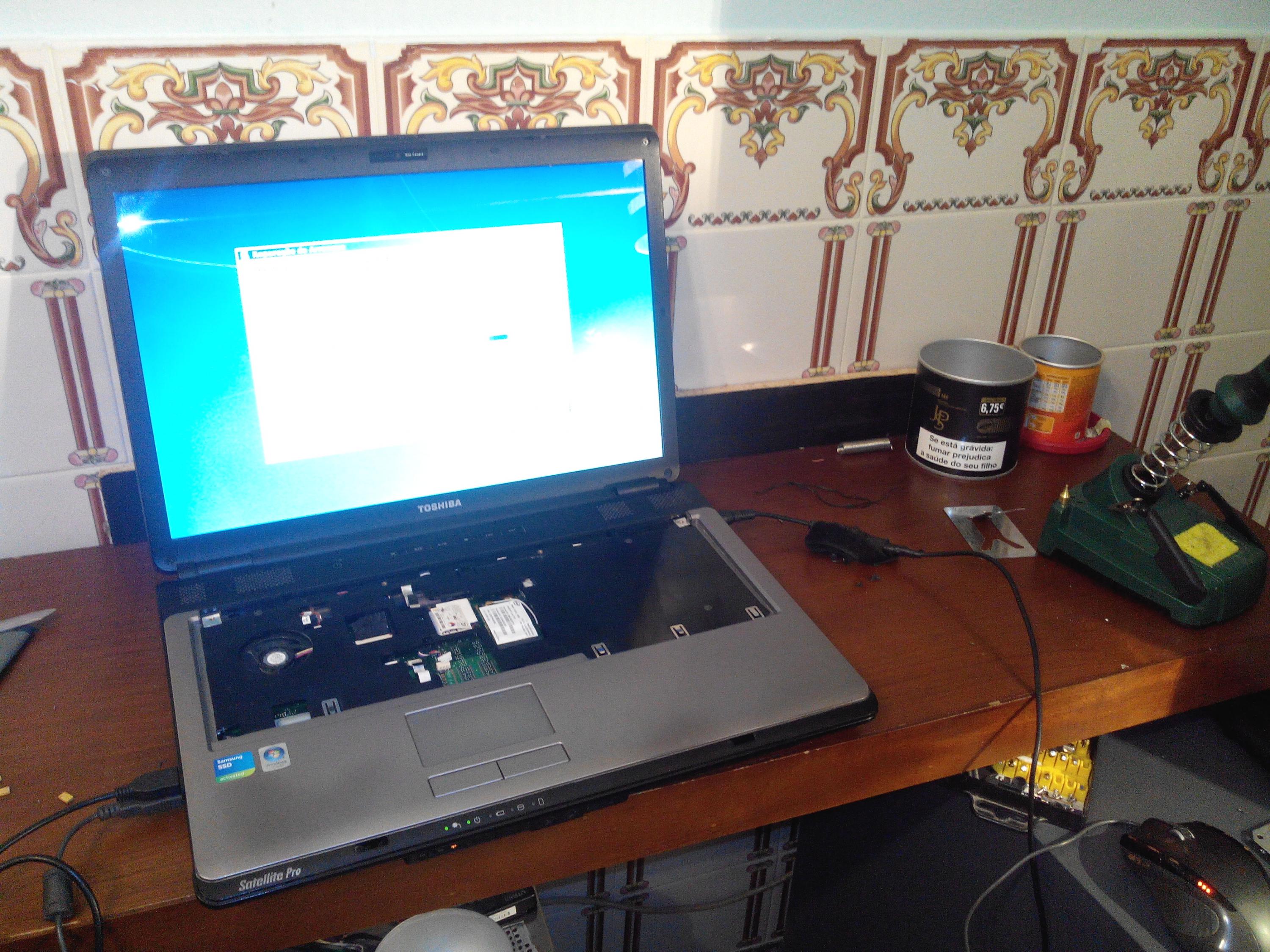

                It´s aliiiiive !
                Thank you so much guys !
                My Satellite Pro is working again
