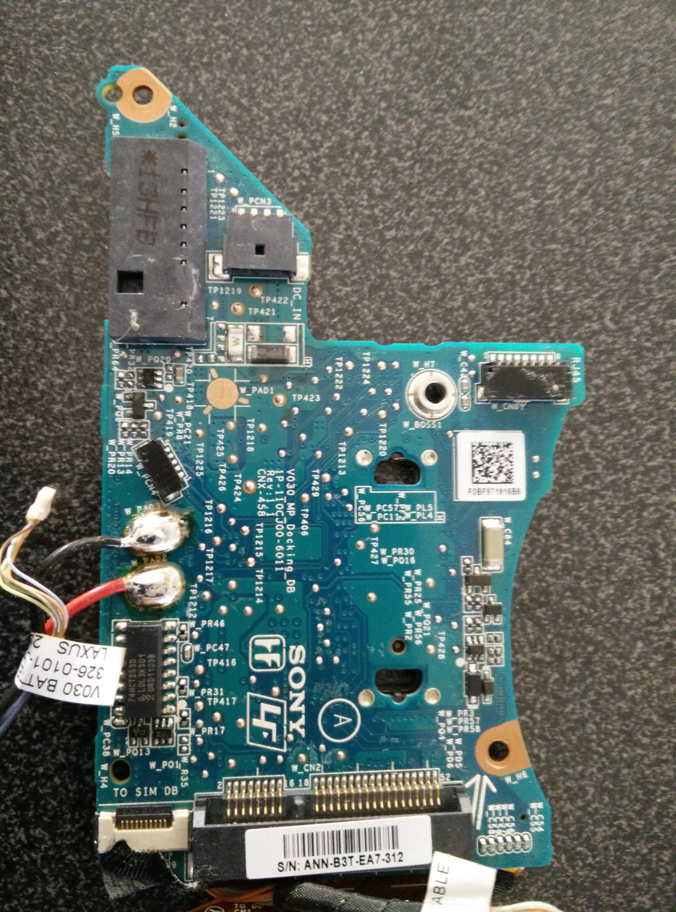

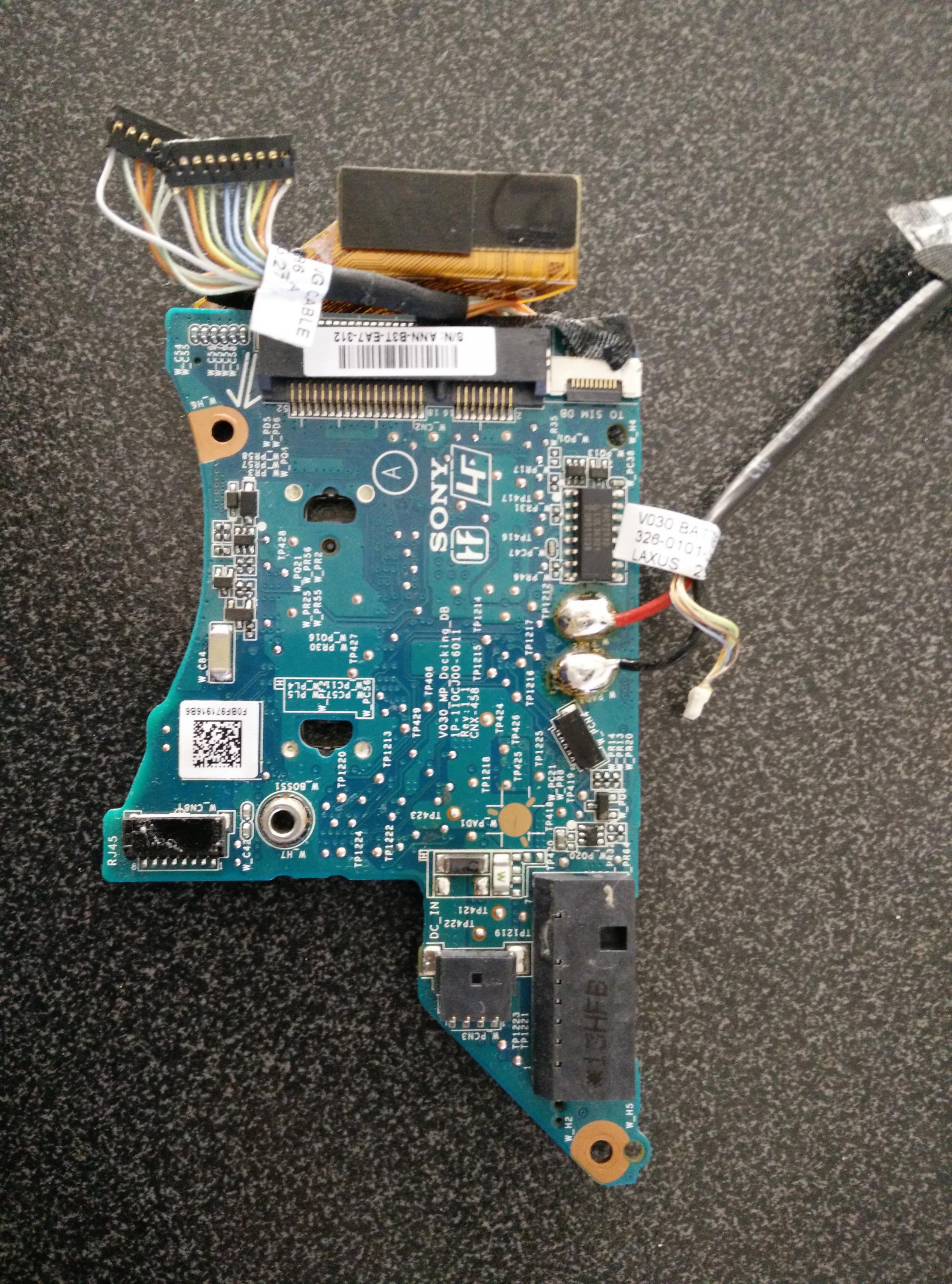

    Hi , this laptop have no light no sign of life .
    when i plug it i can heard a little "tic" on the power board (cnx 458) , i thinks it's a short.
    Can you help me to find the short please.

    Have you checked for any open fuse on this board? Also on mainboard there are some fuses too. That tic sound might be normal. Do you have voltage on the black connectors (with the cables)? Also problem might be on the mainboard..

        I have the same Problem with MBX-216, only the Power LED lights for 1 sek.
        Do you have a solution?
        KBC maybe? short on Power IC?

            i think the BQ24725 is for battery charge ..., the SN66... is for power 3/5v!!

                So i have change motherboard.

                    Re: Vaio VPCSB1S1E (MBX 237/CNX 458) /no signal
                    i have changed cnx458 too.

                      Dear Subuncle
                      but you had tray to change capacitor?
                      This you writed in another forum:
                      (Hi ,
                      problem is solved , i have solution on english forum.
                      The mbx 237 motherboards have problems capacitors short circuits (see photo in red) .
                      I replaced the three capacitors and laptop go on.
                      Manythanks for your help)

                              I tried to change the 3 ceramic capacitors (10uF/25V) - temporally substituted with an 33uF/25V electrolytic cap - and my laptop now works!!! Many thanks for your precious informations!!!
                              One of the ceramic capacitors like in the picture, was in short circuit (laptop completely dead).
