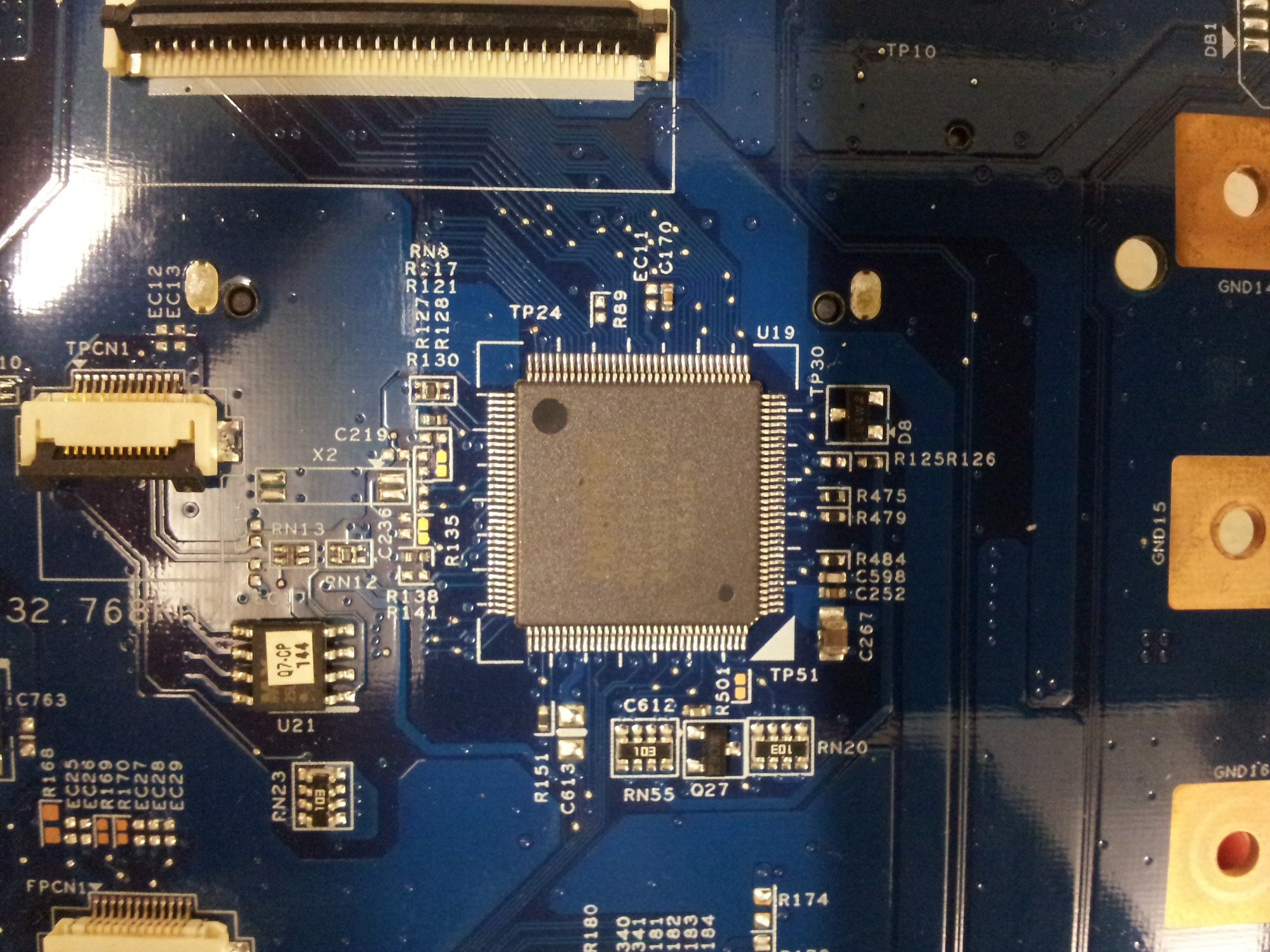

    Hi all, I've got a clients Acer Aspire 7740 Laptop that wont boot, black screen, fan not spinning, nothing.
    2 months ago I replaced his hard drive, re-installed Win 7 and supplied a new Delta charger. All was good.
    At first I thought 'duff charger' but no, it tests fine 19.23v and works on another Acer.
    Ok, duff HDD, no tests fine.
    Must be the DC jack, no tests fine, I'm getting power to the battery connections, 3.33v on 3 pins.
    Replaced RAM, removed WLAN and so on.
    I've given the mobo a good eyeball inspection, it looks perfect.
    And I'm now stuck, I've got the schematic but I'm pretty clueless at this stuff. I have replaced loads of DC jacks, USB ports and audio jacks but thats about my limit.
    So, can any of you good guys be of assistance? If I can't get it going I will refund the guy for the charger & HDD, but I'd rather fix it for him.

          what voltages are You getting on U19A (SIO)-pin 99 before & after pressing power button?

                loser18: Showing my numptiness now, cannot find U19a on the mb, here is a pic of U19, don't know 1 pin from another any help appreciated.

                    Here is pin 1
                    Also you can always download the data sheet on the chips good place to start.

                      Thanks cyberhack, so counting anti-clockwise pin 99 should be 3rd from left, bottom row.
                      If I am correct I'm getting 0v.
                      Dave
                      • loser18
                        • Nov 2013
                        • 274
                        Re: Aspire 7740
                        I'm terribly sorry...
                        Told You to check wrong PIN...
                        Right is PIN95 (check voltage before & after pressing PWR button)
                        Also check voltages of PIN102, 19, 46, 76, 88, 115 & 104 (all of these should have 3V before pressing anything)...
                        Next thing I would check is U82:
                        PIN16
                        PIN8
                        PIN17
                        & then voltages of all big coils after pressing PWR button...

                                      Hi, OK got some testing done this morning, results as follows:
                                      U19
                                      Pins 19, 46, 76, 88, 104, 115 all 3.3v before & after pressing power button
                                      Pin 95 3.3v & 0v
                                      U82
                                      Pin 8 0v & 0V
                                      Pin 16 19v & 19v
                                      Pin 17 0v & 0v
                                      Coils
                                      L13 0.83v & 0.83v
                                      L18, L21, L26, L28, L34 all 0v & 0v
                                      Dave
                                      • loser18
                                        • Nov 2013
                                        • 274
                                        Re: Aspire 7740
                                        Are You sure about pin8 @ U82???
                                        (You can check the voltage also @ R297 or C731)
                                        There must be 3.3V as it powers SIO/KBC and You've said that You got 3.3V on all PINS...
                                        Looks like it's stuck in S5 state...
                                        Could you also post resistance of all coils?
