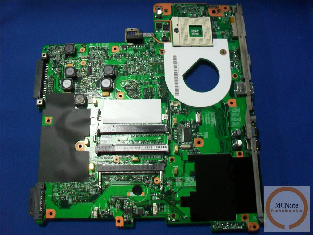

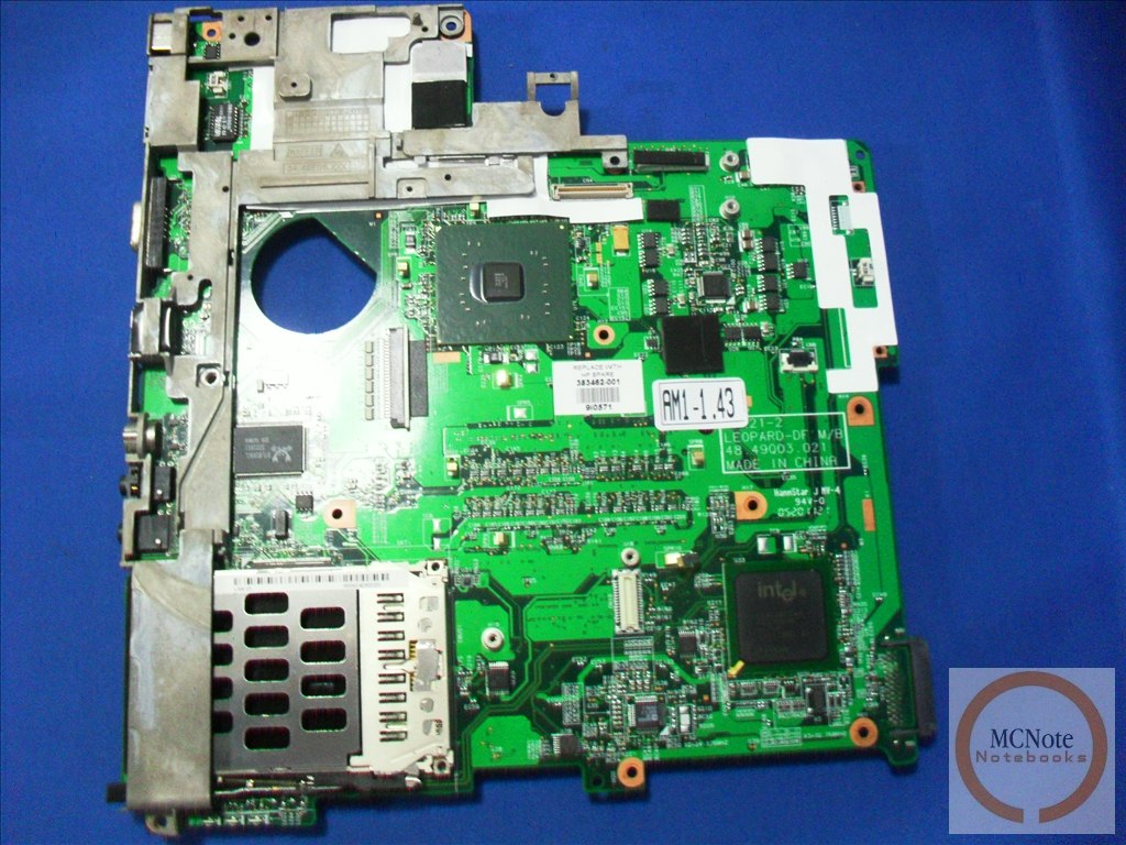

          i know what are you talking about, but this mainboard,
          doesn't seem to use this chip,
          added front & back of the board
          (took them from goole, but it is identical)
          the keyboard connector is left of the northbridge
          • lefos
            • Nov 2013
            • 321
            • Greece
            Re: HP COMPAQ DV4000 No picture
            Can't see it either sorry. Maybe a schematic will be helpful? You will have to trace where the keyboard pins go to that might be the faulty IC
            • ktmmotocross
              Boardkiller
              • Feb 2014
              • 3627
              • slovakia
              as board was in contact with liquid, clean keyboard connector with isoprophyl
