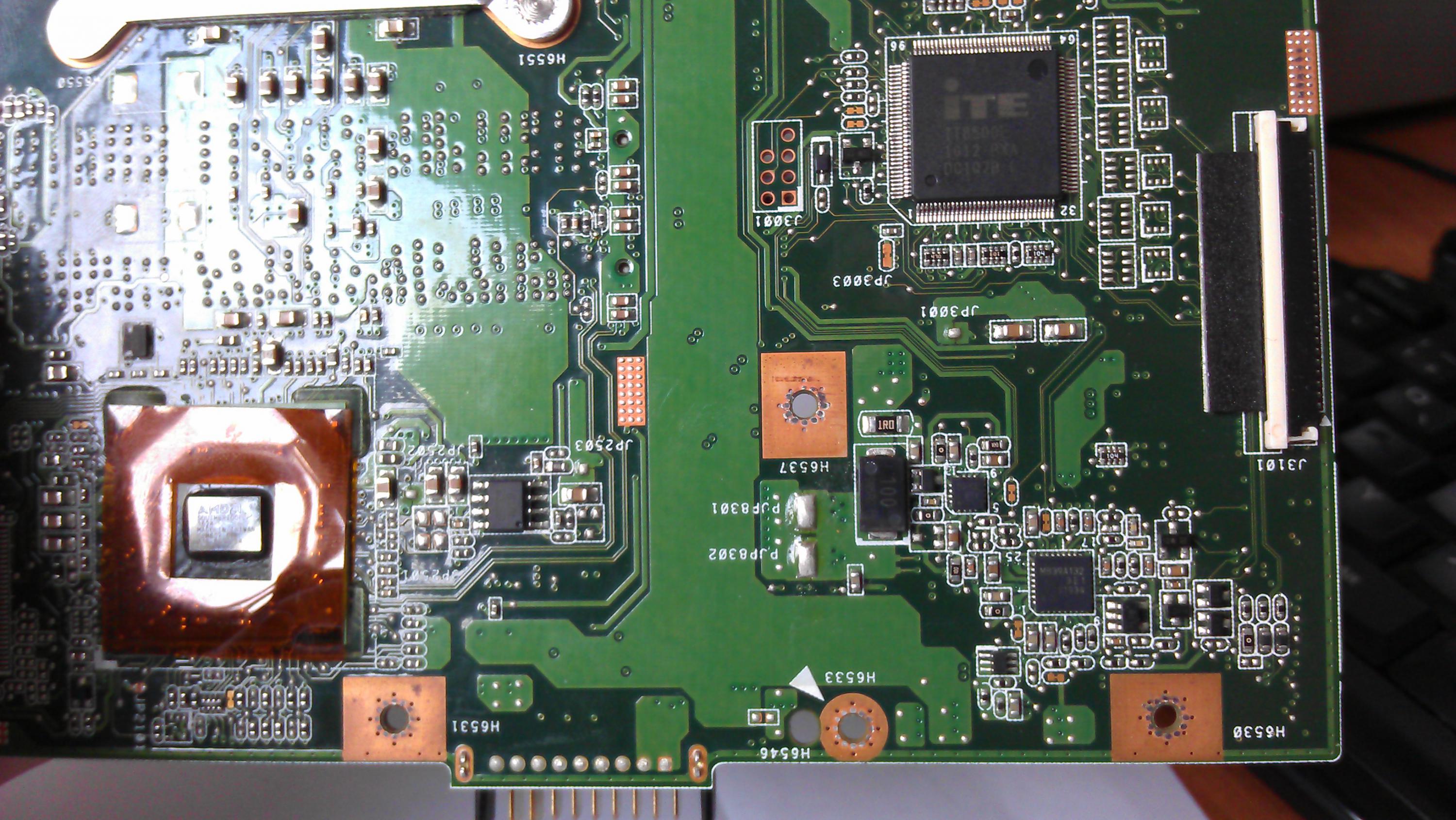

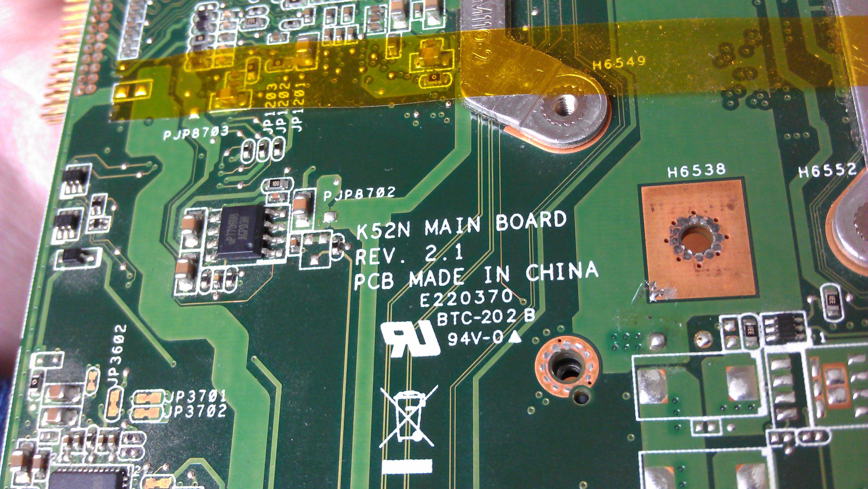

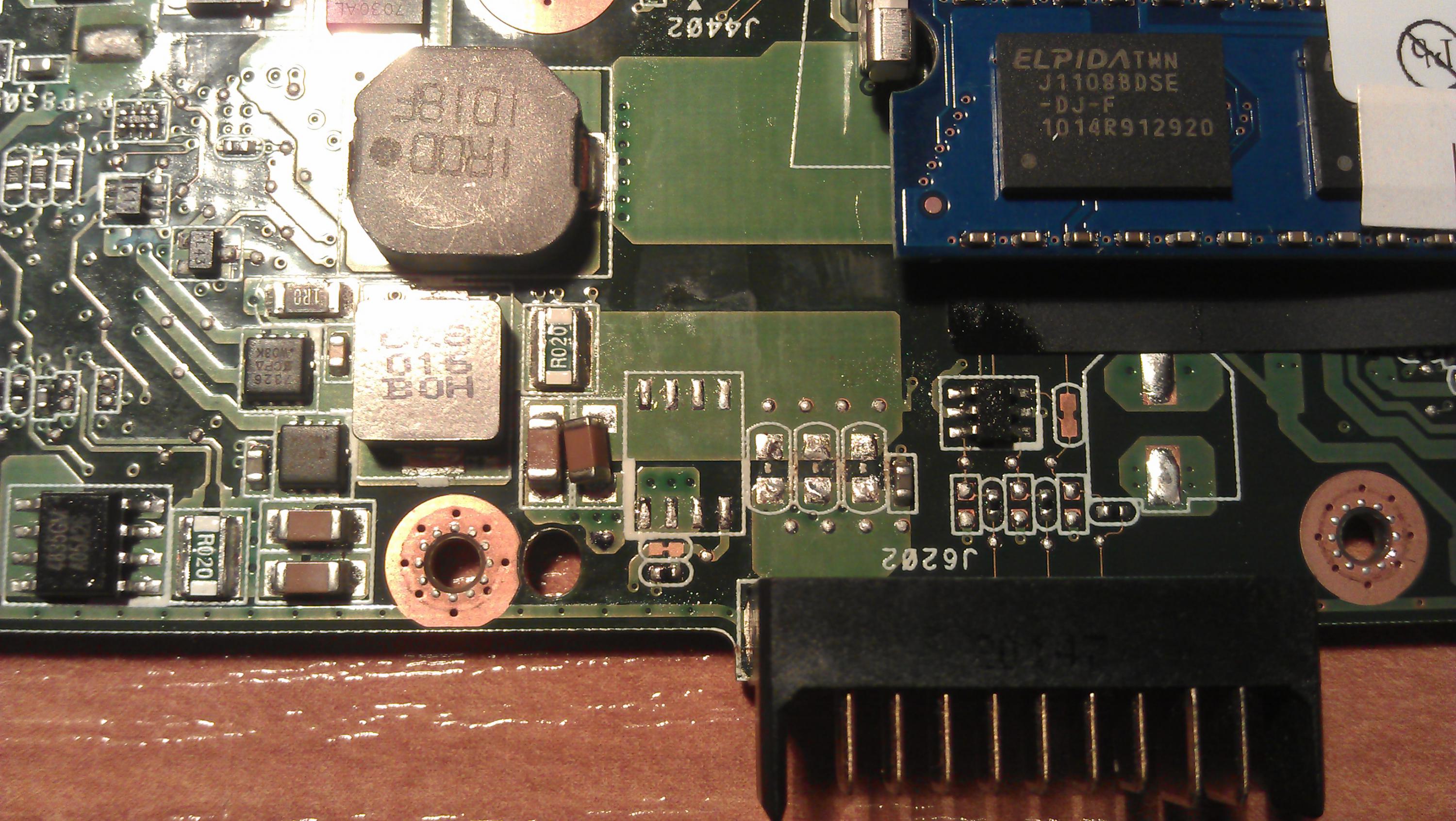

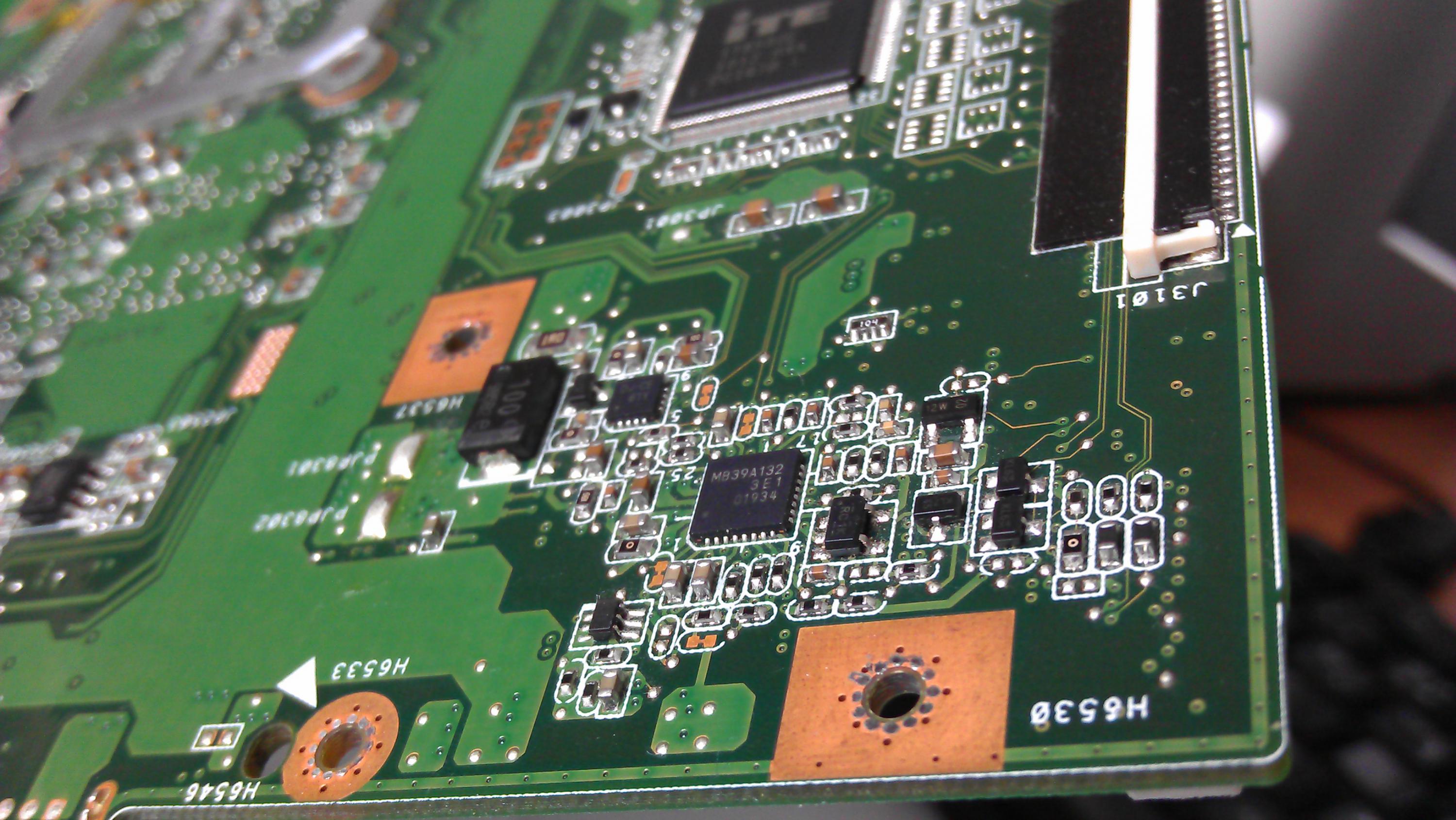

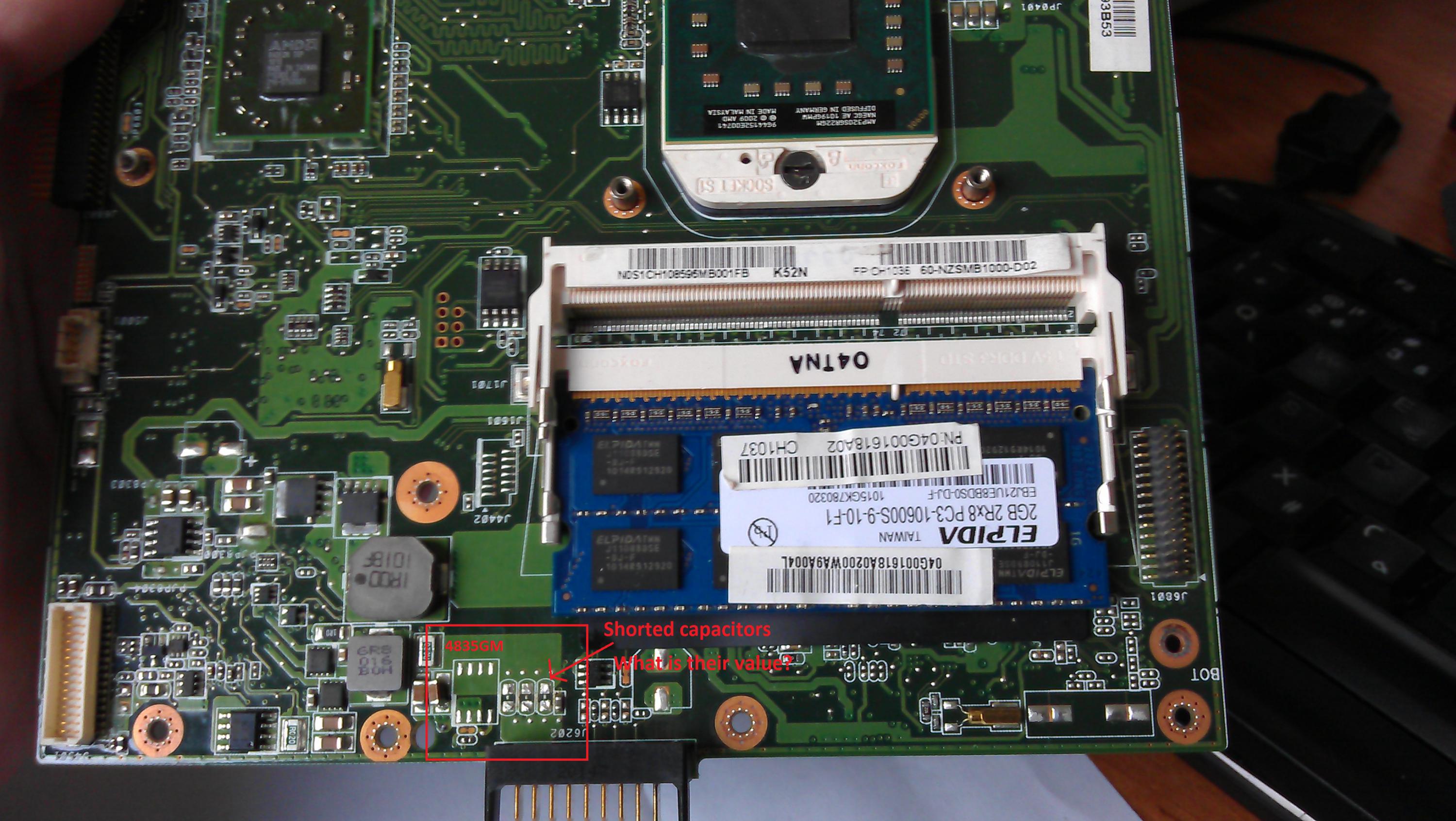

    I have problem with notebook Asus K52N - all works fine, but with battery notebook won't start. Battery is new. I find a short circuit near battery connector. Bad is P-channel mosfet 4835GM and three ceramic capacitor. After desolder these components short circuit disappeared. As a replacement for 4835GM I have 4407A , but I don't know the values of capacitors. All are short circuited. Can you help me?
    Sorry for my bad english and thanks for answer!

      Re: Asus k52n battery problem; value capacitors; schematic
      some photos
