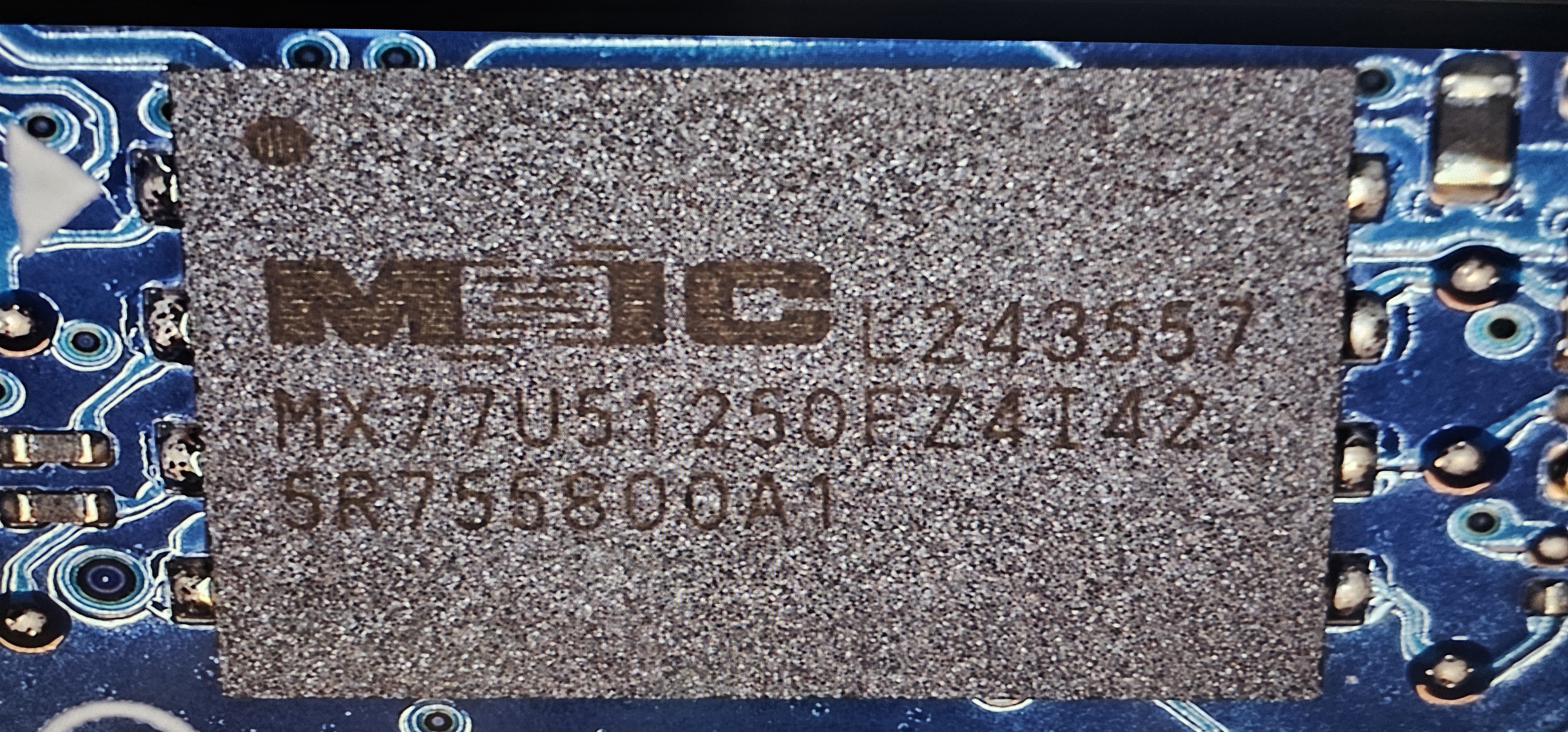

    Hi. I got a Dell laptop with MX77U51250FZ4I42 SPI flash as per photo.
    I am using CH341A with 1.8V adapter to try and read it. I did micro soldered under uscope wires directly to the chip on the board.
    Neither of software (NeoProgrammer, Asprogramer and few other) is recognizing this chip.
    No datasheet available. Emailed Macronix - they said datasheet is "not available for individuals I'm afraid".
    I tried manual settings of size (67,108,864 Bytes) and different Page size (128, 256, 512) but although it does start and finish reading process all I get are zeros?
    According to Macronix website Macronix - MX77U51250FZ4I42 "high throughput of Macronix Serial Flash while taking advantage of the security features such as the permanent sector protection, read protection, etc. " Is that the reason I cannot read it? Are those new chips somehow protected?
    Any help would be much appreciated. Thanks.
