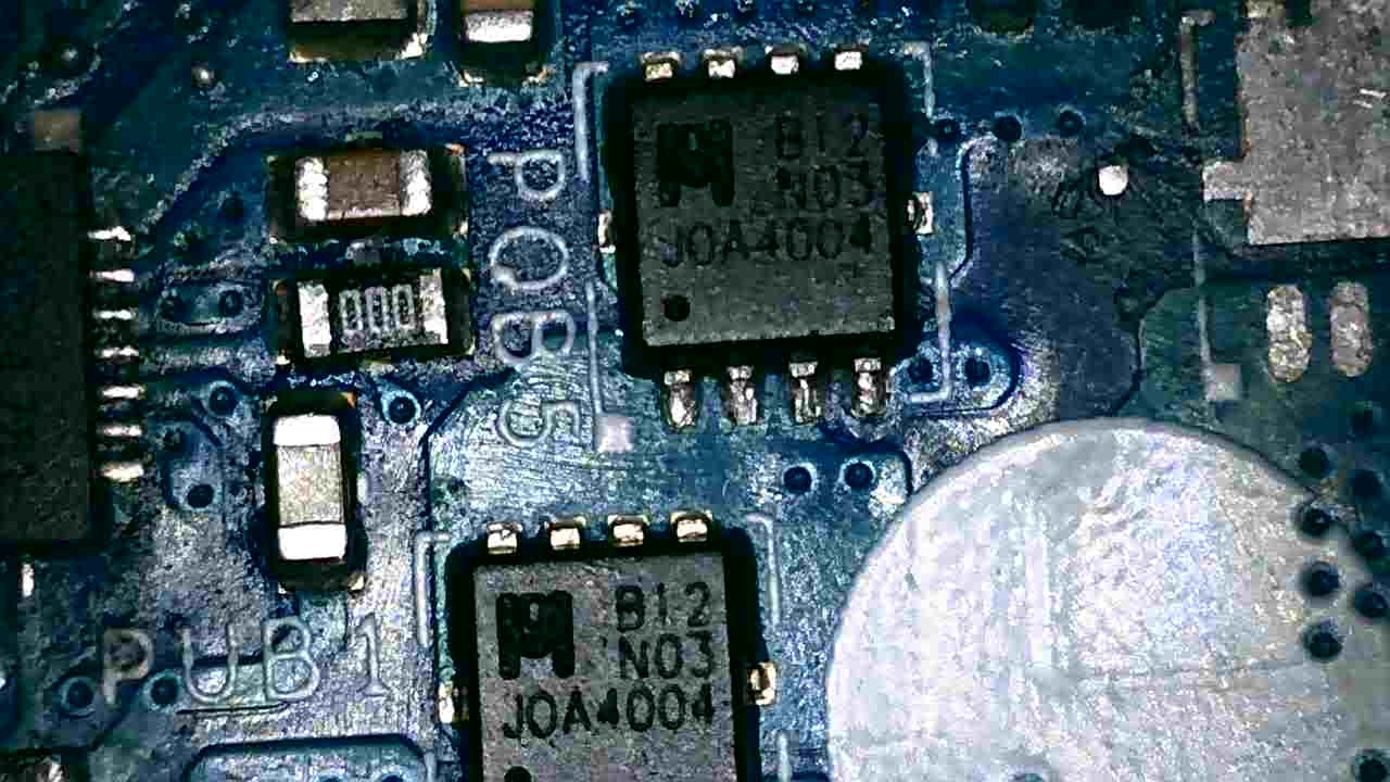

              Okay, thank you very much. I'll get back to you as soon as I've replaced both MOSFETs.
              For PQB2, should I replace it or leave it as is?
              For your information (see photo), do you agree with me, B12 N03?

                    #29
                    Yes, agree that the mosfet in your pic is B12N03. Keep it simple, replace with the same parts that are onboard. Suggest to even order the PUB1 charger IC so that you have a full kit of parts to rebuild the region of the circuit if required.
                    So in summary - order the mosfets that surround this PUB1 charger IC & PUB1 charger IC. In my schematic PUB1 = BQ24781RUYR. Be sure to cross check against your actual logic board.
                    Review the silk screen text on your board. Is it LA-K861P? That is the schematic I am using for this review.
