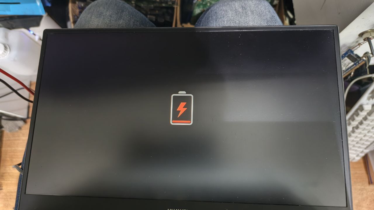

    DAH98NMB8C0 REV:C HF BATTERY LOGO DISPLAY
    Has anyone ever experienced a case like this? Or does anyone have a solution for this?

    Battery is low in voltage and is discharged. Attach the suitable power adapter to charge the battery.
    Does the unit power up with the power adapter connected?

      that's the condition when the power adapter is connected

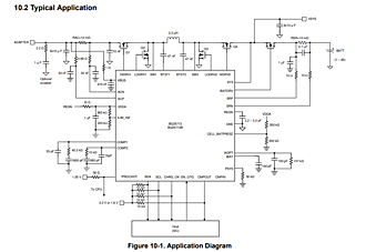

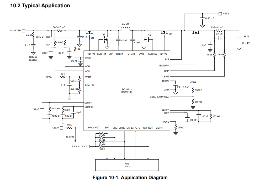

                Reference the datasheet for the same:
                https://www.ti.com/lit/ds/symlink/bq...ouser.com%252F
                Meter in DC volts (30v scale or higher) mode.
                Carefully measure the voltage to ground of the following pins on the charger IC:
                REGN ; pin 28 - should be ~6volts if normal
                VBUS ; pin 1 - should be the adapter voltage and is used to power this charger IC
                Then remove all power. Meter in resistance mode. Disconnect the battery as well.
                Measure the resistance between the SRN & SRP pin directly on the charger IC. Again, no power to the board.
                We are checking if the full path resistance for this battery charging current sense loop is correct for the charger IC. Most likely, the logic board designer used this reference datasheet for their design so expecting to see ~20R ohms for this measurement.

                    This is because the battery is discharged and the adapter is either not detected or there is a fault in the battery charging circuit.
                    REGN @ 6v is a good start.
                    Share the SRN / SRP resistance measurements. Disconnect the adapter and battery before measuring this full path directly on the charger IC. If the resistance is not like the schematic then the charger IC believes there is a problem and will shut down the charging process.

                      Also measure the voltage to ground of the SYS pin on the charger ic.
                      This is the main power rail. What is the voltage?

                        for vsys pin i found it at 8volt

                          The results of my SRN/SRP resistance measurements found 19v
