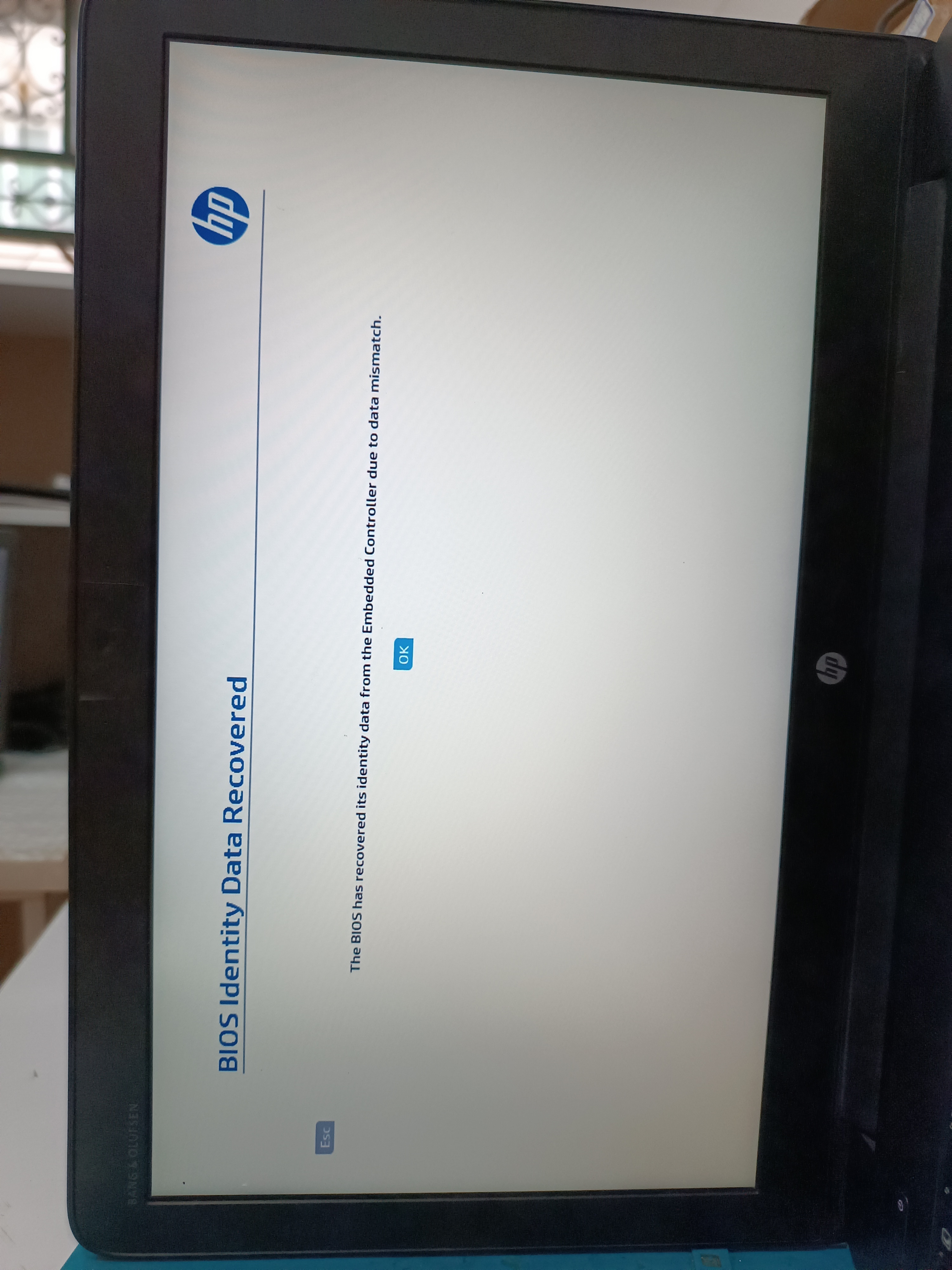

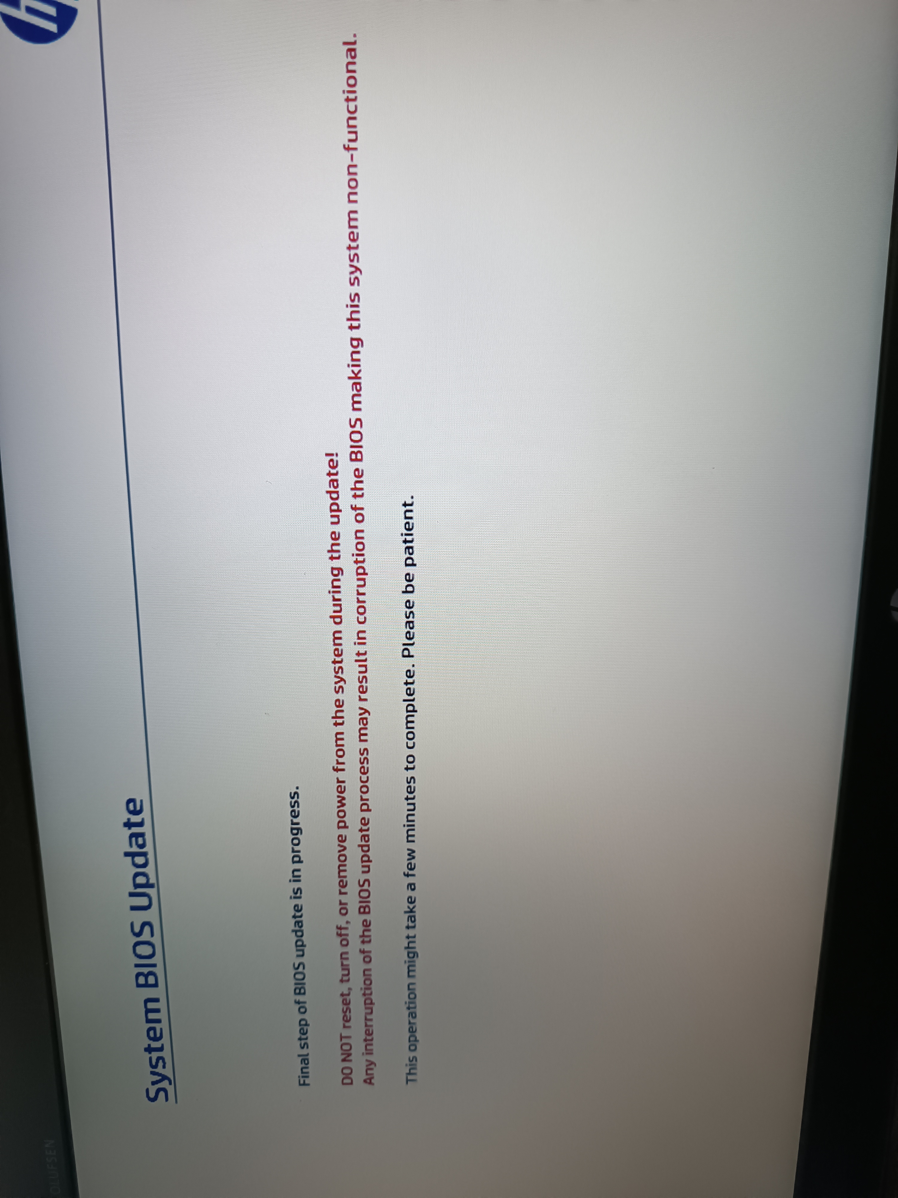

                  I requested the BIOS.
                  I got a BIOS that came with the image but gave a warning.
                  I accidentally faked the BIOS of the device itself and with that image came the image but it still gives two warnings.
                  I set the factory settings in the BIOS and restarted it but
                  it does not recognize the SSD and WLAN.
                  I also updated the BIOS to the latest version but these two components are still not recognized. While I can install Windows with the
                  HDD
                  SSD AND WLAN
                  tested and works.
                  By the way, I am still waiting for the BIOS that I requested in a separate thread.Click image for larger version
