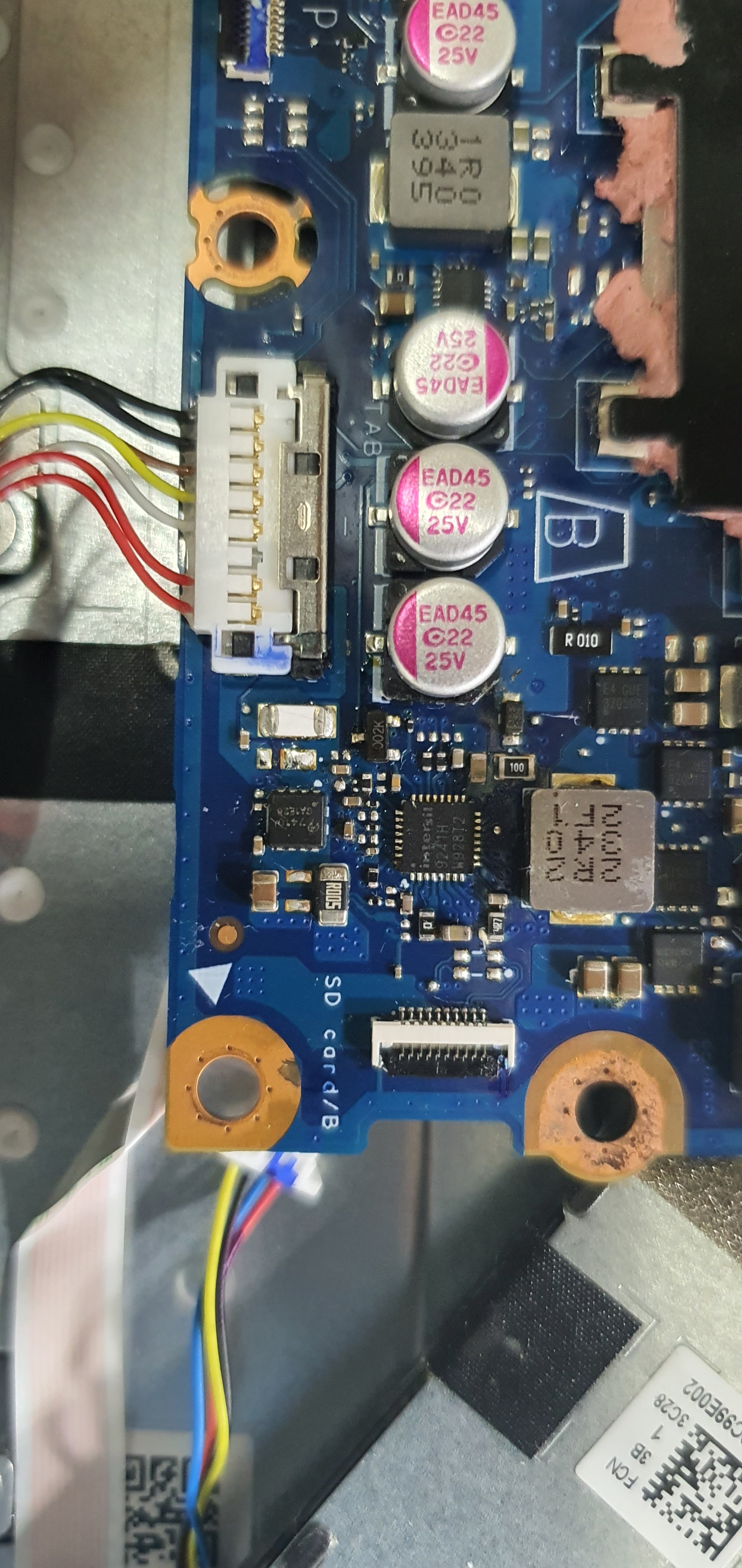

    Hi gentlemens,
    I have this vibo book that got a bit of water. After clean up the boarf. It works on adapter and work on battery, but it is not charging.
    I have checked first and second mosfet They look fine. Replaced 9241H to a new one but it is still not charging. Battery accept charge directly from power supply.
    Can you advice on things that i can check?

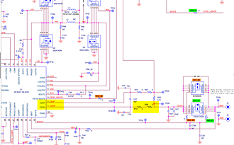

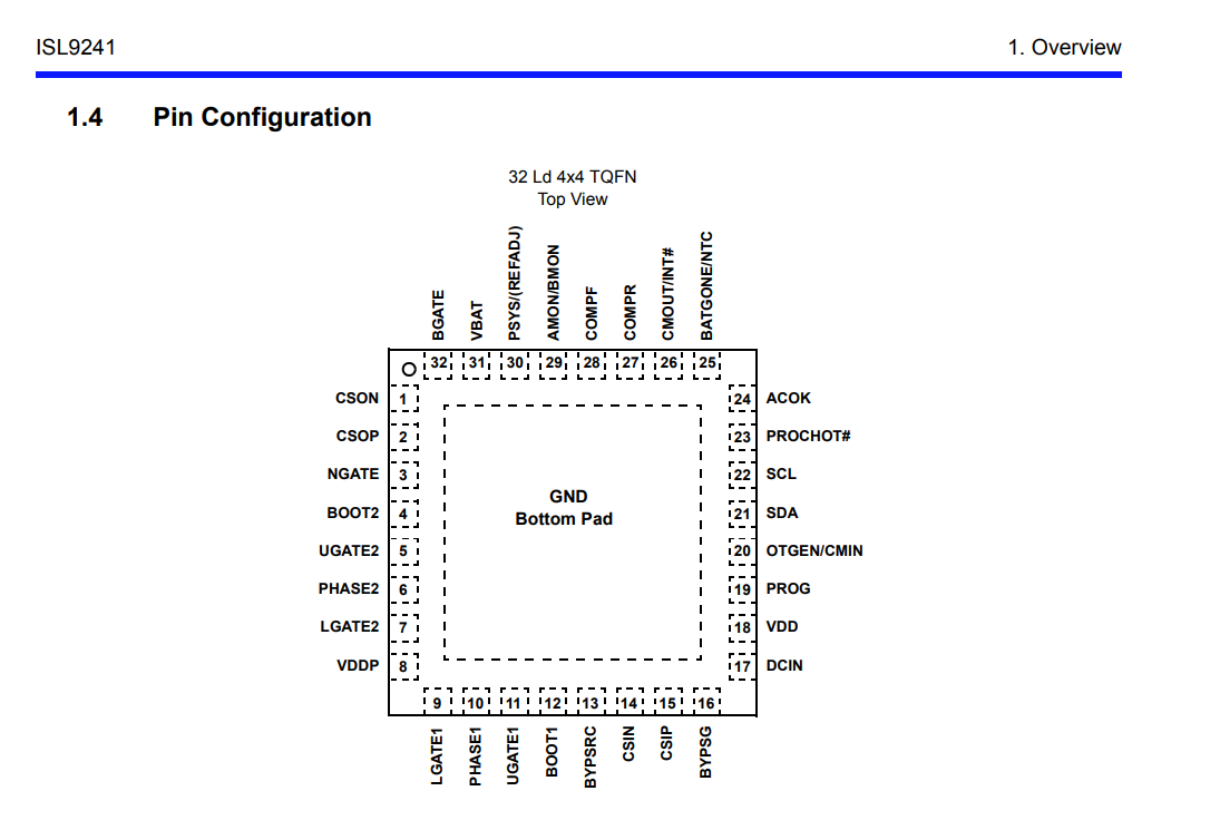

            See attached. Connect both the power adapter and battery. Carefully measure the voltage to ground of the following pins (more later):
            ACOK
            DCIN

                Remove all power. Meter in resistance mode. Measure the resistance between CSIP and CSIN pins. This is the battery charge current sense loop resistance path. Measure directly at the charger IC pins but without power to the board.

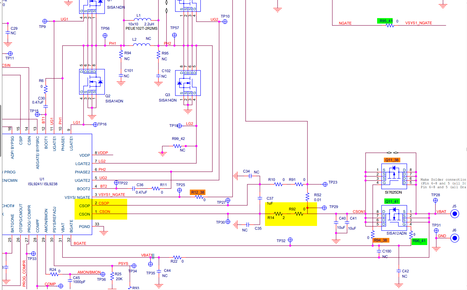

                    The resistance looks to be in line. See the evaluation kit for the ISL9241 for guidance on what is most likely copied on your Asus motherboard.
                    What is the voltage to ground on each pin on the battery connector?
