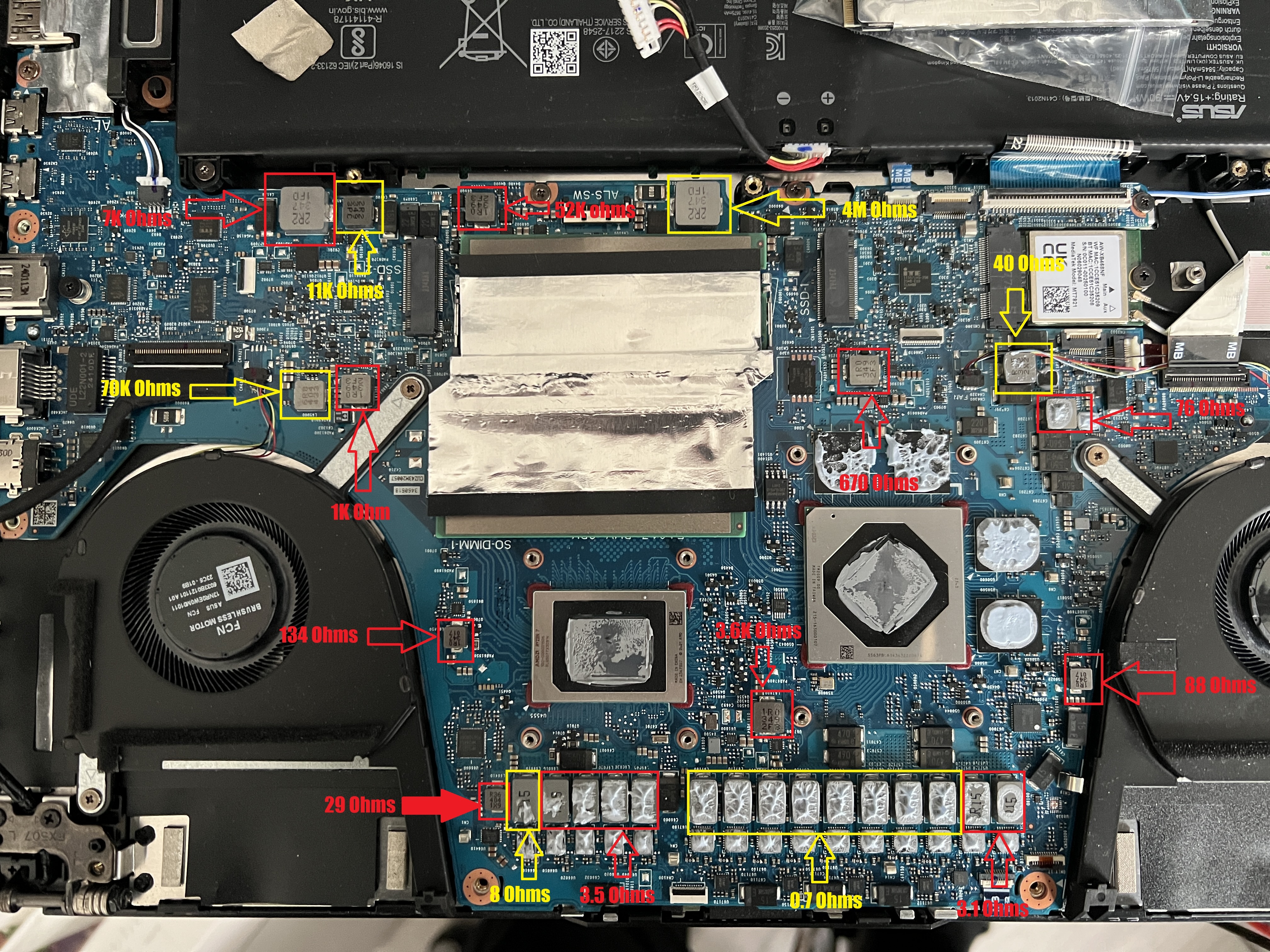

    I have an ASUS TUF A16,
    laptop board number FA617-PMV-GBM / 6050A3460902-MB-A02.
    Laptop is turning on but stay on with no picture, cpu is getting hot but gpu not, i found online photo of board and im attaching it - on the photo in upper right corner under wi-fi slot i have 1.3 ohm on coil after injecting 0.8v only part of gpu is getting hot that's why im suspecting faulty gpu chip.
    All other resistances looks fine.
    My chip have marking: 215-163000117
    do you know if 215-163000047 or 215-163000007 is compatible with this gpu to replace?

    The graphics is 7600s not 6700s - sorry, missclick.

        Hi, i dont have this board already, i've replaced GPU chip and now it works, returned it to my client.
