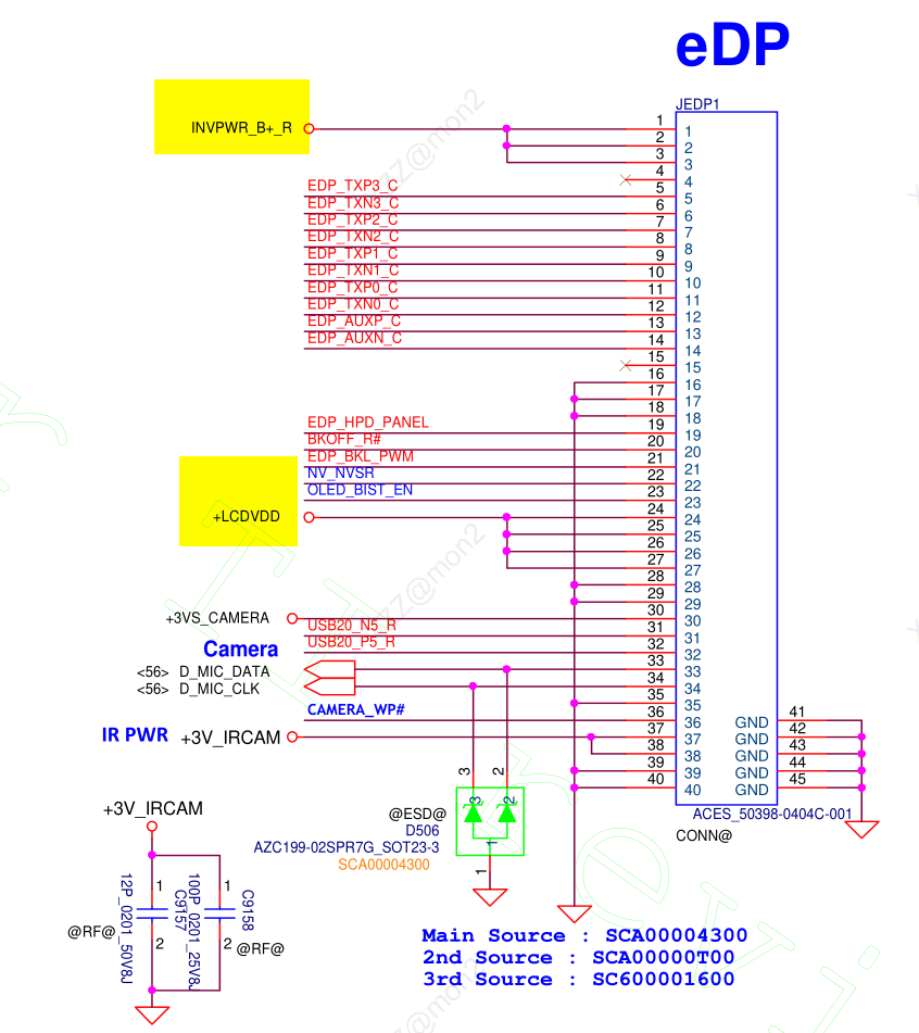

    i've got HP Omen 15-dh0007na which come with no display (works externally). Tried new flex & LCD, still no difference, i assume that there is no image/backlight as i couldn't see anything. Also tried to do me region on it BIOS, still same thing. Any ideas?
    Board: LA-H482P
  • mon2
    • Dec 2019
    • 14664
    Measure the voltage to ground of the eDP display connector.

      Those values are with LCD connected
      123 - 19.5V
      5-16 0v
      17-18 0.240V
      19-23 0V
      24 1V
      26-29 3.6
      30 3.3V
      31-32 0V
      33-34 0.5V
      35-40 0V

        24 1V
        26-29 3.6

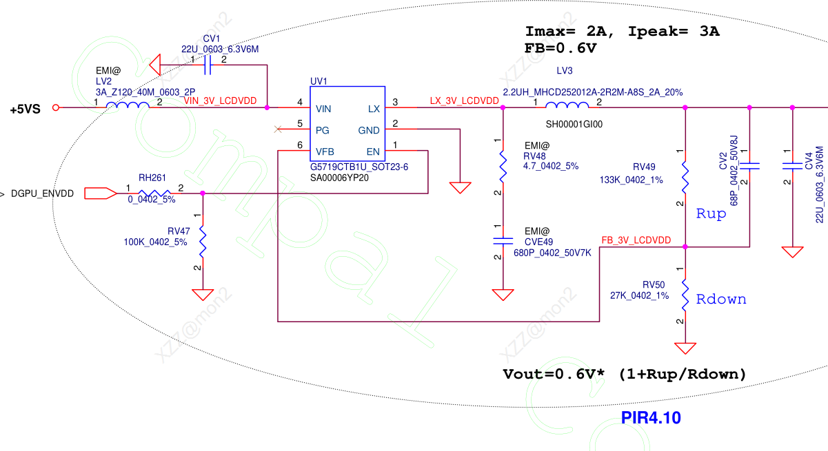

        These measurements are incorrect since pin 24 is also mated with pin 26.
        Confirm the +LCDVDD voltage to ground by testing the voltage to ground on inductor LV3 (either side).
        If truly @ 1v then UV1 regulator is in trouble.
        Test the voltage to ground on UV1 - pin 1, pin 4 and also pin 6.
        Click image for larger version  Name:	uv1.png Views:	0 Size:	149.9 KB ID:	3636976

          oled_bist_en 0v
          +lcdvdd 3.6V
          nv_nvsr 1v
          1-3 pin 19.5v

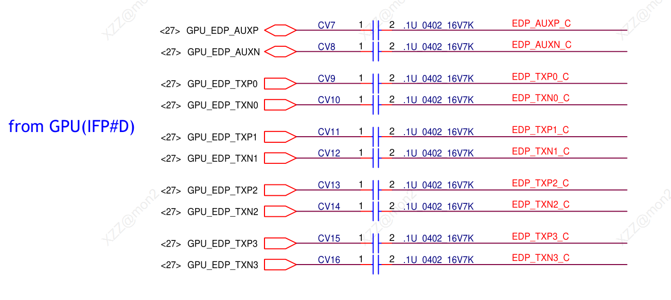

            Confirm that each of the following caps are present and are not defective.

              I don't have board view for it, can't really see those, could you help me locsting them?
              • m1ch43lzm
                • Mar 2019
                • 919
                • Peru
                Boardview here: https://www.badcaps.net/forum/troubl...atic-boardview
                Schematics here: https://www.badcaps.net/forum/troubl...-cx-schematics
                It says LA-H492P but in the first page LA-H482P is also mentioned
                • tommy97
                  • Mar 2023
                  • 167
                  • United Kingdom
                  CV 15-16 0.95V PIN 1 / PIN 2 - 0V
                  CV 14-13 0.94V PIN 1 / PIN 2 - 0V
                  CV 11-12 0.95V PIN 1 / PIN 2 - 0V
                  CV 10-9 0.92V PIN 1 / PIN 2 - 0V
                  CV 7-8 0V PIN 1 / PIN 2 - 0.28V
                  Caps are okay.
