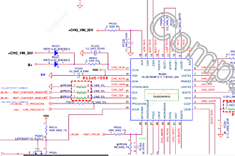

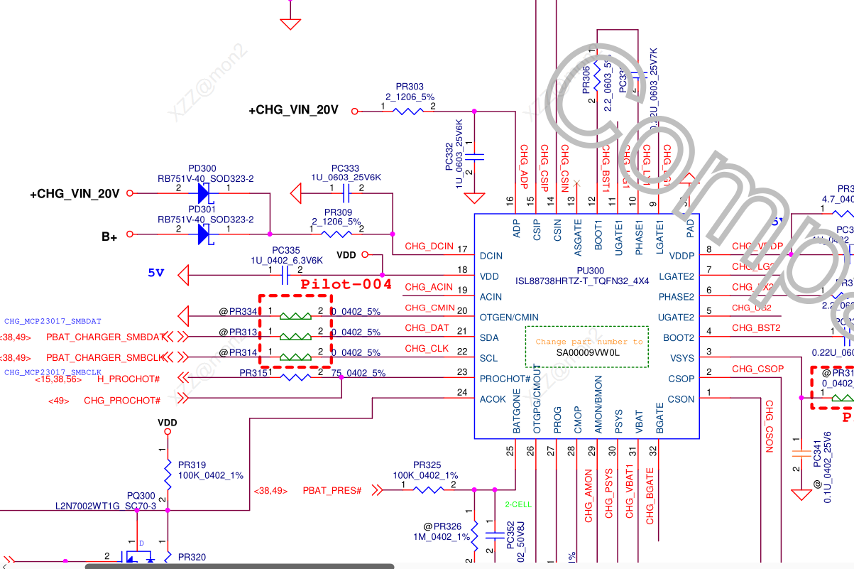

          Review the charger IC @ PU300.
          Carefully measure only if you have fine tipped meter probes, the voltage to ground of the following:
          Pin 17 ; DCIN for PU300
          Pin 19 ; CHG_ACIN
          Pin 24 ; ACOK
          Pin 15 ; CSIP
          Pin 14 ; CSIN
          Post each measurement.

            Originally posted by mon2
            Each is ok. The first 2 are linked to VCORE = CPU power rail. By design low voltage rails are with a low resistance to ground.
            PL1150 = power rail for the GPU. Again, not considered a short.
            Pin 19 ; CHG_ACIN
            Pin 24 ; ACOK
            Pin 15 ; CSIP
            Pin 14 ; CSIN
            Pin 17 = 8.5v
            Pin 19 = 0.912v
            Pin 24 = 3.045v
            Pin 15 = 4.999v
            Pin 14 = 4.999v
            • mon2
              • Dec 2019
              • 14713
              PD300 appears to be defective. You should see the power adapter voltage on pin #17. Confirm again. The higher of the 2 power sources should appear on pin #17.
              • D@nt3s_1nfern0
                • Mar 2025
                • 26
                • Greece
                ok so when i plug in the usb meter with the power adapter the meter shows 20v and in the pin 17 shows 20v as well but after a few seconds the usb meter drops to 5v and then the measurement on pin 17 drops to 8.5v

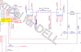

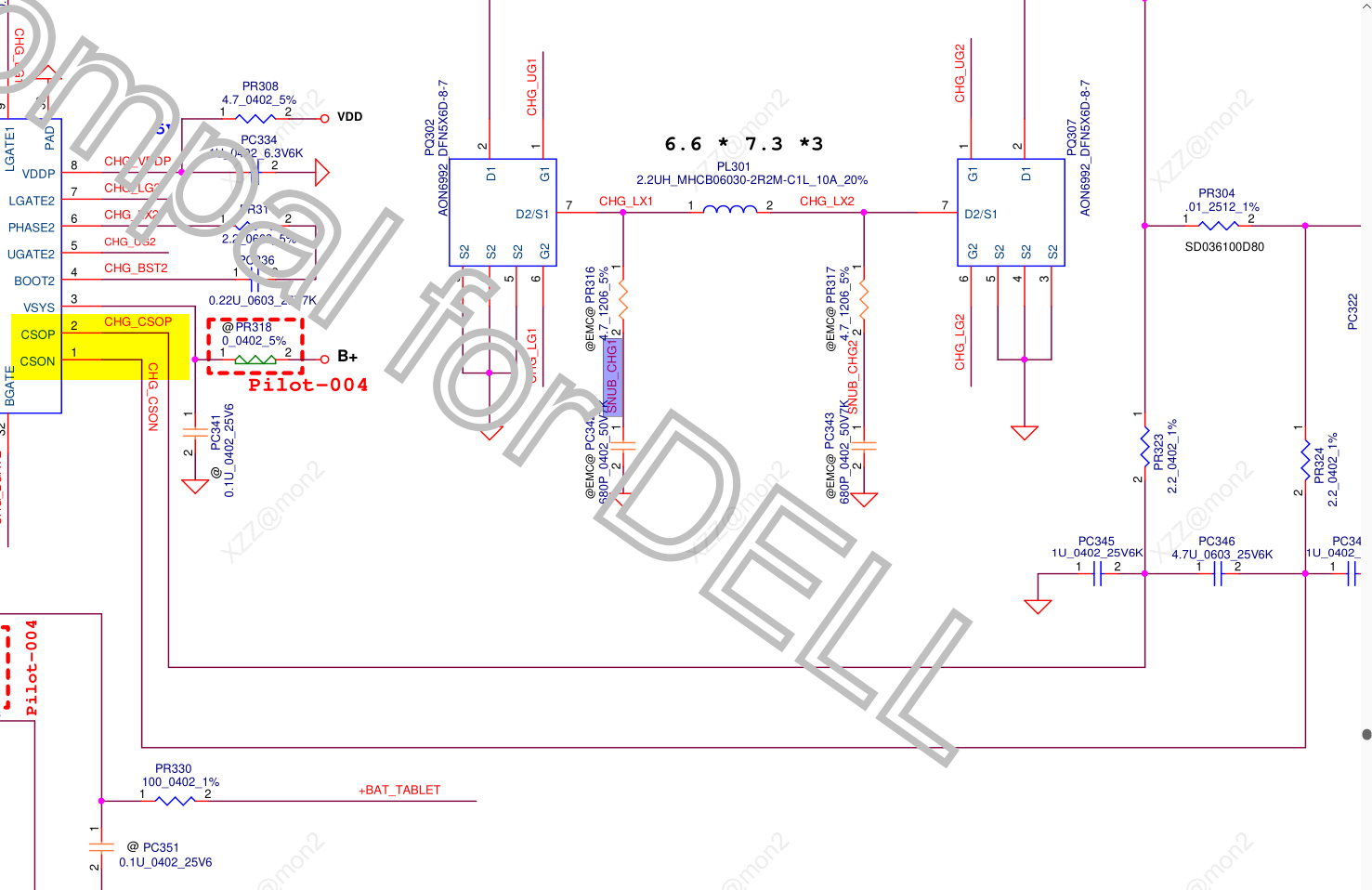

                  Noted. Remove all power. Meter in resistance mode. Measure the resistance between pins #1 and #2 on PU300. Confirm the full path resistance for the battery charger circuit. This total resistance must be close to the schematic values else the charger IC will see this is as a risk and power down. Post the measurement.
                  Measure directly on the charger IC pins (without power).
                  • D@nt3s_1nfern0
                    • Mar 2025
                    • 26
                    • Greece
                    Ok just to confirm that i will put the one probe on pin 1 and the other on pin 2 no matter the colors right ? if thats the case then i do get 4.3 ohms
                    • mon2
                      • Dec 2019
                      • 14713
                      Correct. The resistance is correct and is not the fault.

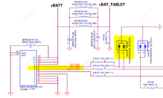

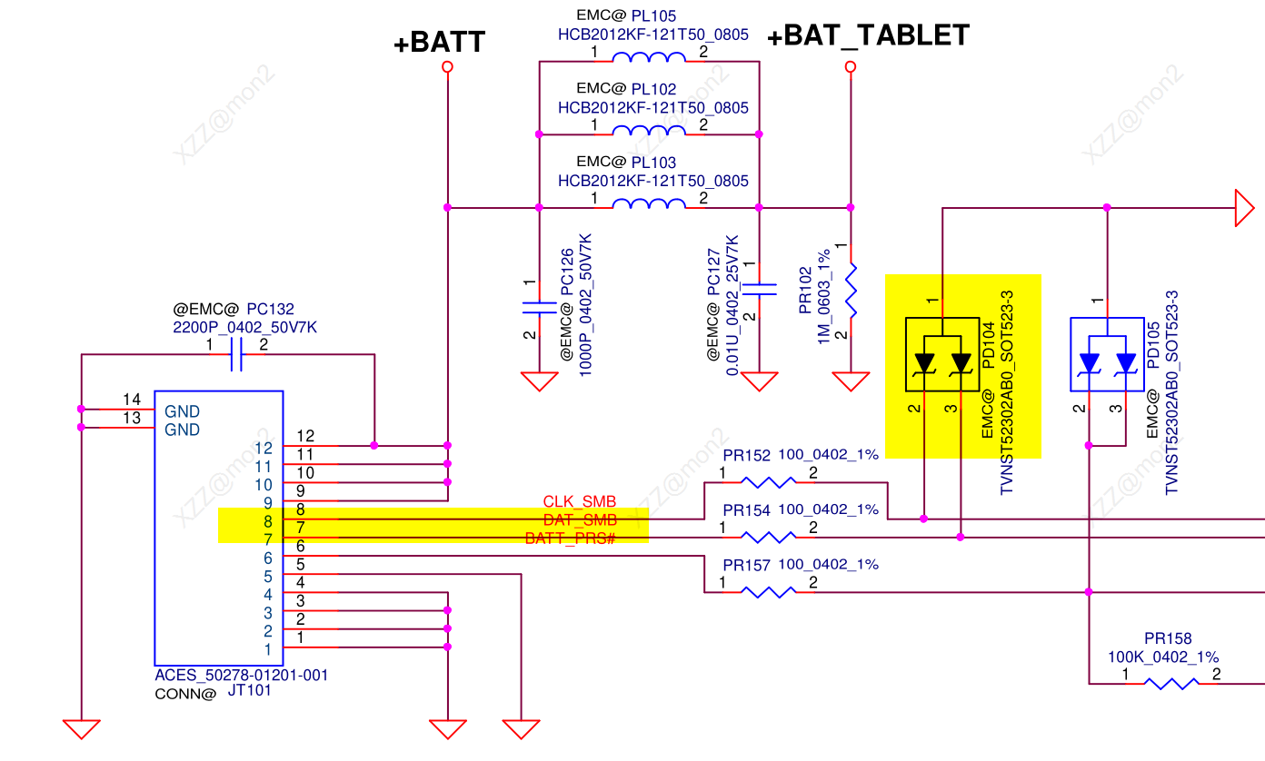

                              Measure the voltage to ground on each pin of the battery connector. The SMBUS (SCL / SDA) pins are of most interest. These lines are also used to communicate with the charger IC. If either of the TVS diodes have triggered, they will shunt the communication.

                              • D@nt3s_1nfern0
                                • Mar 2025
                                • 26
                                • Greece
                                Does it reach 20v without the battery?
                                yes it does

                                  • D@nt3s_1nfern0
                                    • Mar 2025
                                    • 26
                                    • Greece
                                    Pin 6 = 3.094v
                                    Pin 7 = 3.374v
                                    Pin 8 = 3.374v
                                    Pin 9 - 12 = 5.023v
