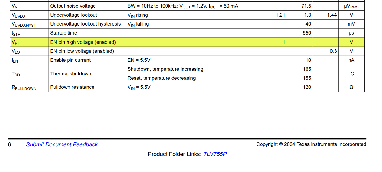

    1. Should USBC1_3V3LDO_EN be a full 3.3V?
    No, it is ok if EN pin on the LDO @ UF115 is 1V or higher to enable this LDO.
    From the TI datasheet:
      Click image for larger version  Name:	ven.png Views:	0 Size:	106.0 KB ID:	3618538
      Thank you for your help and guidance β€” it has really made a big difference for me.
      At this point, I can confirm that UF115 is working properly, which gives me more confidence in the direction I'm taking with the troubleshooting.
