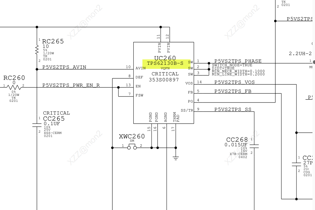

    Hello, The macbook is on 5V 0.11a, and there is no switching to 20v. The UC260 controller is missing from the board, help me find the marking of the controller
  • mon2
    • Dec 2019
    • 14011
    See attached
    https://www.aliexpress.com/w/wholesa....home.search.0
    Share the full p/n from the schematic with the vendor before ordering.
    Click image for larger version  Name:	UC260.png Views:	0 Size:	92.1 KB ID:	3617233
