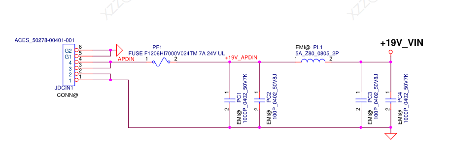

    Attached.
    Remove all power. Meter in resistance mode. Measure the resistance to ground on the main power rail (PL1 is ok; either side) that mates with the DCin power connector. Checking if the main power rail is shorted. What is the resistance in ohms?
    One meter lead to ground; other meter lead on PL1. Either meter lead color is ok.

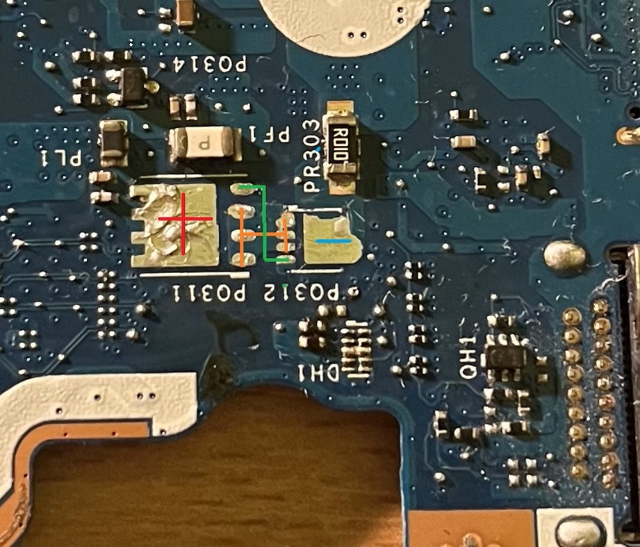

        Review PQ311 and PQ312. No power to the board. Meter in resistance mode.
        Measure the resistance across these mosfets:
        source / drain
        source / gate
        gate / drain
        Post each measurement. Each measurement should be hundreds of k ohms or higher. Otherwise the mosfet may be defective.
          PQ311
          S - D - 0,7 ohm
          S - G - 1ohm
          G - D - 1,3 ohm
          PQ312
          S - D - 294K ohm
          S - G - 1 ohm
          G - D - 304K ohm
          I found a datasheet for the PQ311 showing how the pins are arranged, but not for the PQ312, but I went according to what was shown on the pq311, that 4 pins are Drain, 3 pins are Source and 1 pin is Gate.

            Both look nasty and shorted but start with fluxing and removing PQ311 off the board. Then (without power), measure the resistance again on PQ312. Need to confirm if the resistance values improve or not - especially the S/G @ 1 ohms.

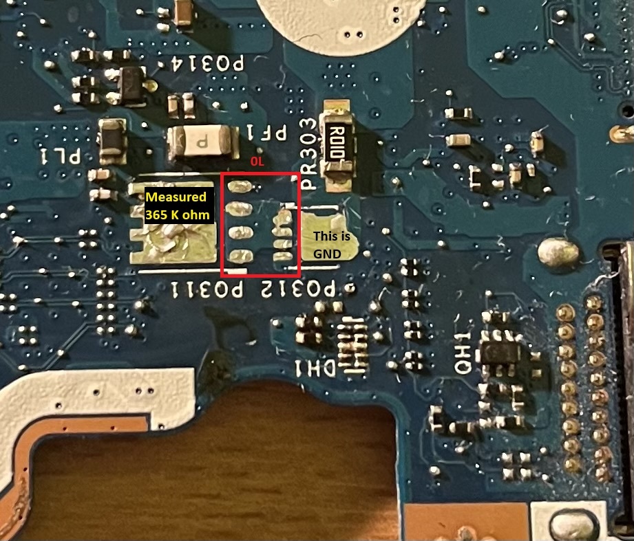

                  I also disconnected the second mosfet. When it was warm, it showed some values, but terribly high, over 700 K ohms. When it cooled down, I didn't measure anything anymore and the meter showed 0L between D-S and D-G. I also attach a photo when I measured the pins on the board. I measured the plus and minus from the other side of the connector to the other side of the board on the pin to see if there was a short circuit and everything beeped. Then I measured the internal pins and according to the picture you can see how they worked with each other.

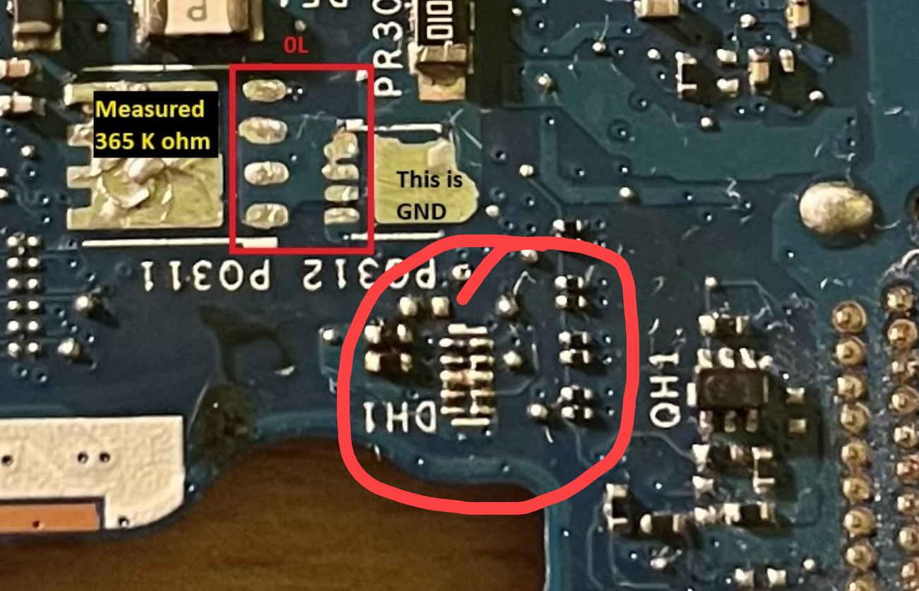

                      I measured through the resistor and the picture shows the result. Where I measured 365K ohm is the plus pole. I also measured the disconnected mosfet PQ311 and between all legs I measured 1 ohm, so this mosfet will be good. Mosfet PQ312 shows me infinity 0L.

                        See attached. Is this area shorted?
                        Test the removed mosfets. At least must be shorted to cause the readings reported earlier.
