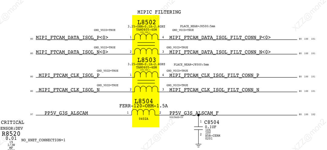

Hello friends. There is a problem, the camera does not work. Replacing the display did not bring results. The problem is on the board. Please tell me where to look?
macbook a1989 820-00850 no camera
The display is 100% compatible with this chassis?
Is the camera being detected by the logic board and just not working?
What are the voltage to ground measurements for:
I2C_FTCAM_ISOL_SDA
I2C_FTCAM_ISOL_SCL
The enable voltage is correct to enable the MUX. After the mux is enabled, the rest is about the MIPI lines to send the data out of the camera to the host board (MIPI CSI interface).
Be sure the EMI filters are present and soldered. You can test each in DIODE mode (without power) - measure across the part. Each should be ~0v in diode mode = short. Otherwise, the EMI filters are defective or not soldered properly.
no camera is not detected. I put the board in a known working case with a 100% working camera, but the board simply does not see the camera. At the same time, the light sensor, which is on the camera module, works properly. I will note that there is not even an attempt to connect to the camera. That is, there is no green light blinking. It is as if the camera simply does not exist. I think that you need to try replacing the T2Comment
