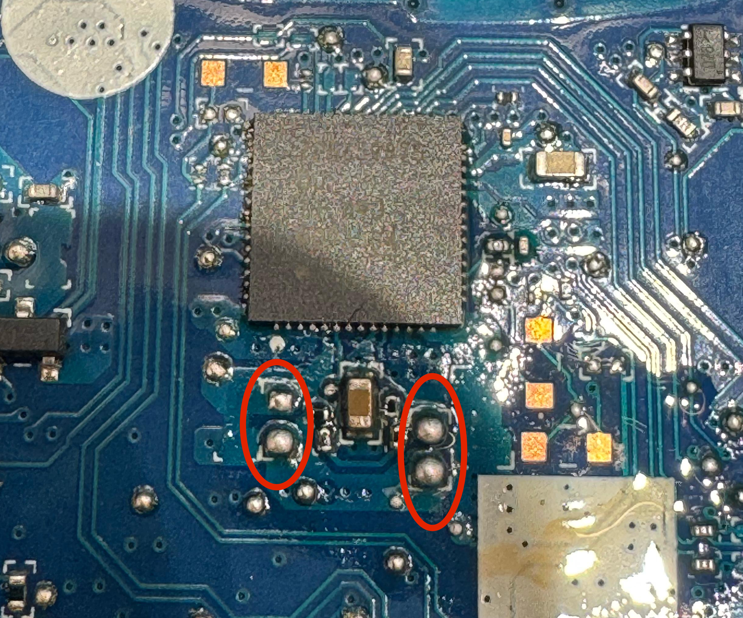

    Good morning guys. I have my Omen laptop (DA0G3EMBCD0) that now gives no signs of life (no LED).
    During the night I misplugged a slim usbdrive which had the shield damaged, I guess I caused a short because the laptop turned off and never turned on again.
    After taking it apart I noticed with the thermal imaging camera that two ICs on the mainboard reach 100 degrees Celsius. Thanks to the boardview I saw that they are PU8600 and PU8601. I tested the pins of these ICs and found these anomalies compared to the schematic
    PU8600
    6 (3VS5_LX) - 5 OHM to ground (normal?)
    14 (3VS5VOUT) - SHORT TO GND
    17 (+3VPCU) - SHORT TO GND
    19 (3VS5_LX) - 5 OHM to ground (normal?)
    PU8601
    6 (5VS5_LX) - GND
    19 GND - SHORT TO GND
    20 GND - SHORT TO GND
    Suggestions on how to proceed?​

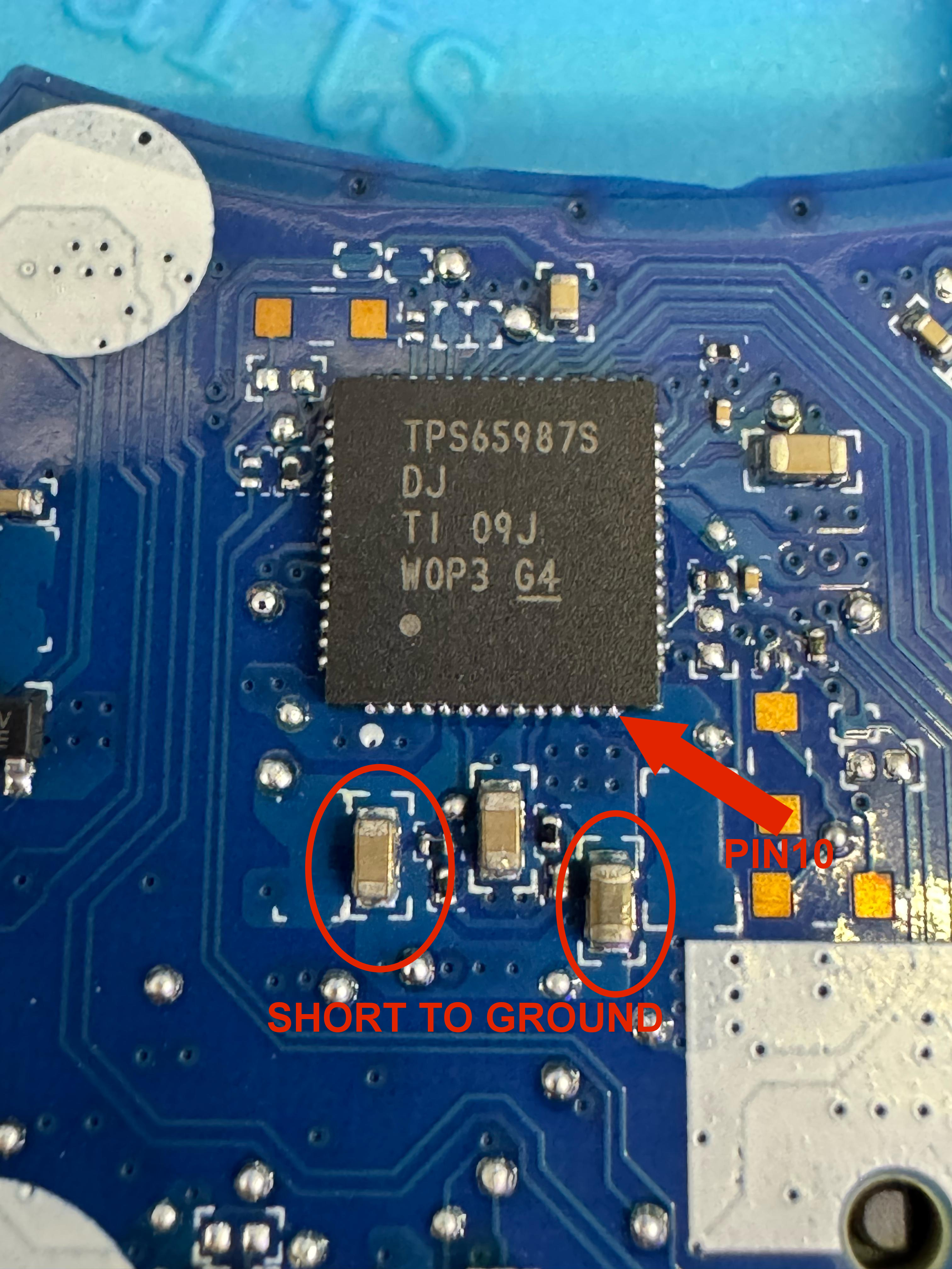

          OK the procedure should not be complicated also because I caused the short on the only USBC port. I have to leave the lab now but I will do the research as soon as possible and update you
          • ryogadan78
            • Nov 2021
            • 66
            • Italia
            In the boardview, the USBC connector is marked as CNP1. The TBTA_VBUS_L pin is connected to pin 10 of an IC marked on the boardview as UP1. I enclose a photo pointing out that two nearby capacitors are shorted to ground on both pins
            • ryogadan78
              • Nov 2021
              • 66
              • Italia
              Hi Mon2, I don't know if you saw my answer. Unfortunately I don't really know how to proceed considering that the VBUS comes to this IC. Any suggestions?
              • mon2
                • Dec 2019
                • 13887
                Flux and remove each of these capacitors. Keep notes of their locations. Then measure the resistance again without these parts. No power to the board.

                    Done, the short circuit still seems to be present. Resistance to ground is 0.4ohm

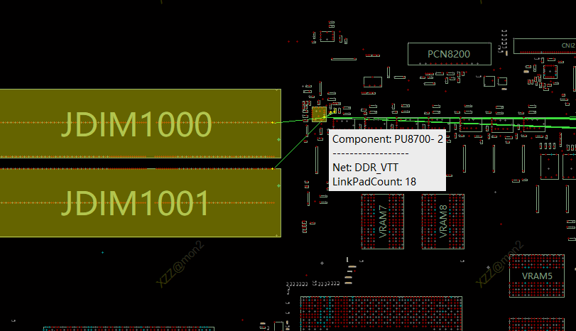

                        • mon2
                          • Dec 2019
                          • 13887

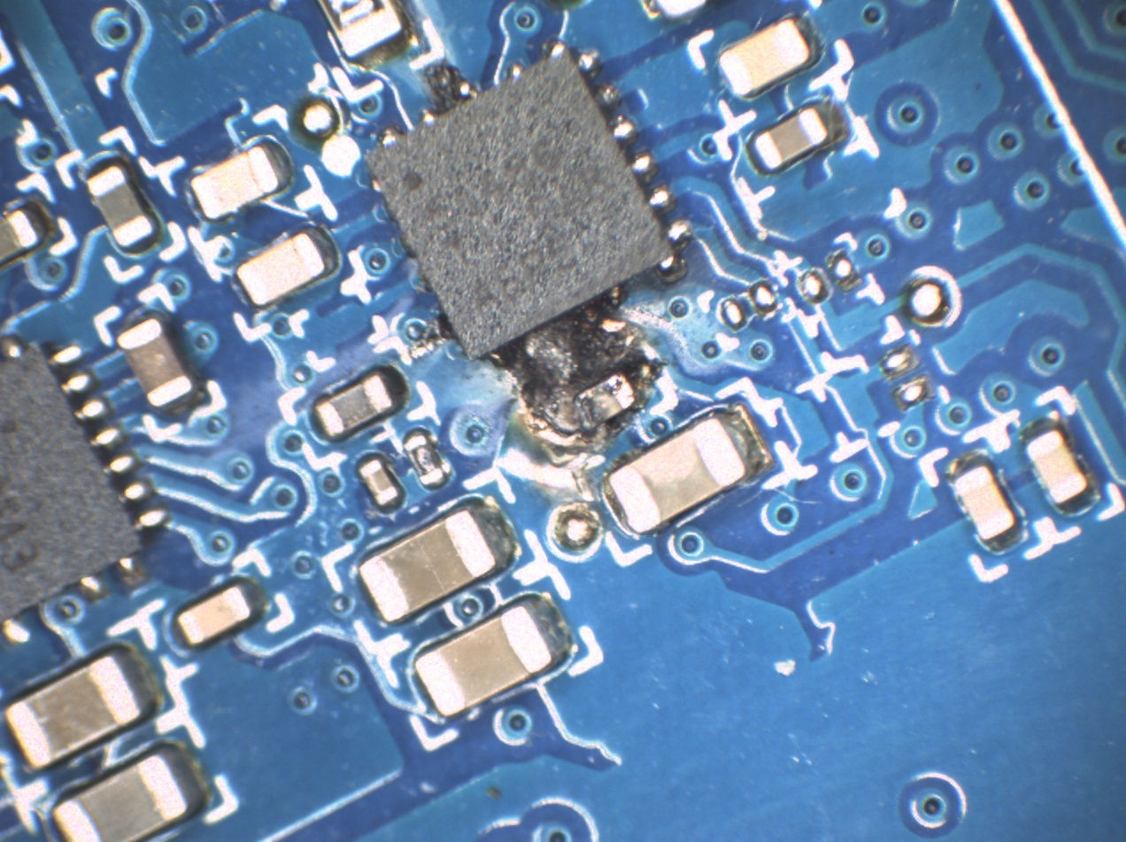

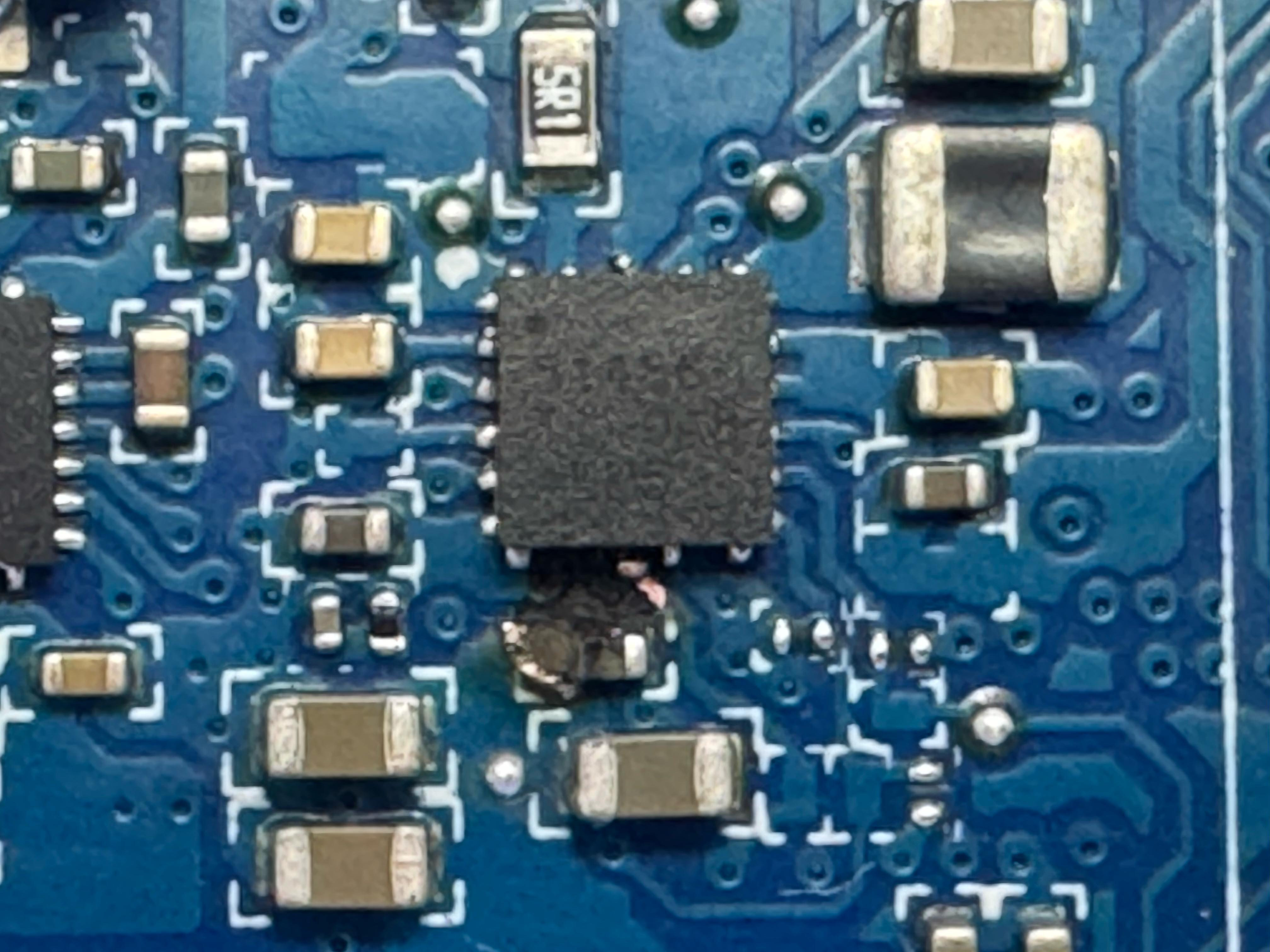

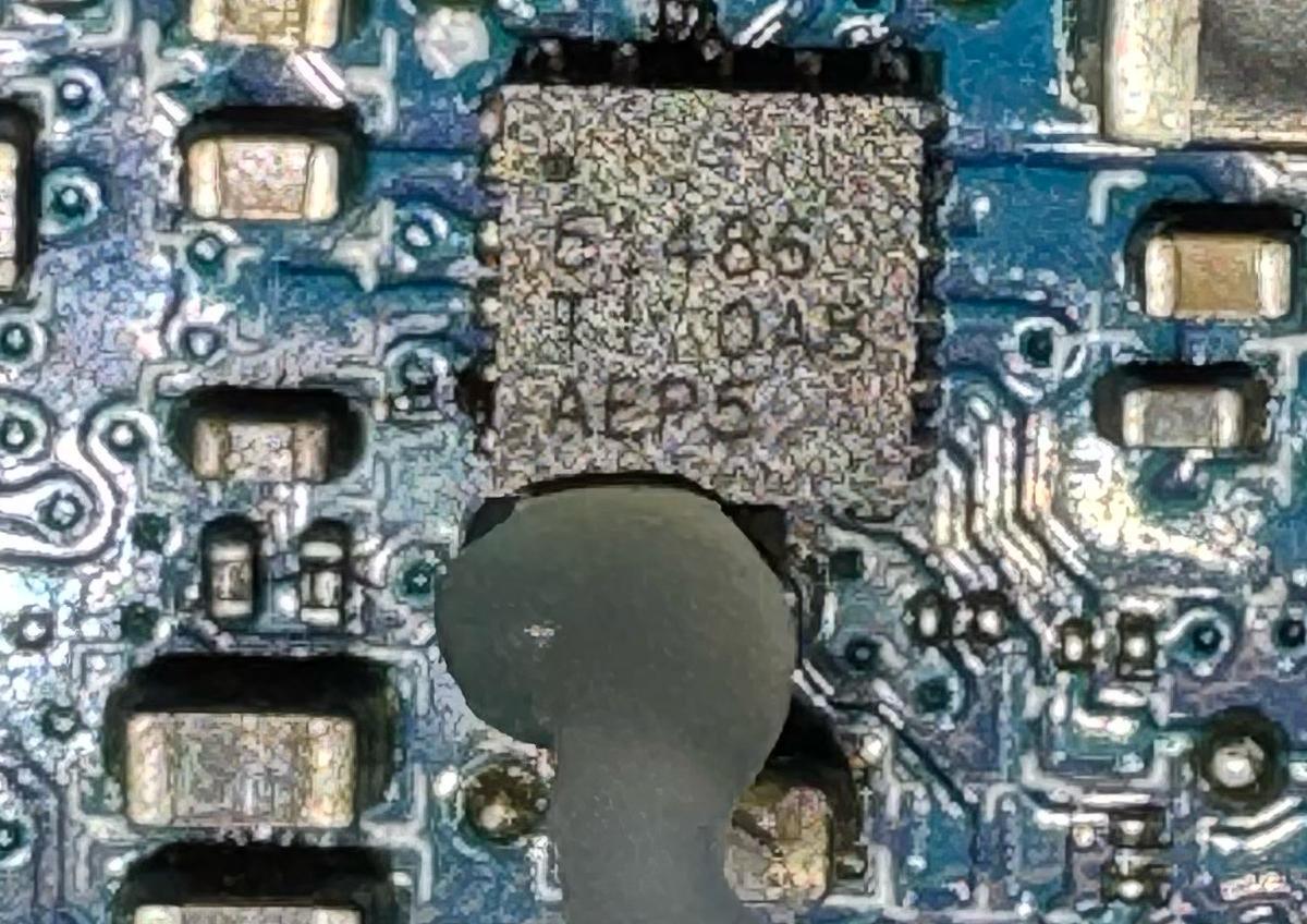

                          What are the topside markings on PU8700?
                          The region of this area looks to be burnt or is this bad flux?
                          Also, share a larger pic of this area. We are reviewing the same boardview and to me, this is not PU8700. The surrounding parts do not match your board pic.
                          • ryogadan78
                            • Nov 2021
                            • 66
                            • Italia

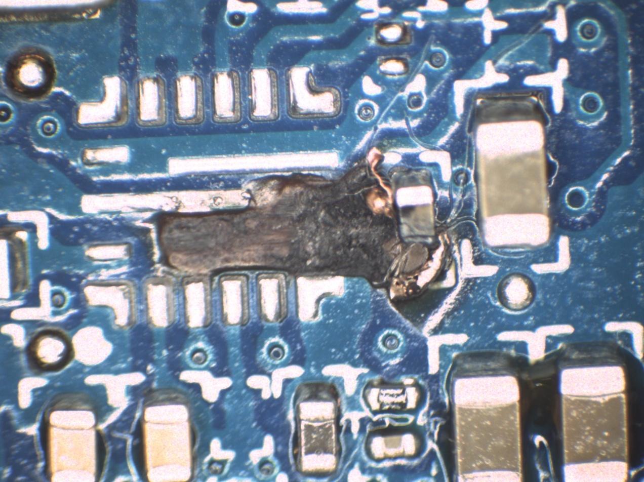

                            Hi Mon2, sorry I have not been present. Health problems. Here I am with you. I am enclosing a photo where you can see the initials above the chip and a photo showing a larger area of the mainboard. I actually noticed too that the boardview file does not match 100%.
                            The region of this area is burnt
                            Topside marking of IC
                            51486
                            TI OA8
                            AEP5

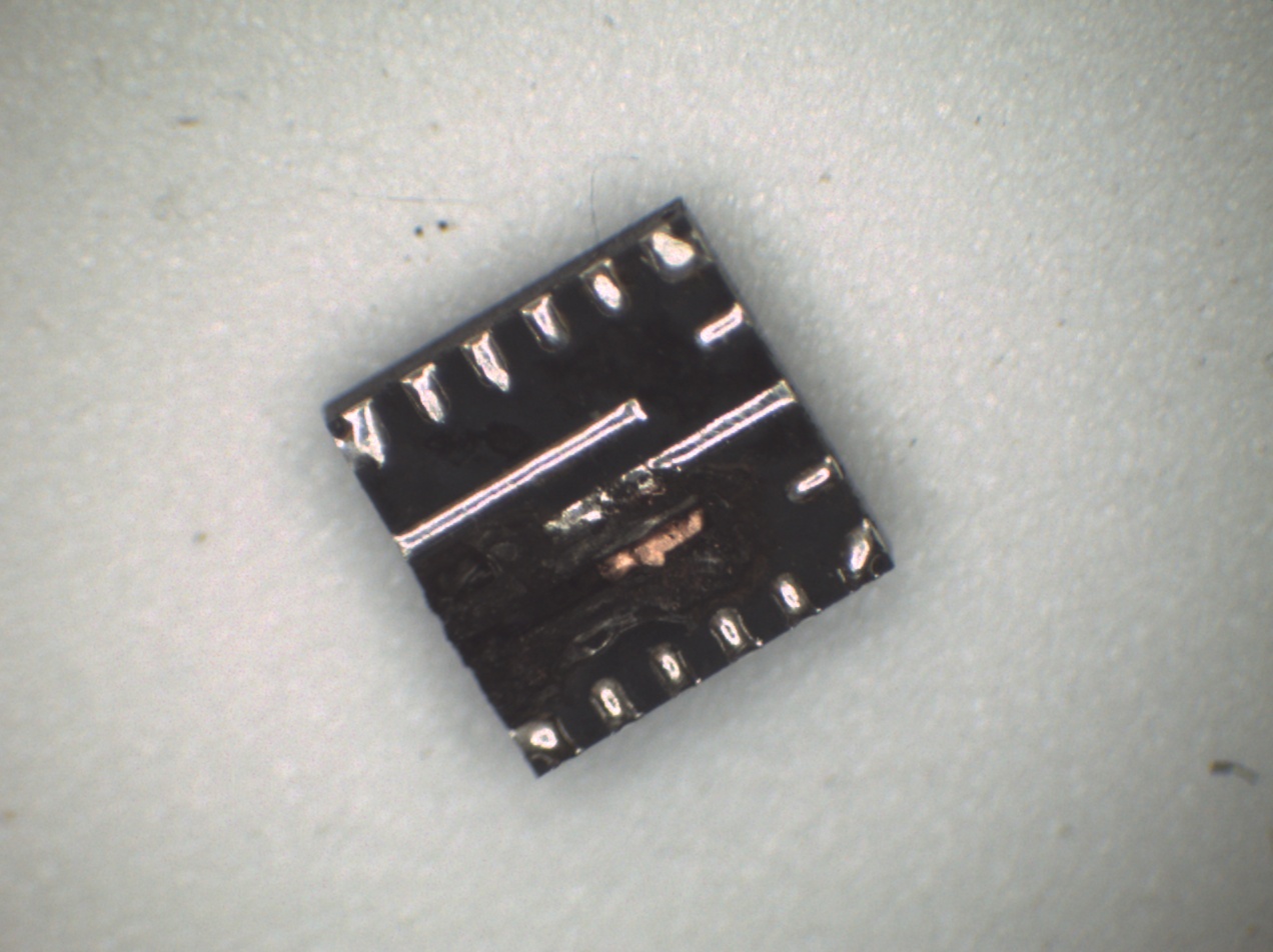

                                  Review the bottom side of the 51486 chip - appears that one pin (at least) is missing. There should be 5 contacts on the bottom side that appears to be 'burnt' looking.
                                  • ryogadan78
                                    • Nov 2021
                                    • 66
                                    • Italia
                                    Here are two photos, of the chip and what I see under the mainboard. Could I clean the mainboard a bit to find out if there is any more damage?

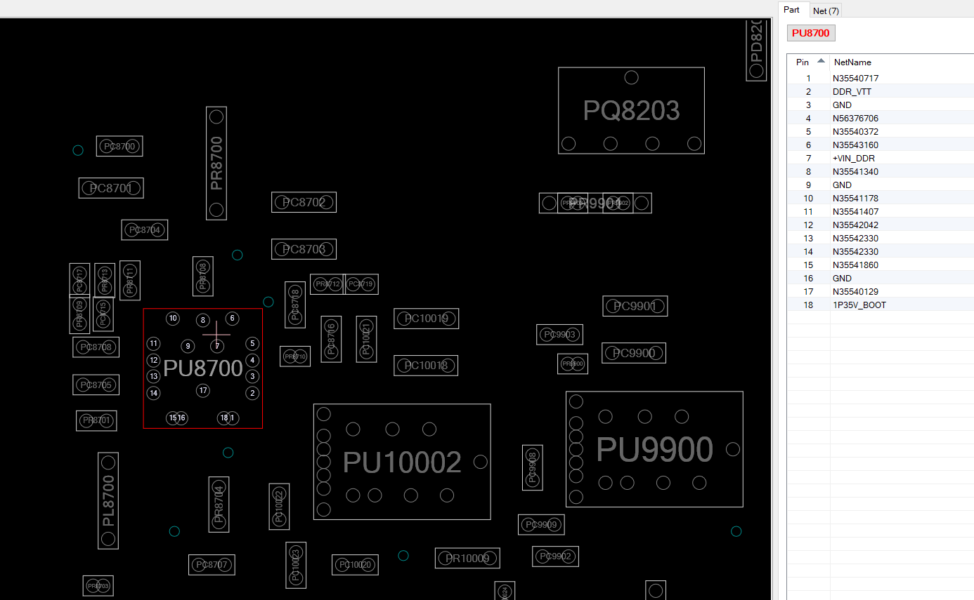

                                      It seems that my boardview is not exactly identical to my mainboard
                                      • mon2
                                        • Dec 2019
                                        • 13887
                                        I see the same BV in my (paid) database of schematics. The surrounding parts are not 100% matching your board under repair. This regulator (PU8700) appears to be linked to the RAM sockets to the left of this part.
                                        Are there any other markings on the logic board that may help to locate a schematic / more accurate BV?
