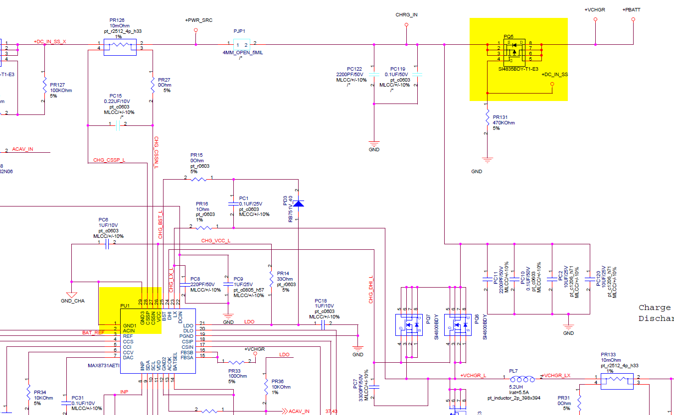

            The Apple board may be close to working properly. Suspecting the battery is in a locked state and has no charge so waiting for a fresh one to arrive for tomorrow.
            Locate mosfet PQ5. Is this part on your board? The posted schematic is not exactly your model so we cannot be sure it is with the same parts.
            What are the topside markings of the charger IC @ PU1? We want to confirm if the posted schematic and your board are similar.
            If you find PQ5, measure the resistance from pins 1-2-3 (pick any pin) to the VCORE rail used by the CPU. What is the resistance in ohms? One meter probe @ pin 1-2-3 (PQ5) & other meter probe on VCORE.

              yes i have this pq5 in my board at back side of battery port , vcore rail means those pl12 13 14 ?
              pu1 is MAX8731AETI t1817 +titij
              in resistance mode - one probe to inductor , other probe on pins of pq5 --- on top of pq5 name pins - all 600s , below pins in 200s and one 700s .
              i guess according to your pq5 in the pic , in mine its pq4 - so measured it too from pq4 pins to pl12 inductor -- 663 at one side and other sides are in 200s . one was giving ground low resistance i guess.
              the board is really much similar to this uma schematic , i can find all the parts good and clear according to this schematic . my board is 1400 vostro tt346 which is much exactly board like inspiron 1420 so this matched well except for may be the adaptor dc port

                      the pq5 (your posted schematic ) is from discrete dell 1420 scehmatic which is not a match with the board we working on now , the dell 1420 uma matches good with the board i have , with all the capacitors , coils ,chips as pu1 , 2 names etc matches great with the board i have. i attached it again just incase for more reference for you .
                      the pq5 in your posted schematic(discrete 1420) is connected to resistor pr131 then to the ground , but in mine it does not match ,only pq3 is matching connected to resistor pr112 (at back of board ) then to ground in dell uma 1420 schematic . i also checked the pl7 inductor is connected to pr119(r010) in mine which matches to uma 1420 schematic(near battery pins) . in discrete 1420 schematic its not a matching number . sorry for last time i checked on pq5 , this time i am sure its pq3 for my board matching with uma schematic .
                      so now i checked the pq3 pins one probe to pl 12 or 13 or 14 coil (cpu coils) on either side (i am not sure where exactly i should put for vcore rail) . the ohms were around in 1ks then sometimes 900s then 600s , with reverse probing its same as 600s ohms at one side and 200s ohms at one side . i have attached the pics about pq3 and its resistor related and back of cpu which would be vcc core aka vcore rail ( i dint know exactly what is vcore - in internet they said vcc is called as vcore too ) .
                      no i never checked vocre voltage . all i am doin is cold testing . by the way in this pq3 or 5 , i really dono what are 1, 2 ,3 pins are from the board .so i measured in all pins . somtimes when probe reversed i do get more than 1k values for a sec and nothing shows in multimeter . only one pin shows 1500-1600 ohms .

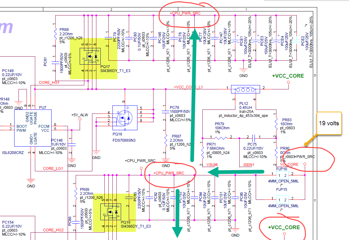

                        Confirm the power path from the main power rail (+PWR_SRC) to the VCORE rails.
                        Remove all power. Meter in resistance mode. Touch your meter probes together and note the resistance. This is the same expected resistance for the next measurement.
                        One meter probe on +PWR_SRC @ PQ3 (pin 1-2-3 - any of these is ok).
                        Other meter probe at:
                        PQ17 (pin 5-6-7-8 - any of these is ok) ; the measurement should be ~0 ohms (like when you touched the 2 meter probes together). This mosfet is 1 of 3 that are the HIGH side mosfets.
                        This mosfet and also, PQ19 and PQ21 take turns in powering the very high current demanding CPU over the VCORE rail.
                        Confirm that the resistance between PQ3 (+PWR_SRC) and PQ19 (5-6-7-8) is also ~0 ohms. Then finally test PQ3 to PQ21. Should also be ~0 ohms.
                        Next, PQ3 (+PWR_SRC) to PQ17 (pin 1-2-3). What is the resistance in ohms? If you are on the 2k (2000) ohm scale on your meter and you are able to take a measurement then either PQ17 or PQ19 or PQ21 is defective and the high voltage of the power adapter most likely has travelled onto the CPU rail. A good mosfet that is not defective will measure hundreds of k ohms or higher.

                          #32
                          about the pq3 readings , please see the pic sir.
                          • playit
                            • Feb 2020
                            • 182
                            • india
                            #33
                            so if i understood about the test ,see if i have done this right -- i probe pq3 1 2 3 with all those pq 17,19,21 pins 5 6 7 8 (they were at back of board at place of cpu inductor coils) -they were o ohms ( i mean the expected resistance in my multimeter) .
                            then i kept pq3 1 2 3 pins to pq 17,19,21" 1 2 3 pins -- red (volt) probe from pq3 123 pins to pq 17 19 21 123 pins - gives nothing --only once i saw some 1k ohms then disappear . if reversed black (ground) probe from pq3 123 pins to pq 17 19 21 pins - gives 670s ohms ..
