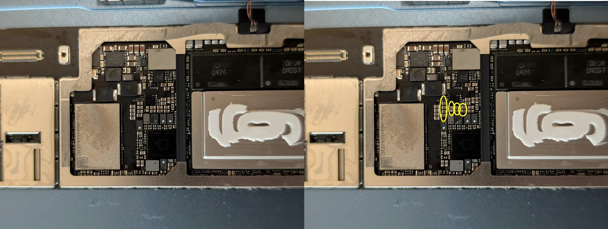

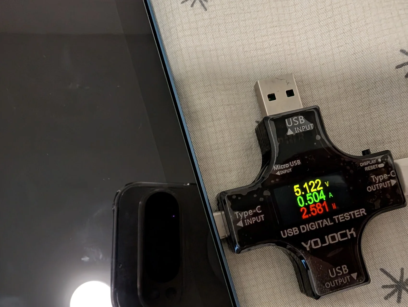

    My iPad suddenly stopped working and does not turn on and is not detected by a computer. When I plugged it in and measured, it read the following:
    5V, 0.5A, 2.5W (both with and without a battery).

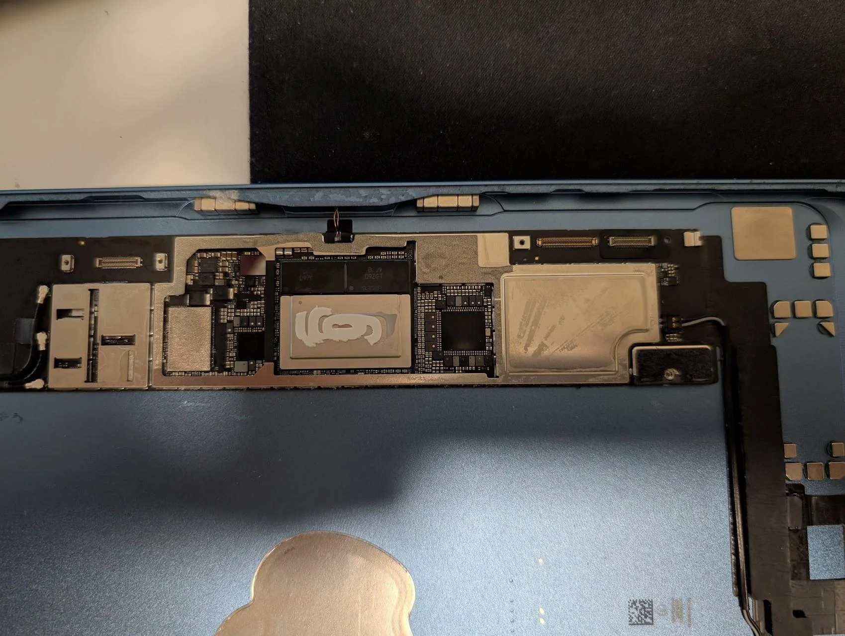

    I opened it up to look for obvious signs of damage but I can't seem to see anything with my untrained eyes. I took my multimeter, set it to continuity and tested the resistors and diodes for any shorts.

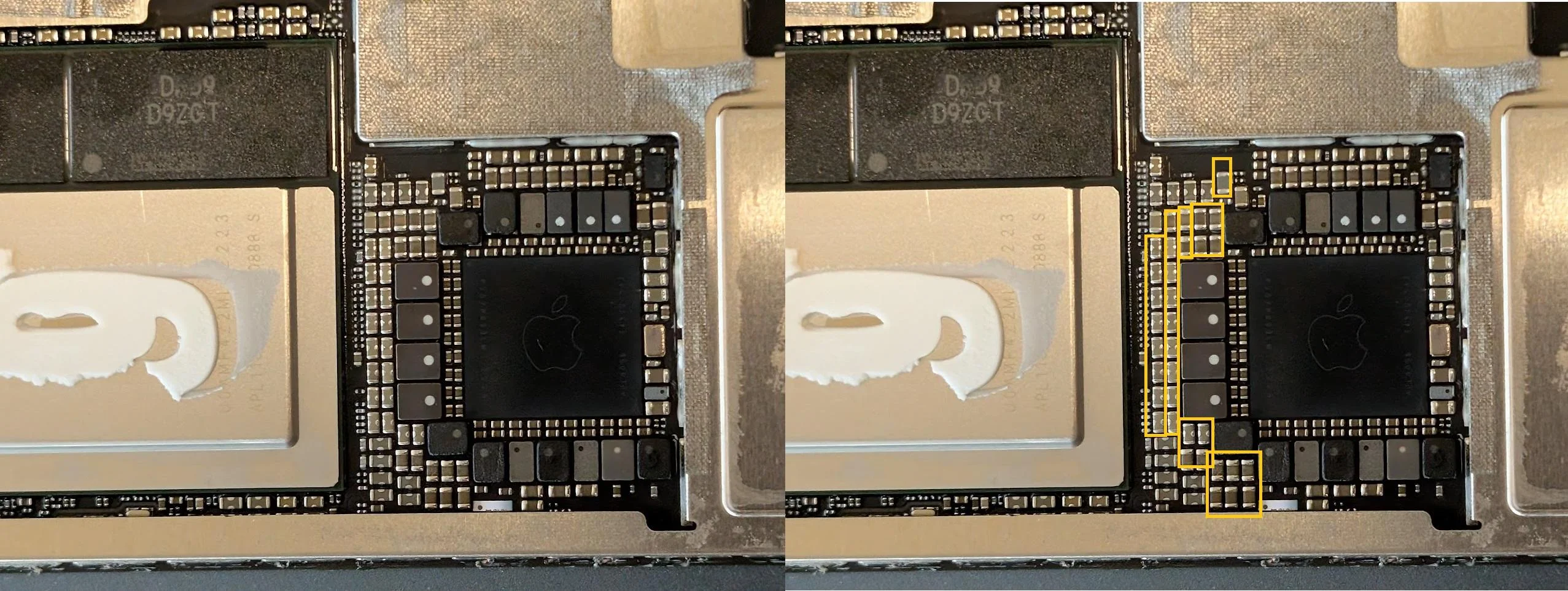

    Below, everything circled or boxed in yellow is shorted. Would anyone have any idea what the issue is based on the pictures and how to fix it? I separated the photos into three sections. The first is the entire logic board. The other two are just zoomed in images of the board. Any help or insights would be greatly appreciated. I also included the unedited photos too. (left image is unedited, right image are the circles to locate the shorts I found)

    So... after I found so many shorted capacitors, I decided rip open the heat shield area and plugged the ipad into a power source and monitor heat. The moment I plugged it into a power source, the 343S00465 chip got EXREMELY HOT very quickly. Additionally, only 1 capacitor near it is shorted. My question is, as shown in the picture, does anyone know if this one bad capacity is in parallel or series? Because if its just that one, perhaps I can just pop it off. Otherwise, I can just replace the 343S00465 IC chip.
    Click image for larger version  Name:	image.png Views:	0 Size:	2.69 MB ID:	3469417
    Click image for larger version  Name:	image.png Views:	0 Size:	1.97 MB ID:	3469418

        Will confirm after my Netflix binge but yes the cap will be in parallel. If it is shorted then it is causing the PMU chip you are referencing to also heat up from this heavy load. Flux and remove this cap with care.
        BTW, review the YT videos on how to use a milli-ohm meter to find shorted caps. It is on my wish list to buy. Will scout for it in my pending travel to Hong Kong in 2 weeks.
