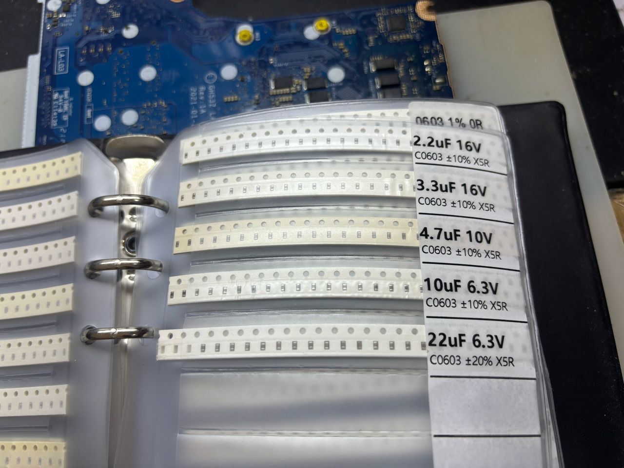

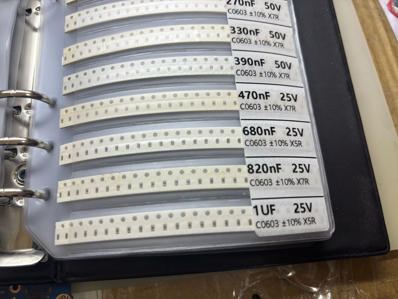

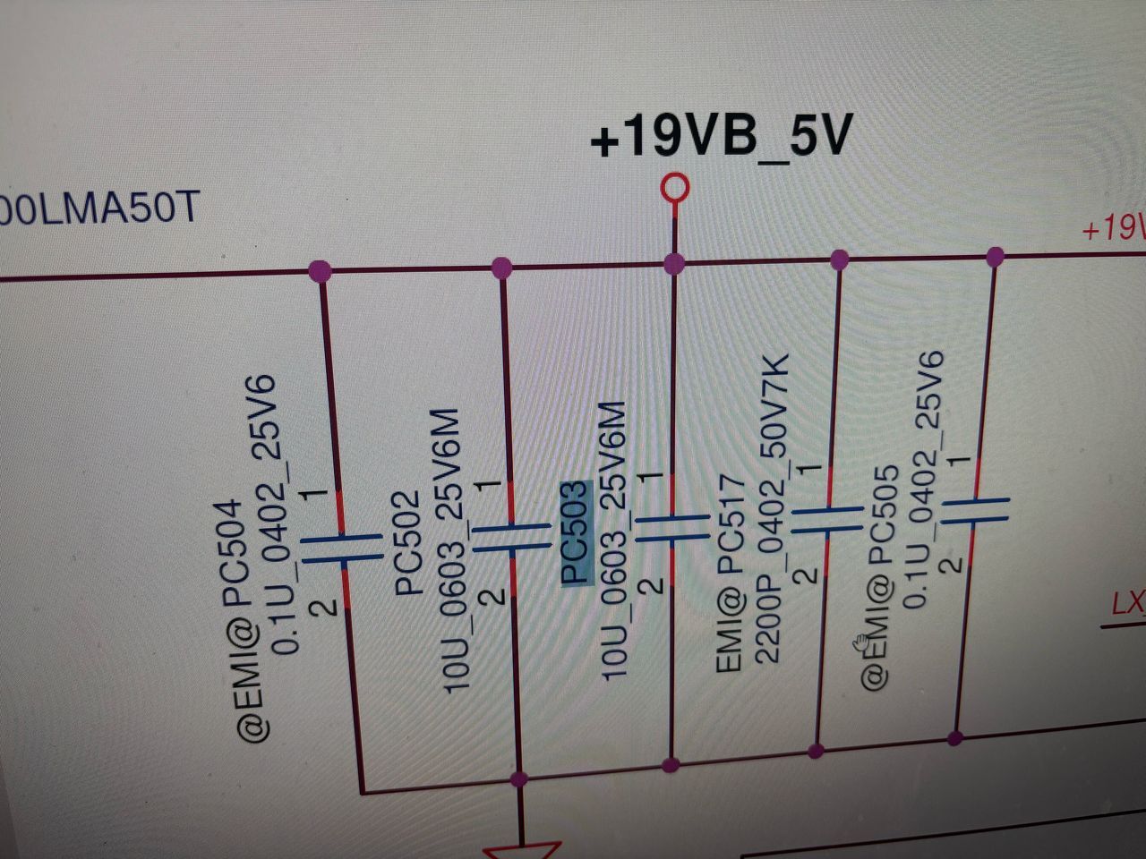

    i just bought this book and want change pc503....on schematic it mention 10uf/25v ....but on the book 10uf/6.3v....is this okay to replace?

    use 25v or 50v

      use 25v or 50v
      thank you sir

        With capacitor replacement, higher value is alloed but lower value is clear NO NO.
        Eg 10uF/25V can be replaced with 16uF/25 or 16uF/50V. The value of capacitance and voltage-both must be equal or higher.
          underrstand...thank you sirr
