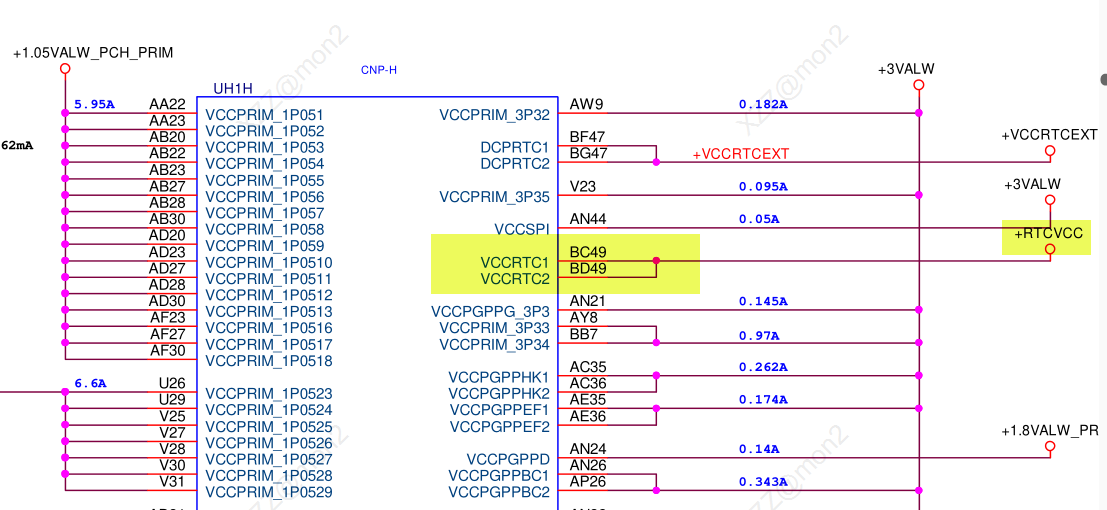

                        With DH2 removed off the board, what is the exact resistance to ground at PCB pad #1 of the removed DH2 dual diode?
                        RH30 is most likely not the fault since this is a 1M ohm resistor.
                        RH50 & RH52 are most likely not the fault since they are each @ 20k ohm resistor.
                        Perhaps UH1 is shorted due to the direct connection of VCC (BC49 & BD49) to the +RTCVCC rail.
                        As a quick test and for giggles, flux and remove the 2 caps that follow the removed DH2 dual diode @ CH47 and CH48. Then test the resistance to ground again of this power rail. Any changes or still a low resistance to ground. If still low, UH1 is probably defective.

                          Hello mon2
                          What do you mean by "Perhaps UH1 is shorted due to the direct connection of VCC (BC49 & BD49) to the +RTCVCC rail." I can't find BC49 and BD49.
                          But you are right, something is still wrong. Was I perhaps premature? I have checked again and have removed
                          RH30, RH50, RH52, DH1, CH47, CH48
                          RH30 PAD2 to earth 4Mohm (seems to be okay)
                          RH50 PAD2 to earth 4.1Mohm (seems to be okay)
                          RH52 PAD2 to ground 2 ohms it leads to PIN 490 (PCH_RTCRST#) of UH1 and to QB6 PAD1 and to CH19 PAD2
                          I have removed QB6 and CH19 and always have only 2ohm at RH52 PAD2. Only PIN 490 of UH1 is still in the rail.
                          At DH1 PAD1 to earth I also only have 1.3 ohms from there it only goes via PCB layer PIN 1172 to UH1 PIN 449 and 429 (+RTCVCC) and to PR212. PR212 has 98k ohms, so it is OK.
                          I would say that the problem comes from the RTC battery, as low resistance values are only present in the +RTCVCC rail of the UH1. I have also measured the RTC battery and it is also dead. I believe that the RTC battery has damaged the UH1. If the RTC battery was dead, it overloaded the +RTCVCC section of the UH1 during operation. Now it remains to replace the UH1.​

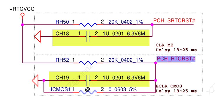

                          • mon2
                            • Dec 2019
                            • 14216
                            See attached.
                            Flux and remove CH18 = 1uf that is also on the same netname of PCH_RTCRST# - see attached partial schematic. Perhaps it is shorted.

                              Hello mon2
                              The CH18 was also removed. In the Net: PCH_SRTCRST# I have 4,2Mohm so no short circuit.
                              I have short circuit only in the:
                              Net: +RTCVCC = 1.32 ohms
                              Net: PCH_RTCRST# = 2.52 ohms
                              I have removed all components in the affected nets. Only UH1 is still present in both. It is possible that UH1 has discharged the RTC battery and not the battery has damaged the UH1. I now definitely believe that the chipset is defective, or what is your opinion?
