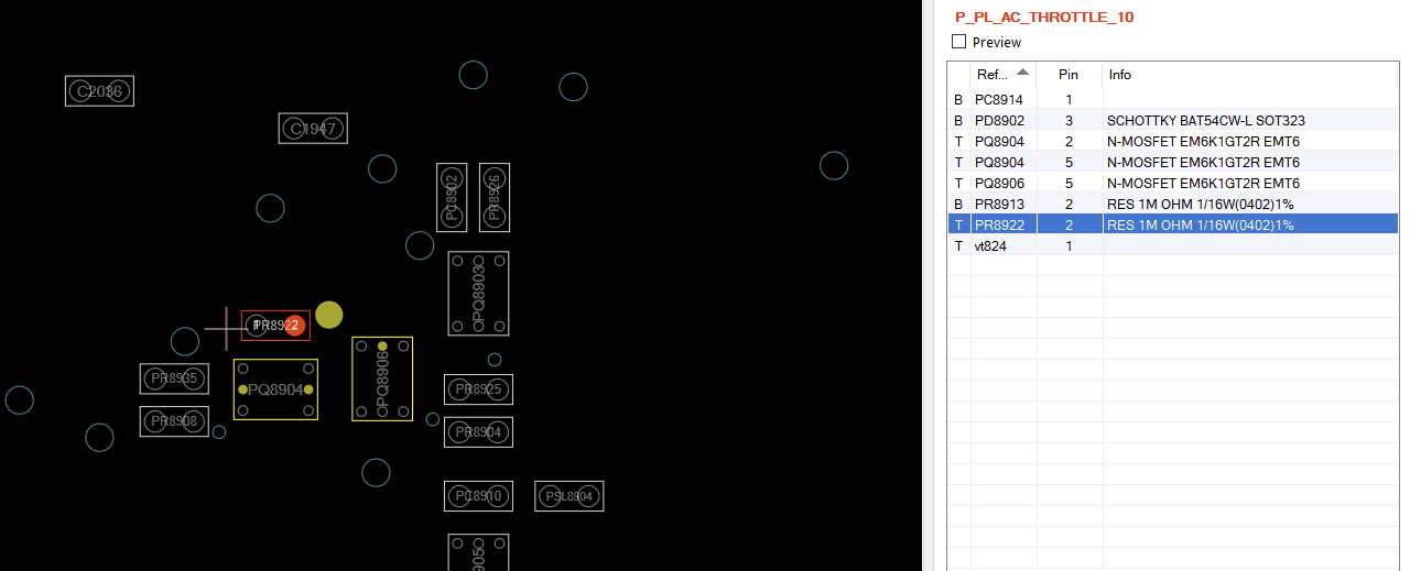

      It would seem I have found the issue: A 1M resistor PR8922 was blown. I replaced it and, to great joy, was greeted by the Asus loading screen. I'll test around some more to see if everything is in order.
