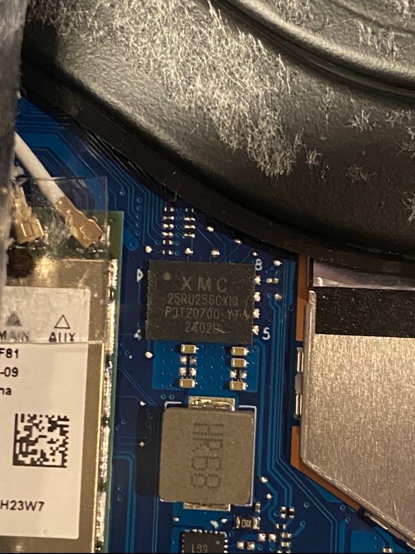

    I have a locked Lenovo Yoga 7 14AHP9 Bios chip. I cannot connect to It with the CH341A clip that I have. It wont hold on/connect. Any Advice or tips on how I can program this thing with a new unlocked bios? I am not experienced with soldering/de-soldering and was told by allservice it doesn't need to be removed, but unfortunately I do not have a pc with a LPT port for their programmer.
    Attaching Picture of said chip.

    There are some adapters to connect to it, but it will be a delicate operation. The best is to remove it and then connect it to the programmer.
    Sorry, but as you say you are inexperienced with soldering, trying to work with this may make things very worse .
