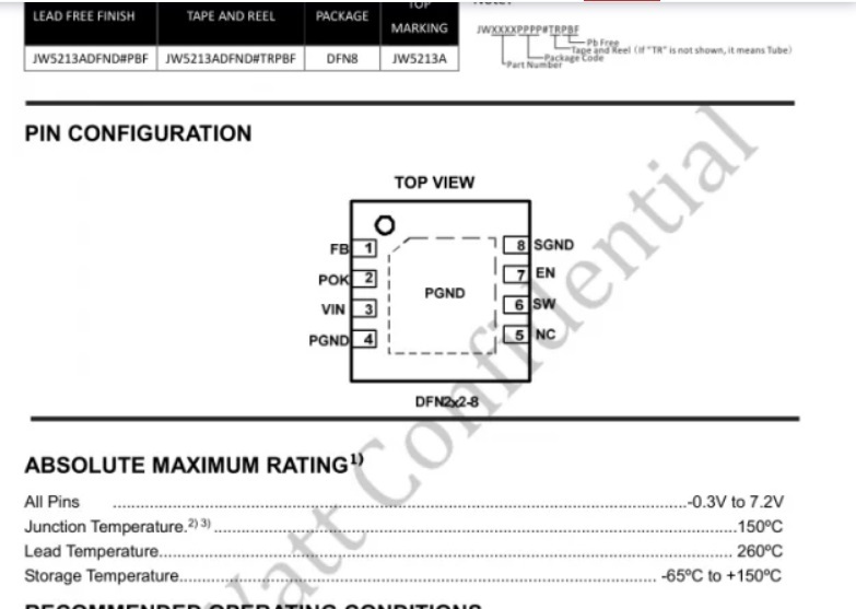

    Hello friends,
    I have this board no boardview no schematic :'( , first 5V chip was heating 100°C +.
    We found 6 ohms on 5V (5V_SUS i guess)
    After injecting on this line we found that a 8pins QFN chip was heating. (Marking " jwfun " " 3a3vy )
    After removing this chip 5V chip stop heating.
    After some diging i think i found a partial match replacement (JWF6 instead JWFU) from a chinese brand "H&Msemi" >> HM3413D
    Pinout match perfectly.
    But i can't find this chip...
    Any idea? for an equivalent or a shop where to find this?
    Thank you.

    Post a picture of the IC, the JW might mean its a Joulewat IC.

      Thank you please find pics attach.

          I read on another forum that its a JoulWatt JW5213L
          8-pin DFN2X2-8 .How many pins does yours have

            Thank you for your time SMDFlea, i think that could do the trick too !
            I'll test and i confirm you.
