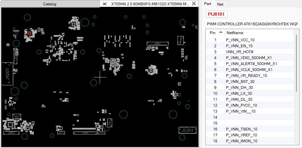

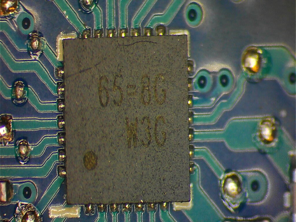

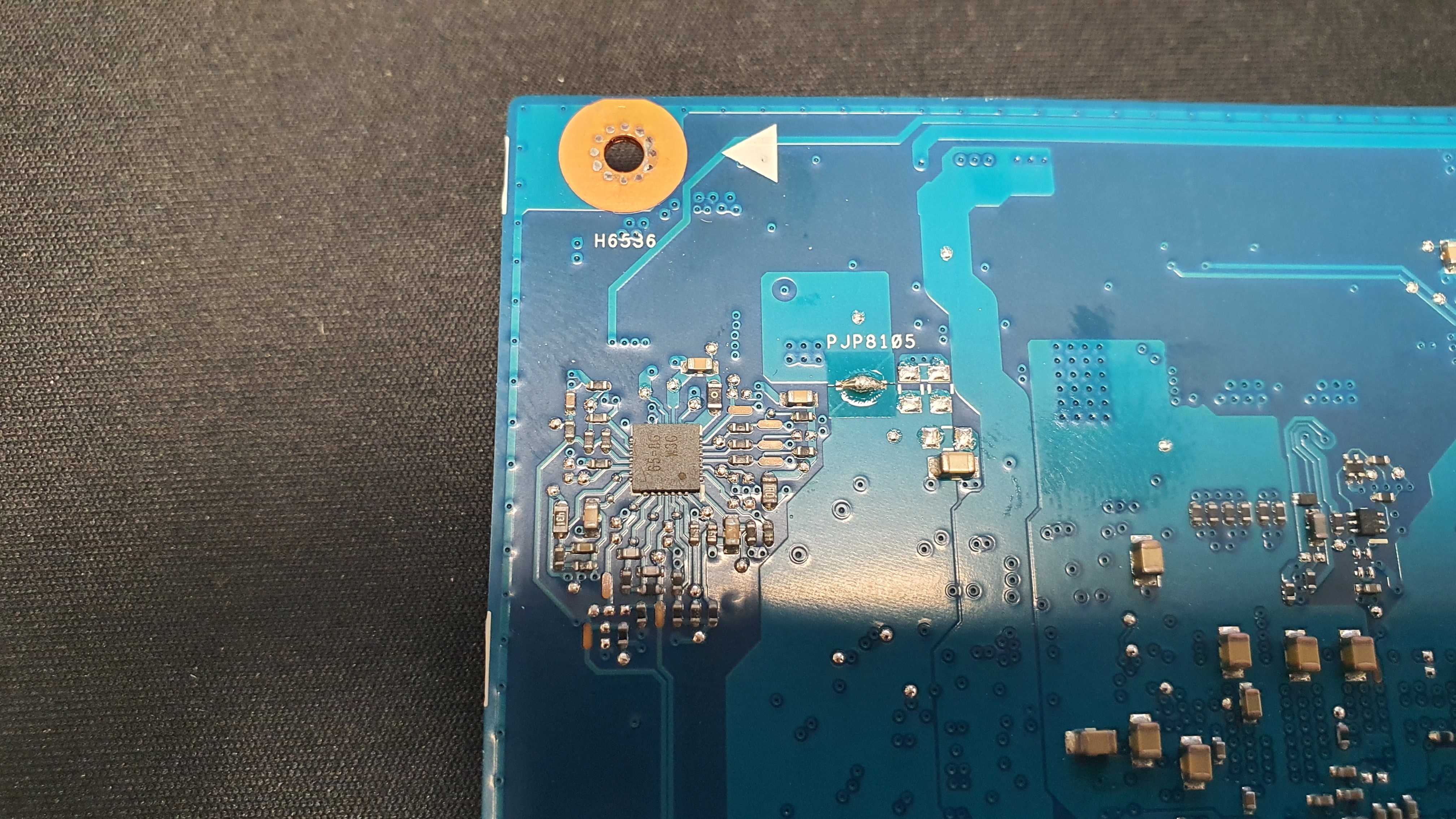

anyone happen to know what chip this is? It's from a Vivobook 17 F705M (mainboard x705ma) and seems to be a PMIC of sort with a crack in it. I initially thought the problem was a blown n-channel mosfet on the other side of the board but even after swapping it I was getting bad readings on the mosfet. that is when i found this pretty boy here. it looks like it says 65=8G W3G but not sure. you can just make out the crack at the top left of the pic
Asus VIVOBOOK 17 F705M (mainboard x705ma) repair
PWM CONTROLLER ATK1602AGQW//RICHTEK WQFN-28Lanyone happen to know what chip this is? It's from a Vivobook 17 F705M (mainboard x705ma) and seems to be a PMIC of sort with a crack in it. I initially thought the problem was a blown n-channel mosfet on the other side of the board but even after swapping it I was getting bad readings on the mosfet. that is when i found this pretty boy here. it looks like it says 65=8G W3G but not sure. you can just make out the crack at the top left of the pic -

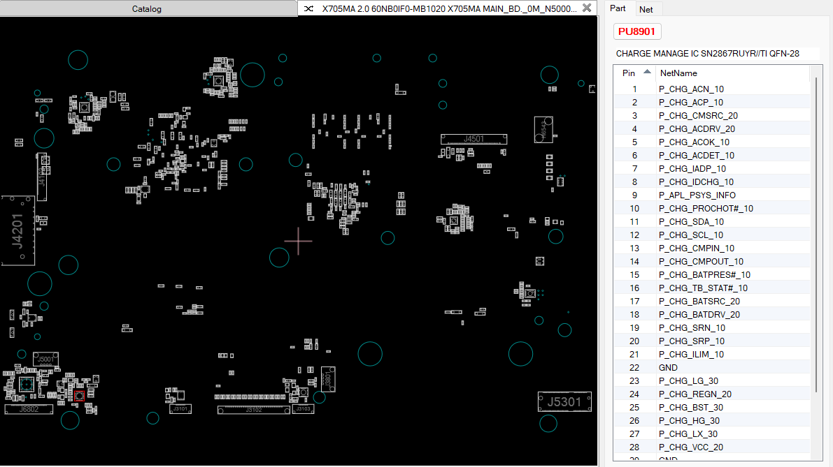

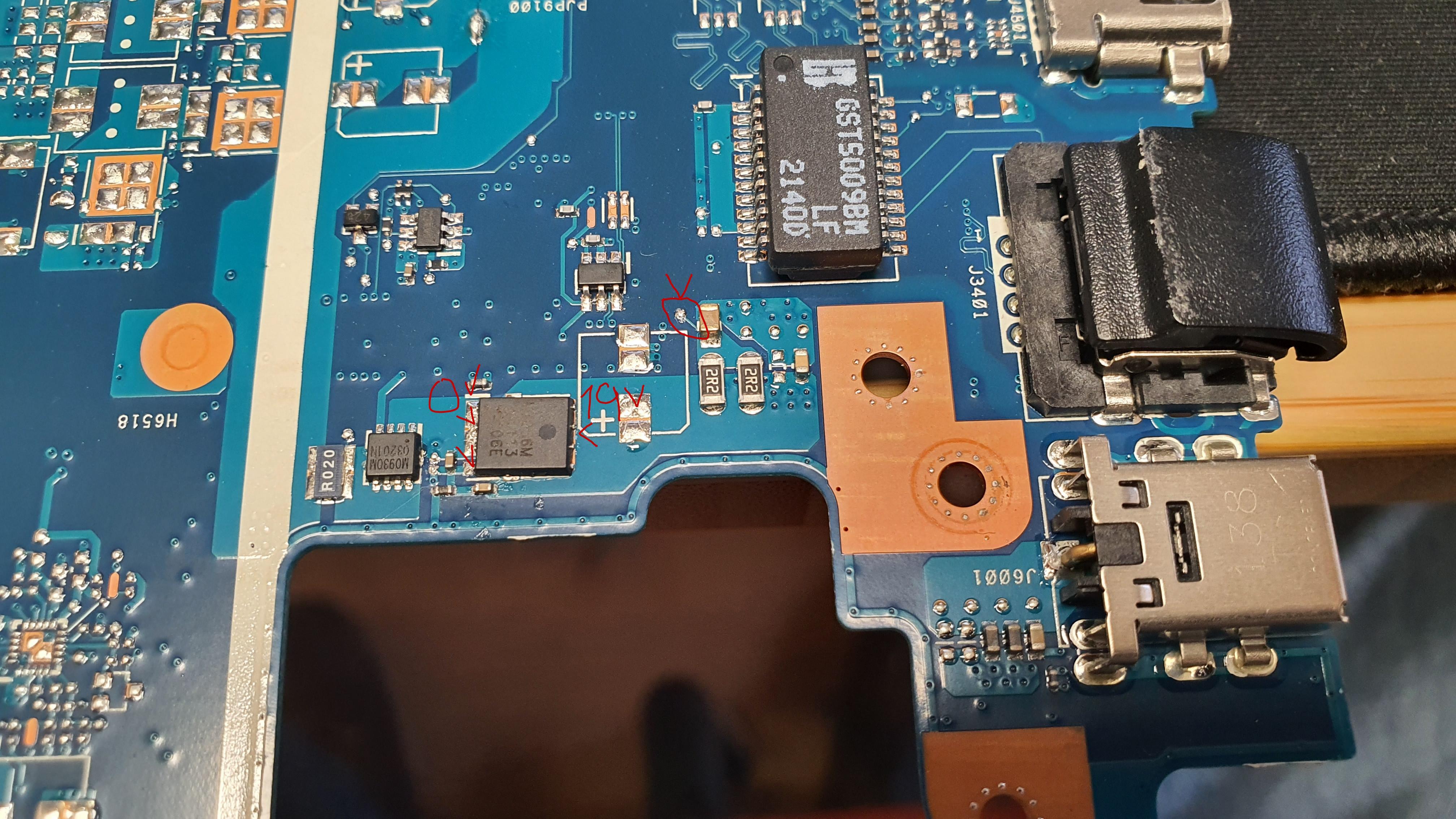

next to the DC in there is a via that goes somewhere. no idea where and it's killin me. I have 19V at the mosfet but 0v on the other side. if I bridge the cap below the mosfet I get all rails. but then it just hangs.
The second pic is where the pmic is on the backside of the board
