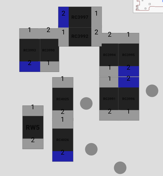

      Sent the pictures of the chip and the area where I think the components are that need to be moved.
      I would guess these are the components that need to be moved:
      RC3997 -> RC3992
      RC3993 -> RC3990
      RC3995 -> RC3994
      RC3996 -> RC3991
      Please let me know if any of this is correct and if not what would I need to do.
      Thank you!

        No. Totally wrong resistors you've chosen.
        RamID1 and Ramid2 will remain unchanged.
        Ramid0 and ram id3 resistor should be moved to make it logic level 1.(shift RC143 to RC142 and RC50 to RC49)
        Your onboard ram is highligted on the 7th row from top in the ram id table on pg9 of schematic.

          On the boardview file from the link in your first reply named "Compal LA-K091P Rev 2.0 BoardView" I can't find RC50 and RC49.
          • mcplslg123
            • Jun 2015
            • 7262
            • india
            Yeh just noticed the discrepancies. Dont know which one is to beleived-the schematic or boardview. The schematic shows something which bdv just doesnt shows and bdv shows something which schematic doesnt show.
            Seems like either of the two is not specific to this board.
            Going by the boardview,
            Shift the following
            01.RC3997 -> RC3992
            02.RC3996 -> RC3991
            does it helps? Please confirm
            • Kukzi
              • Dec 2024
              • 5
              • Serbia
              Yes it helps, I will attempt it when I have a bit more free time since the components are much smaller than I expected.

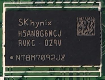

              Looking at the ram table based on the ram type I got (H5AN8G6NCJRVKC) all positions are at "0" and for no onboard memory all of them would have to be "1" ?
              Or is this not what the table represents ?
              Thanks again for all the help.

                Going by the suffix "VKC" it does seems like hynix 4gb and not 8GB as i assumed.
                As long as the suffix on your onboard ram is VKC and its 4gb hynix, then proceed with what you listed at post#3.
                My apologies for not looking carefully enough for the suffix.
