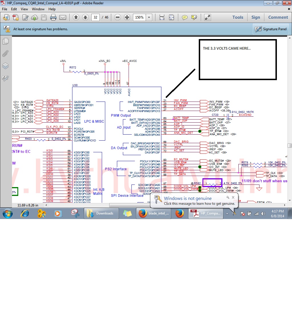

    Hi guys.. I received this laptop cq40 with dim display.. I thought it was a back light problem but suddenly its not.. Here are the first aid i try..
    Try other lcd- not good
    try other inverter-not good
    try other flex cable not good

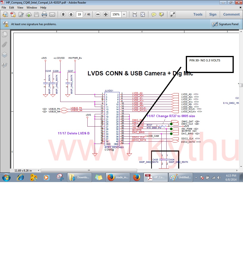

    i decide it was a board problem.. I check input voltage on inverter and it was a 19 volts present but 1 thing i notice, the 3.3 volts on pin 30 on jlvds1 connected on inverter was missing.. I locate the path where 3.3 came from and i found u30 sio chip pin number 21 and no 3.3 volts is present..
    Can anyone help me how to decide which parts need to replace.. Thanks ypu guys..

      i did try in a post to give 3.3v to a pin like that and it start the light but i had problems like :
      it gives a red tone on the screen.
      so i guess it was the SIO chip problem.
      try to Inject voltage there; there are many 3.3v that starts with the notebook.
      inject or solder a wire there.

        sir can u give me a parts that give 3.3 volts to inject on 3.3 volt on that pin?
          Re: Cq40 dim display
          probe around the connector dude!
          power up the notebook and check.

                      i measured 3.3volts on pu102 the pin 1 give 3.3 volts but this is always voltage.. i thouht they can damage the board when i connect to this pin right?
                        Check voltage on pin 112 of U30. If voltage exist problem with U30, if not, problem with MCH.
                        To supply 3.3v, get voltage from Q7 pin 3 (source pin)
                          sir there is 3.6 volts on u30 pin 112.. now i try to put jumper on q7.. thanks sir

                            I repaired one presario v2000 with inverter problem, in it inspite of 3.3 v i provided 5v to pin no 2, this enabled the inverter ckt and hence the ccfl lit up.
                              Yes, you can do that in some inverters. But you do not know the specs of that specific inverter.

                                Before doing the bypass, I should reflow U30. Maybe this will bring back the 3.3v to the enable pin.
                                  actually sir that board is working fine before.. the only problem is in the dc port..after i repair dc port i try to connect lcd connector to the mainboard but i forgot to disconnect the power adapter.. when i connect lcd to the mainboard the charging indicator goes off and unable to power on until i try several attempt to power up until the power is back but unportunately disply become dim..

                                    sir big thanks to you.. i follow your instruction and display become ok again but i have encountered another problem. windows booting is too long.. i try to replace memory and hdd but still the same..
