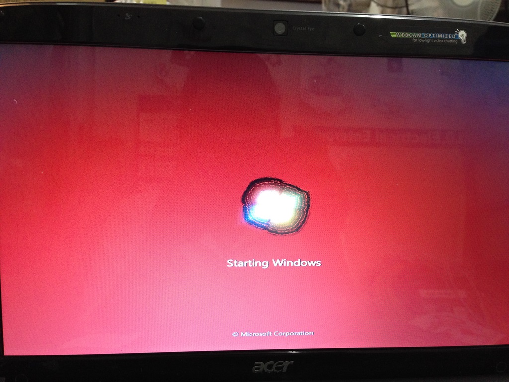

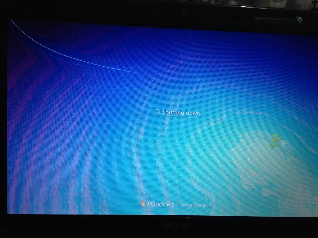

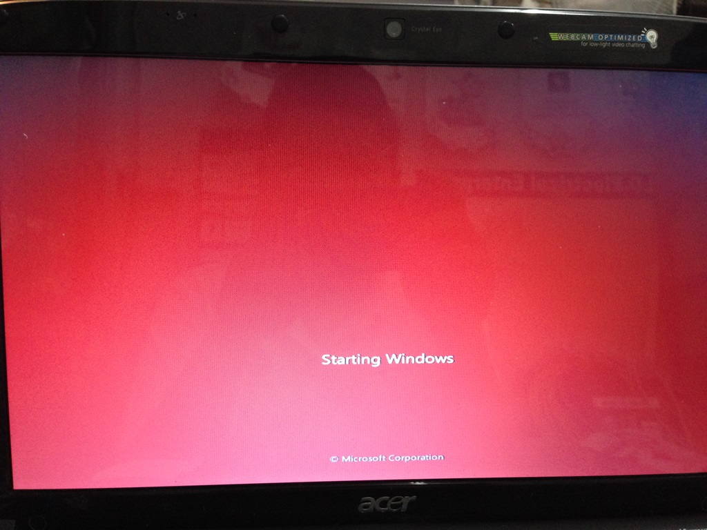

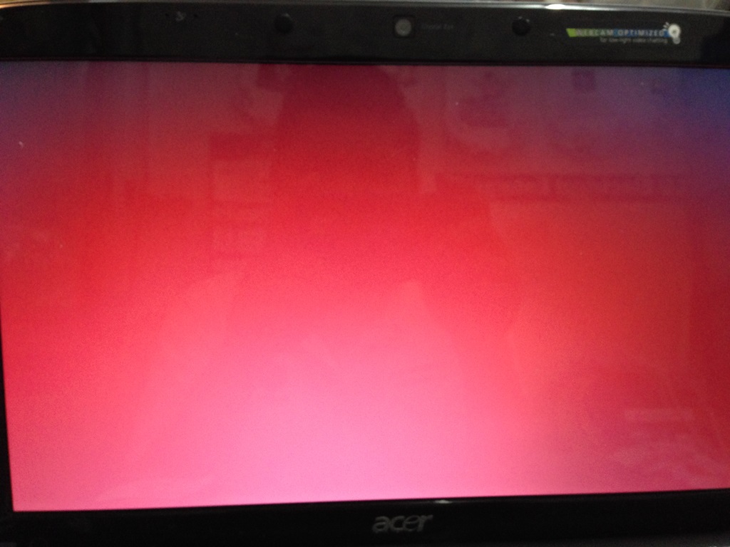

        help my 4736z bfor i change the nec tokin to 4 pcs 330uf is cannot on. after i change notebook can power on and can login to windows. but just the display got problem. all background become red color only.
          Re: Acer Aspire 4736z no display on battery
          Redo nec tokin.

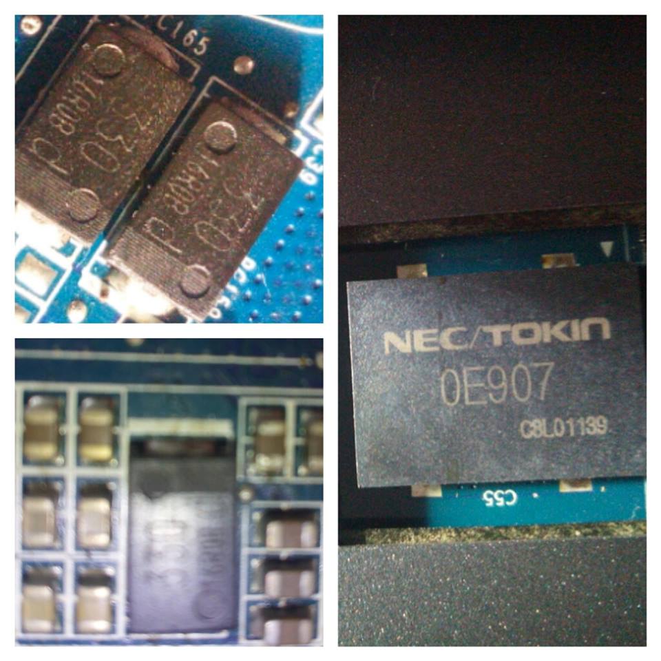

            i have an acer 4736z with power but there is no display, Im wondering if I can replace the nectokin 0E907 with 4 pcs 330 d capacitors? how should I position the capacitor? cant find the + and - signs :x
              Probably you should upload a photo of the board and we can help you
              -David VanHorn
                i attached it now sir. hope you can help me :x i still dont remove that capacitor from that dead mother board and i still not moving the nec
                  outer lines are positive. yes 330d will do. but be careful. there are 2 points under that cap, you need to be careful not to put solder on them. It will cause some power issues.
