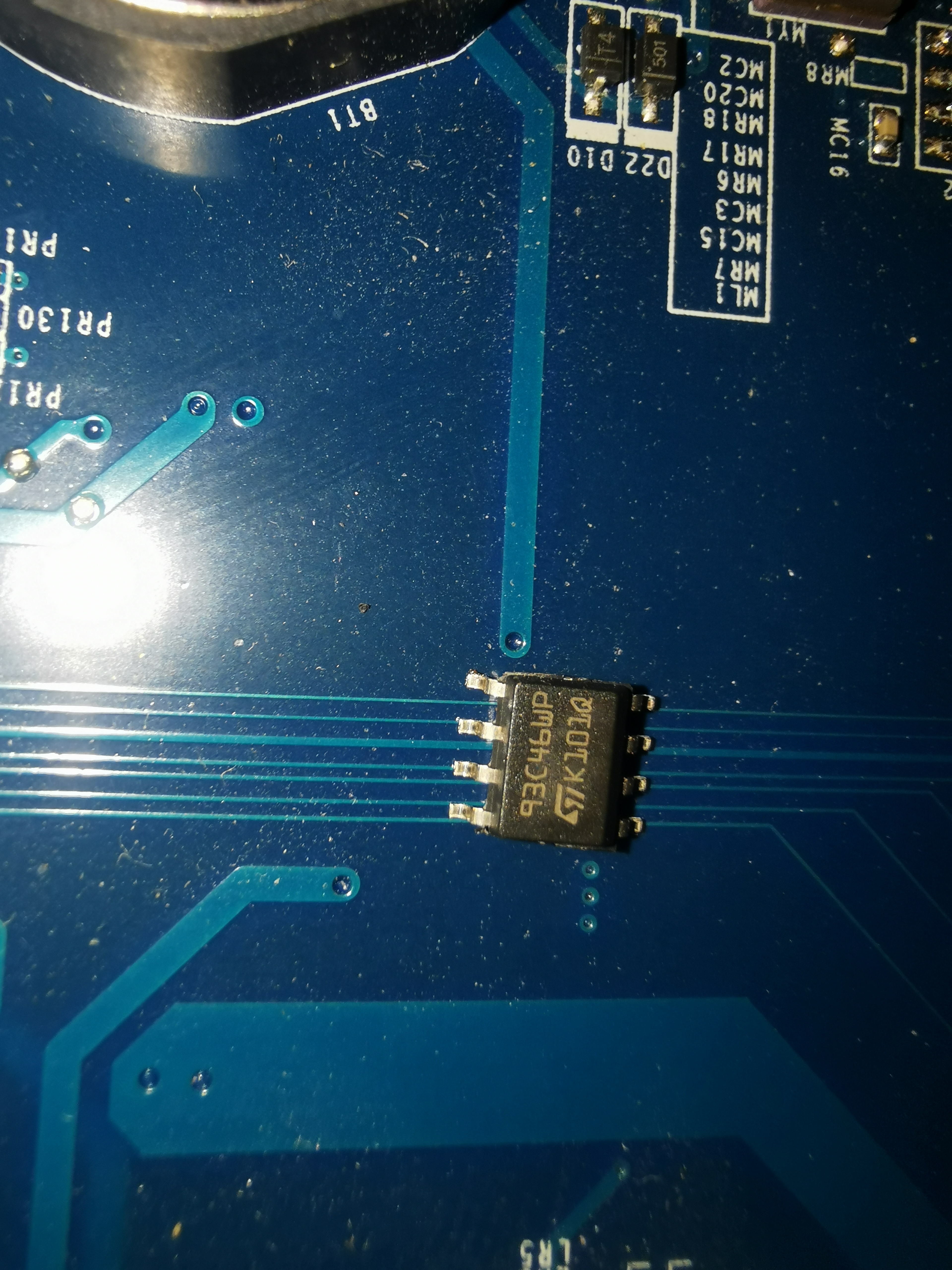

    I have allot of donor boards, how to know which i can use ? My acer has the pk5n2ea
    • mon2
      • Dec 2019
      • 14672
      The component in the posted pic is an EEPROM - not a mosfet. Hunt for mosfets of same physical size and they should reside near the DCin power connector of each donor board. Then search for their markings using Google to locate their datasheet. Confirm the type is the same. That is N-channel must be replaced with N-channel. P-channel must be replaced with a P-channel mosfet.
