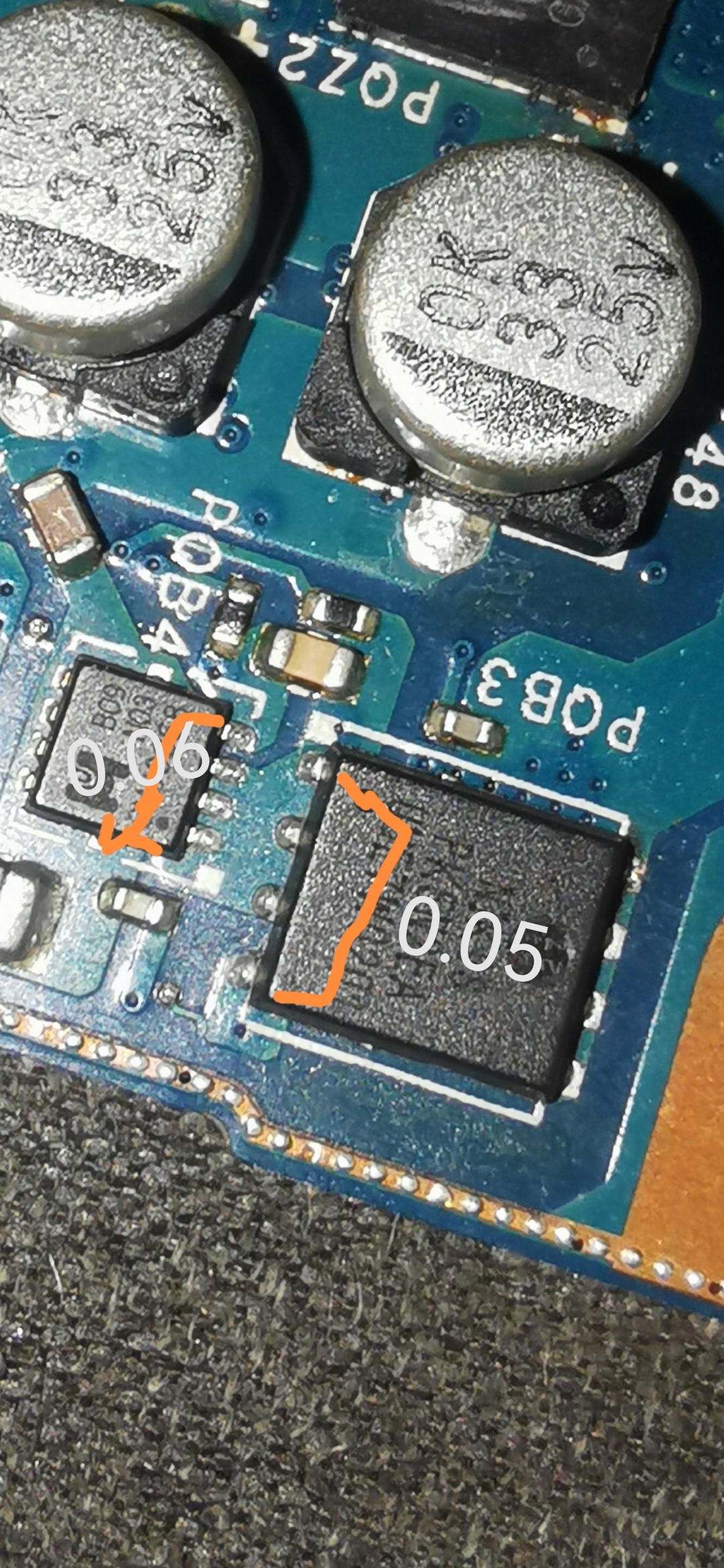

          All these things get hot circled, second mosfet most... (Image)
          first mosfet 1 probe to ground all pins 500 ohm range
          2nd mosfet 500 range input side other side all 4 pins 003
          What does this say?

            Not the proper way to measure a mosfet.
            Set your meter to atlest 200K or more scale.
            Put black probe on pin1 and then measure resistance between
            PIN1 to pin4
            Pin1 to pin8
            Pin4 to pin 5
            Repeat it for both dc-in mosfets.
            However, i strongly feel your main rail is shorted. Confirm that by measuring resistance to GND on CLR located just after the dc -in mosfet.

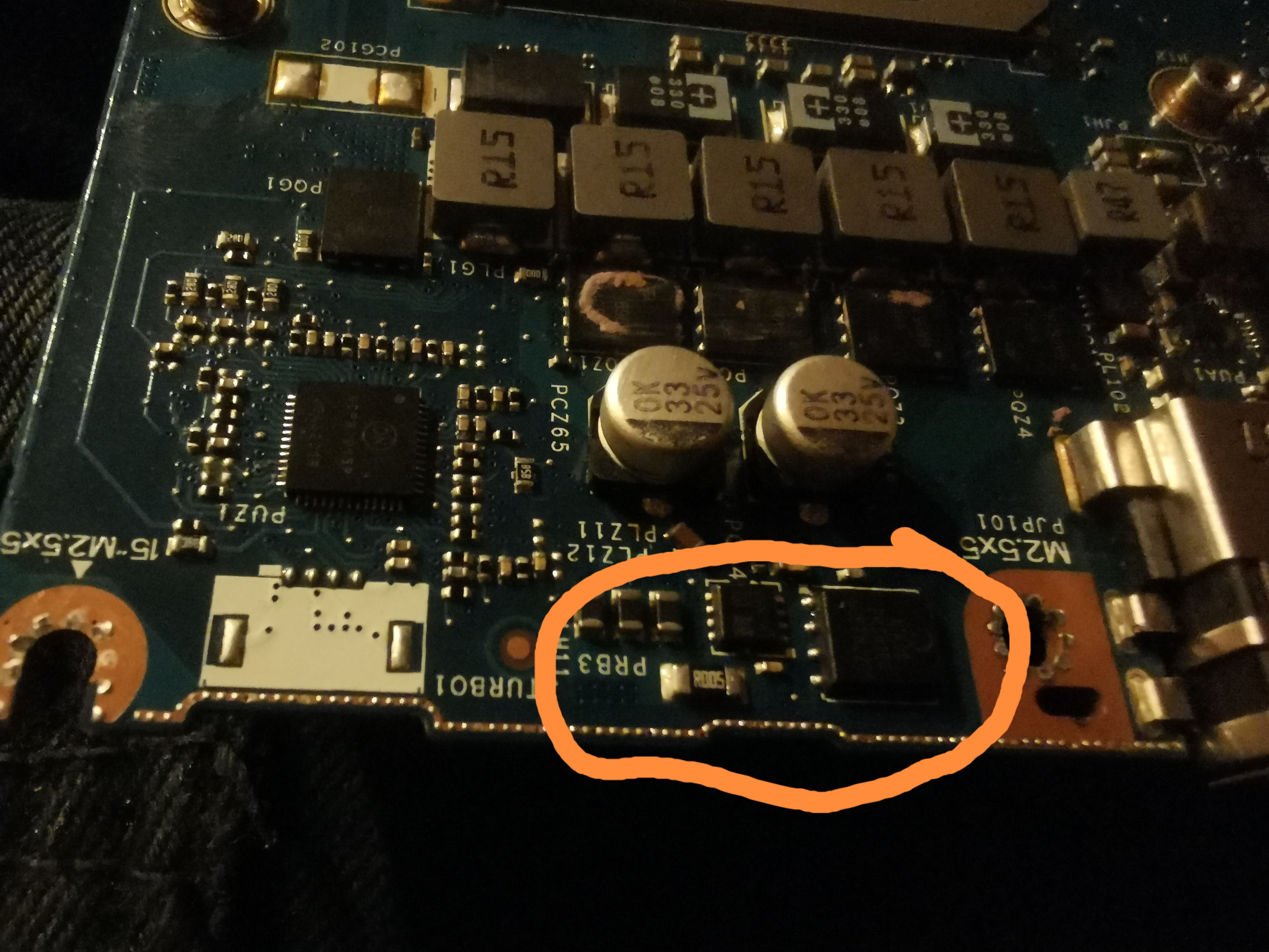

                  what is the resistance on the PRB3?

                    Prb3 is that clr ? 005 in diode mode

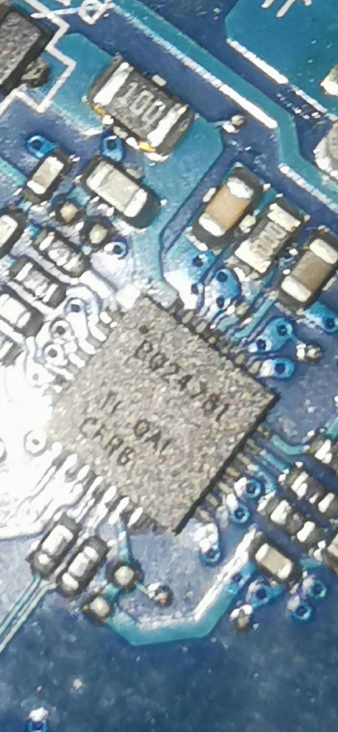

                            See section 5 (top view) here:
                            https://www.ti.com/lit/ds/symlink/bq...lsrc%253Daw.ds

                              Thank you i first need smaller probes...

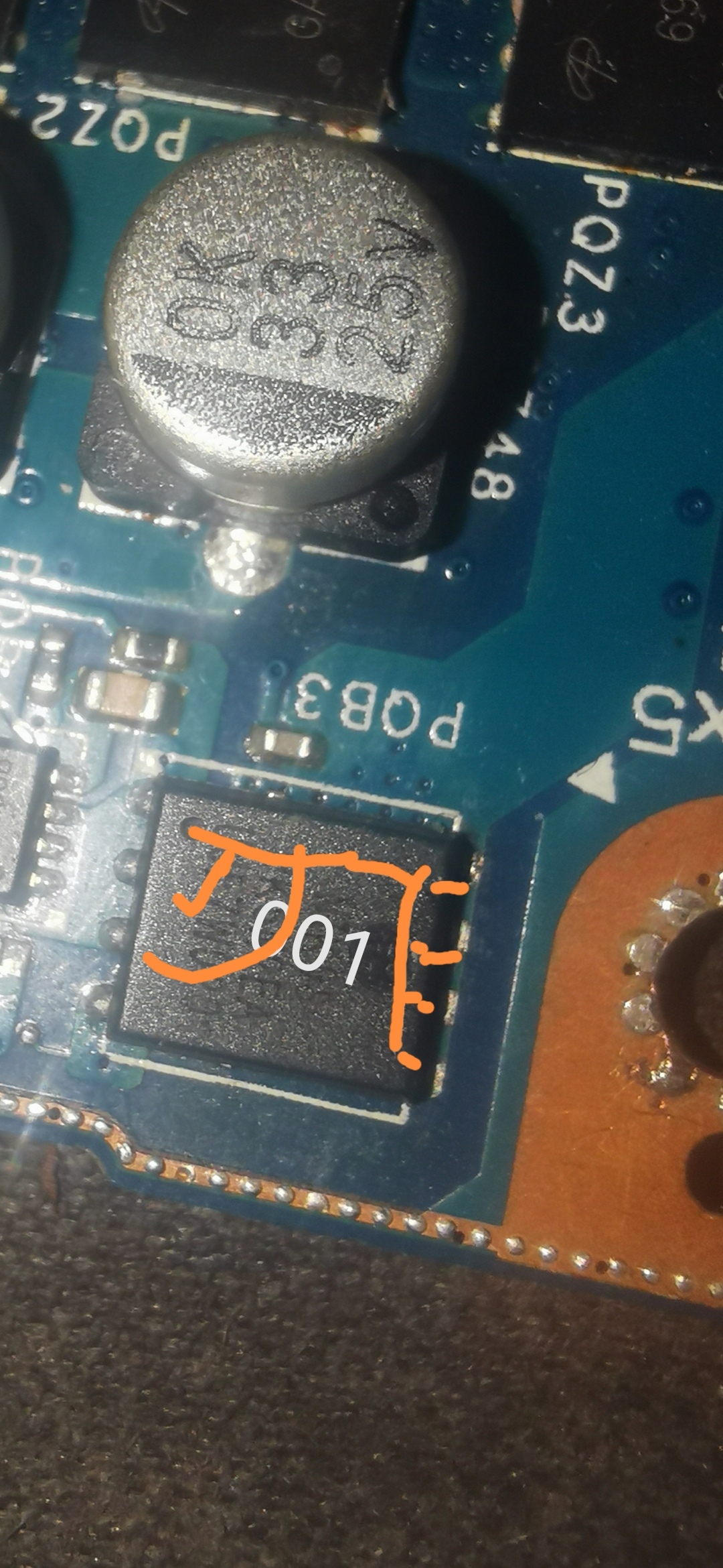

                              For the first mosfet is it normal to have pin 1 (with dot) connected to all other pins on other side ? 001 in diode mode
                              Theres only resistance between the dot and gate 005 Click image for larger version

                                • 14660
                                Use only resistance mode. What is the resistance in ohms? 5 ohms? Definitely shorted. Each resistance check should be hundreds of k ohms or higher if the part is not defective. Seek out a replacement. They are cheap and commonly found on most motherboards. Share the topside markings of this and also the replacement parts for a quick review. BQ chargers will often use N-channel 30v rated mosfets (5x6 size). No power to the board (only to the people) when using resistance or diode mode checks.
                                • Mailf
                                  • Dec 2024
                                  • 15
                                  • Netherlands
                                  Yes in diode mode source to gate 005
                                  Source (dot) to drain all 000
                                  • mon2
                                    • Dec 2019
                                    • 14660
                                    Diode mode testing is different than resistance mode testing. The shared diode mode measurements make it clear that this part is defective.
