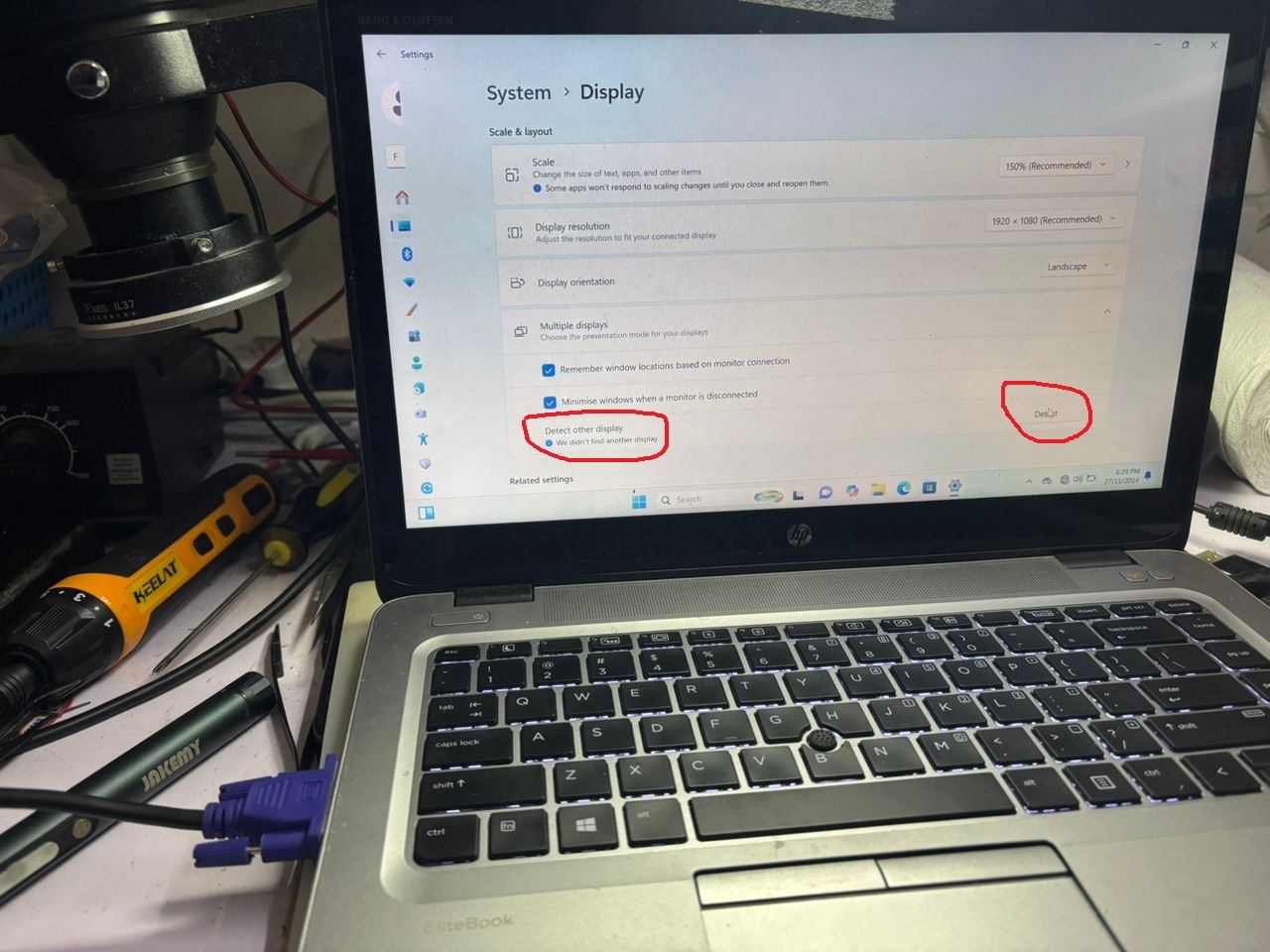

      there no issue on device manager sir...i try reduce resolution on internal but also same result...it saying "We dint find another display"

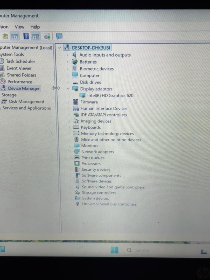

          if symptom persist. there maybe issue in your internal display.. try to look at device manager particularly the display section try to screen shot that and post it here

            i already try another other monitor but problem still persist....i think all good on driver also

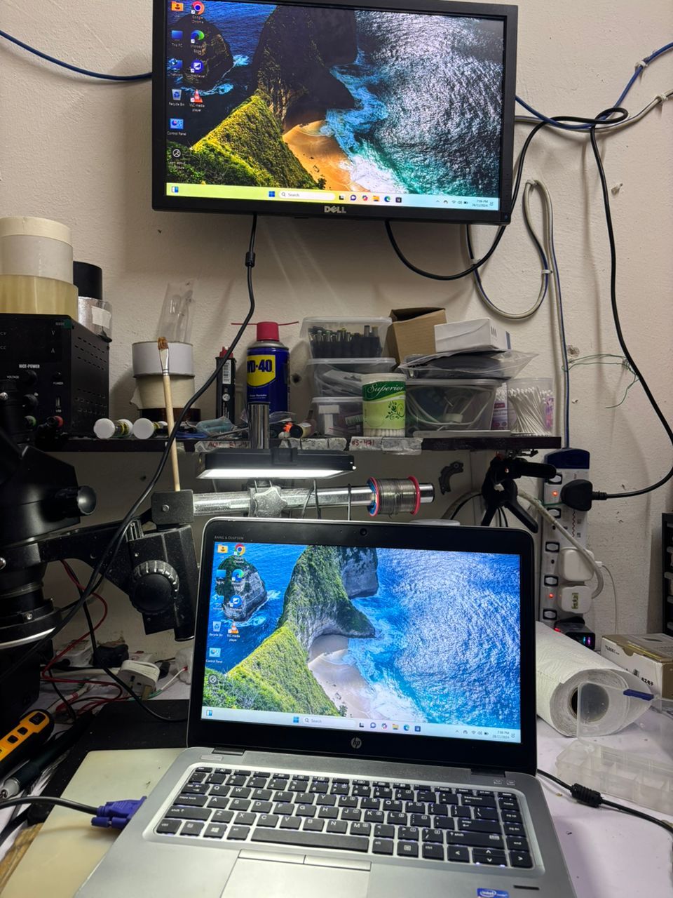

                        this is different laptop, 840 g3 with i5 6th gen but board size and type is same.....work perfectly on external monitor....customer laptop 840 g4 is i5 7th gen, both port VGA and displayport not working

                          Turn the scaling back down to 100% for the moment. The VGA is on a daughter board, check the ribbon cable ,leave it unplugged and try the DP again. Are you using a DP or HDMI monitor and are you using a DP to HDMI adapter

                            i already try scaling down 100% but same result also....
                            i have 2 monitor....1 monitor with 1 vga port....and other 1 have hdmi and DP port....im using direct cable VGA and DP, no adapter...but also same result no display on external

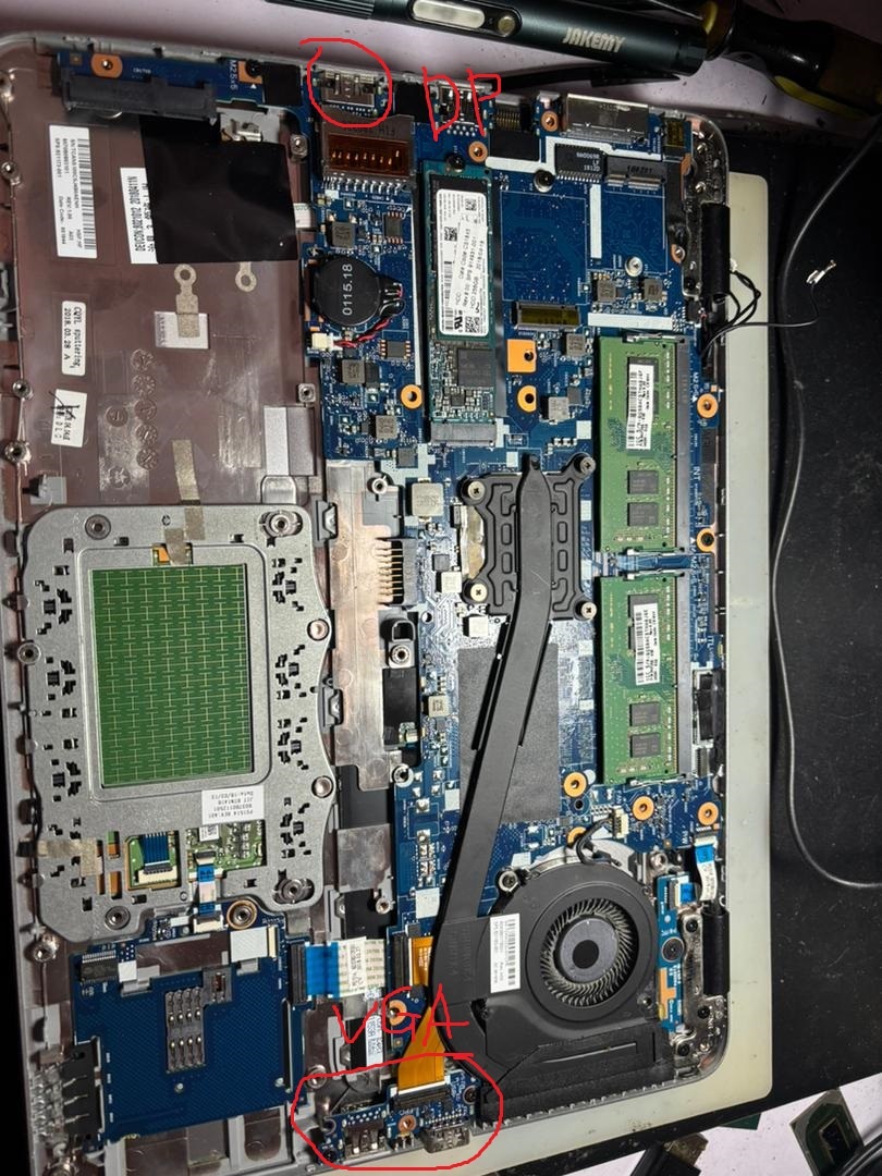

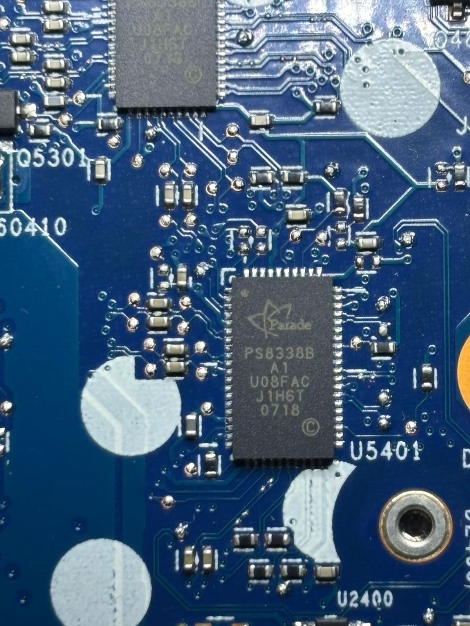

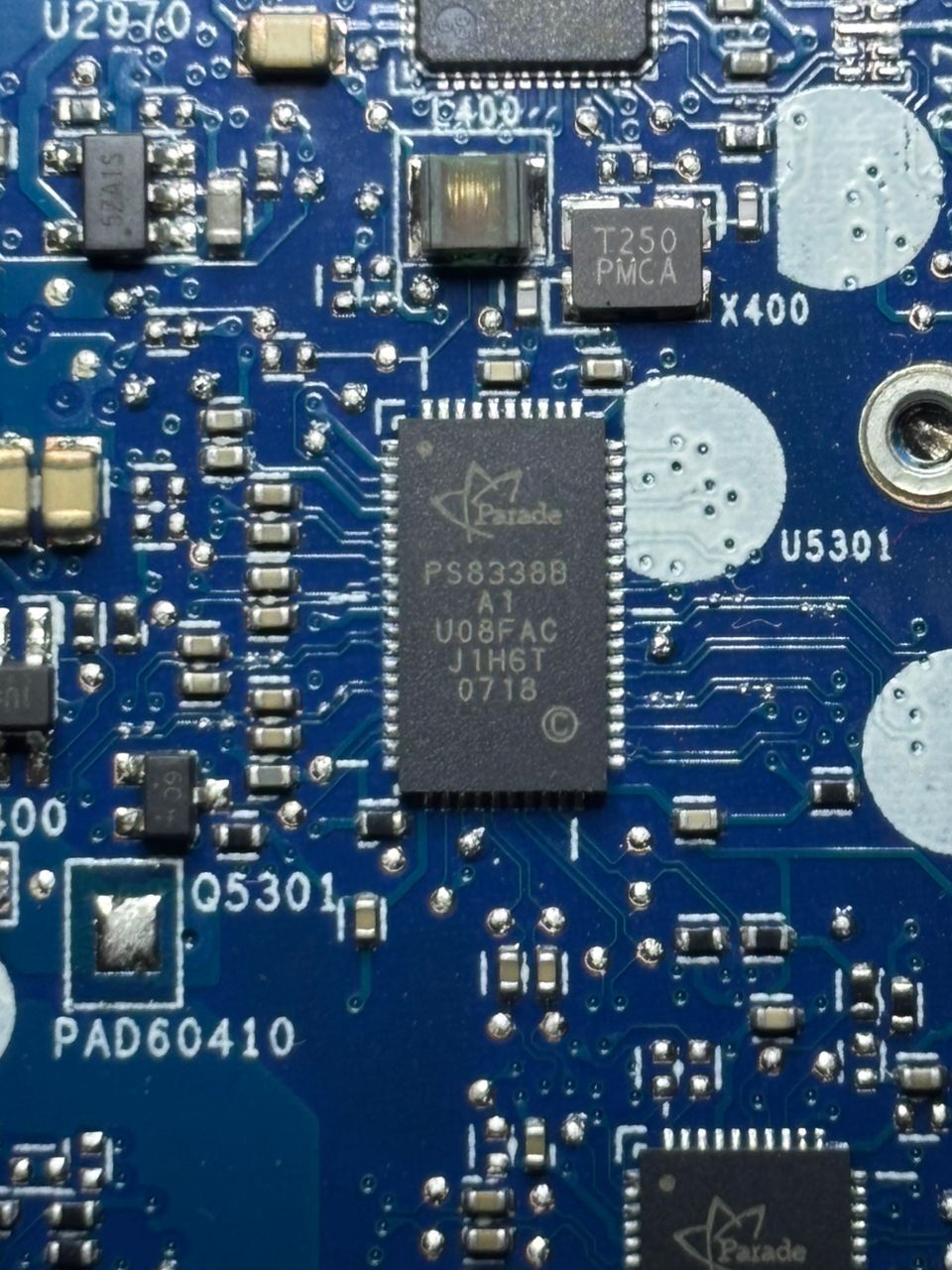

                                Have a look around the motherboard for a parade multiplex chip ,similar to the one in image, look for the parade name or logo, if you find one post the part number or pictures

                                  got 2 same ic like this sir...same number​
