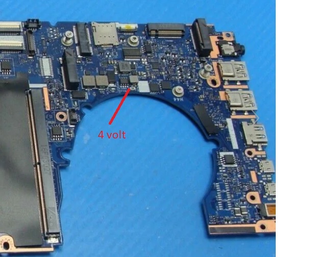

    laptop hp zbook g3 la0c381p no power

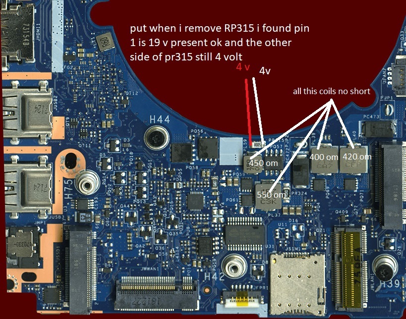

    PR315 pin 1 and 4 there is 4 volt
    when i remove pr315 pin 1 and 2 = 19 volt
    but pin 3 and 4 still 4 volt
    pl59 = 450 om
    pl39 = 400 om
    pl40 = 420 om
    pl37 = 550 om
    no short on there coils

          hp la-c381p no power
          when i put adaptor jack the led light ok white
          when i measure on pr315 there is no 19 v just i found 4 v . its should get 19 v on pin 1-2 and get 19 v on 3-4 pin i found just 4 v
          when i remove this resistor ( pr315 ) i found on resistor pin 1-2 19 v ok but pin 3-4 found 4 volt
          i remove adaptor and measure all coils after resistor no short
          when i connected power supply no A ( 000 A )

                Resistance to GND on pin3-4 of PR315?(while its removed)
                  when i press resistance it give me short after 10 sec give 400 om

                      Review the 2nd DCin mosfet. Remove all power. Meter in resistance mode.
                      Measure the resistance across this Dcin mosfet:
                      source(1-2-3) & drain (5-6-7-8)
                      source (1-2-3) & gate (4)
                      gate (4) & drain (5-6-7-8)
                      What is the resistance measurement of PR315?
                      With PR315 on the board, measure the resistance directly on pin # 1 to pin # 2 on the charger IC - measure at the contacts on the BQ24780S device.
                      Then measure the resistance to ground on pin # 2 of BQ24780S again.
                      Post each measurement.

                        If the rrsistance to GND measurement is correct at 400 Ohms on pin3-4 of PR315,then your main 19V rail is shorted.

                          thanks mon2 and mcplslg123
                          solved
                          problem in PD5
