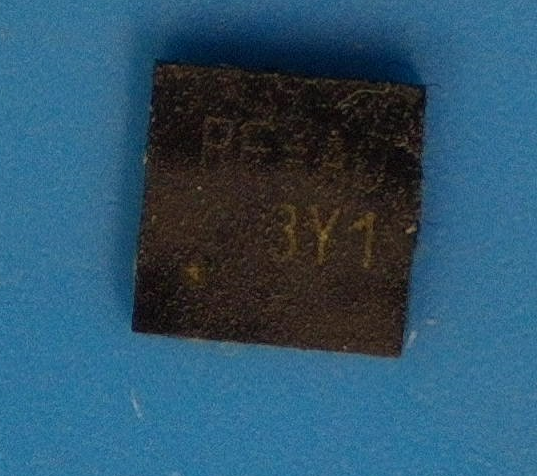

        I found the cause of the current dropping to 3V, but I can't find the Richtek code.
        I'm using a boardview just as help "nm-d601" and looking for the pu6201 corresponds to RT6585CGQW(3H = 2M), but its code does not correspond to the same one I removed from the motherboard which is RE=AD.
        I wonder if they will be compatible, any ideas?

          https://www.richtek.com/assets/produ...DS6585C-02.pdf

            are they compatible? RE=AD and 3H=2M

              Update, replace the IC with a compatible one (3H) and the problem continues, I am checking the signals of that IC and it seems that it turns on and off the 3V.
              The EN signal that comes from the KBC is also intermittent and 3VALV to,
              Any signal that I should check?
