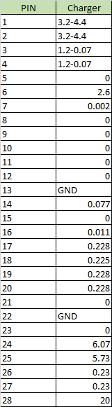

      The measurements are as follows
      I put pins 1 and 2 like this, because they change voltage very quickly from 3 to 4

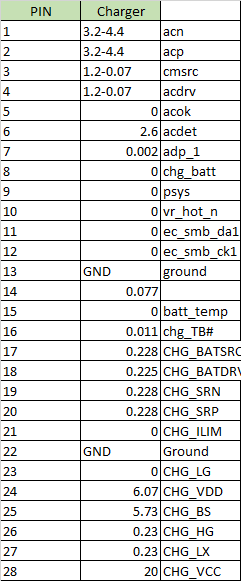

          Corrected list, measurements are without battery connected, no peripherals and corresponds to a BQ24780S

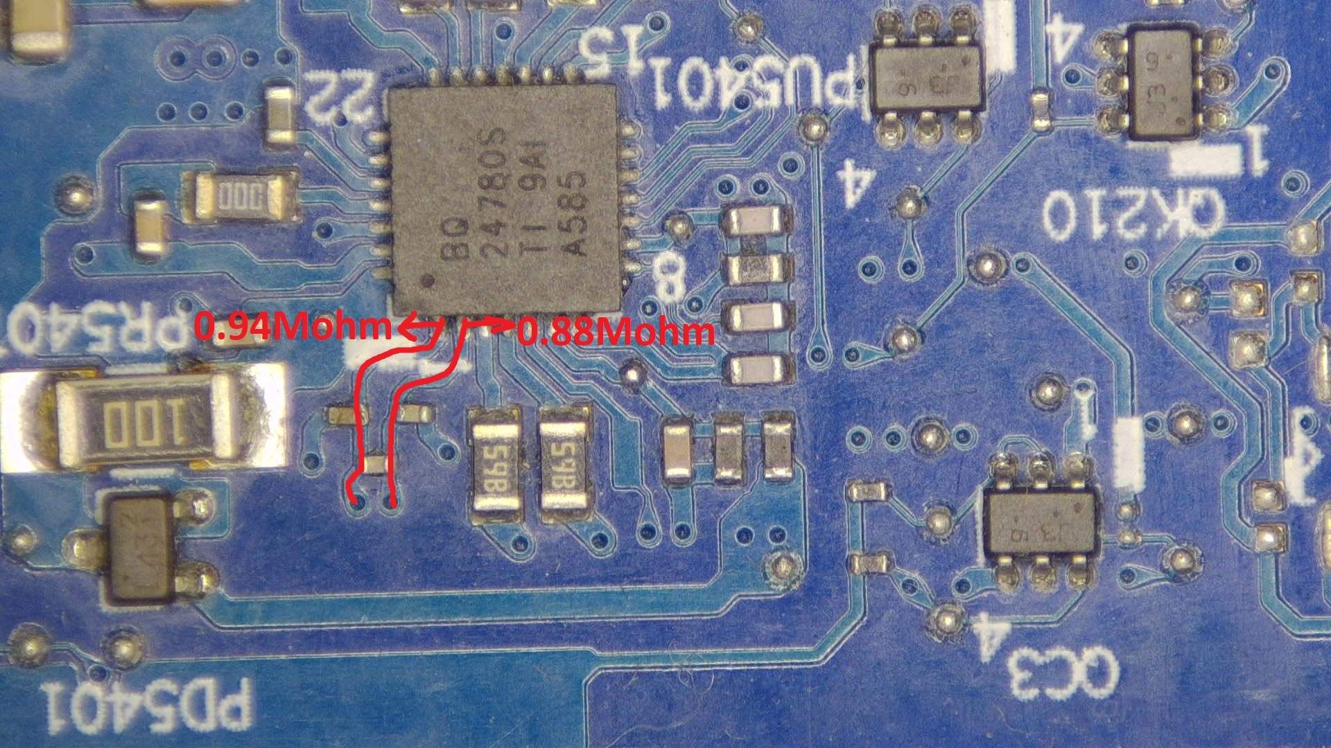

                measurements of pin 1 and 2 of charger ic
                black terminal to ground and red to pin 1 and 2 gives 30k and going up
                red terminal to ground and black to pin 1 and 2 gives 30k and going up

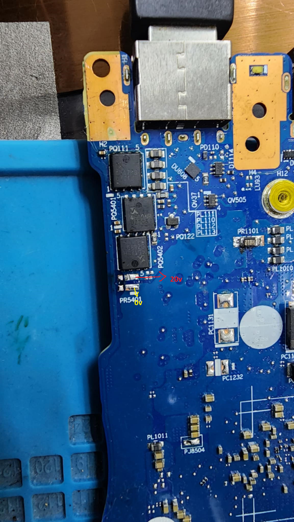

                  Remove the 2nd dc-in mosfet and apply power .Does pin4 of 1st mosfet is now 25V?
                  i remove the sence resistor and give me a 20V

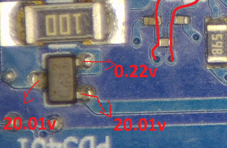

                          The first p-channel mosfet has a voltage of 8.9 and the second n-channel has 25v, both on pin 4. In the following image I explain it better

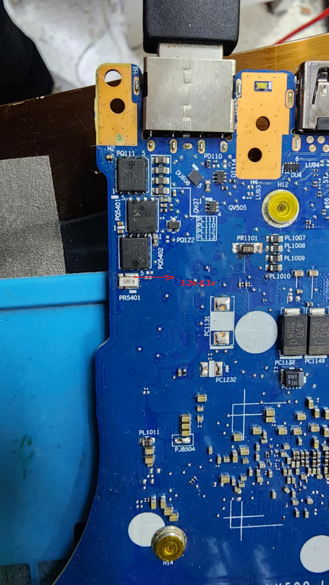

                            What you have written is just half the info reqd. So if u remove CLR,20V is reaching CLR but what's the voltage on pin4 of dc-in fet?
                            Whats the resistance to GND on CLR pin 3-4(where u have zero volt)?
                            These are the measurements on the entry lineClick image for larger version
