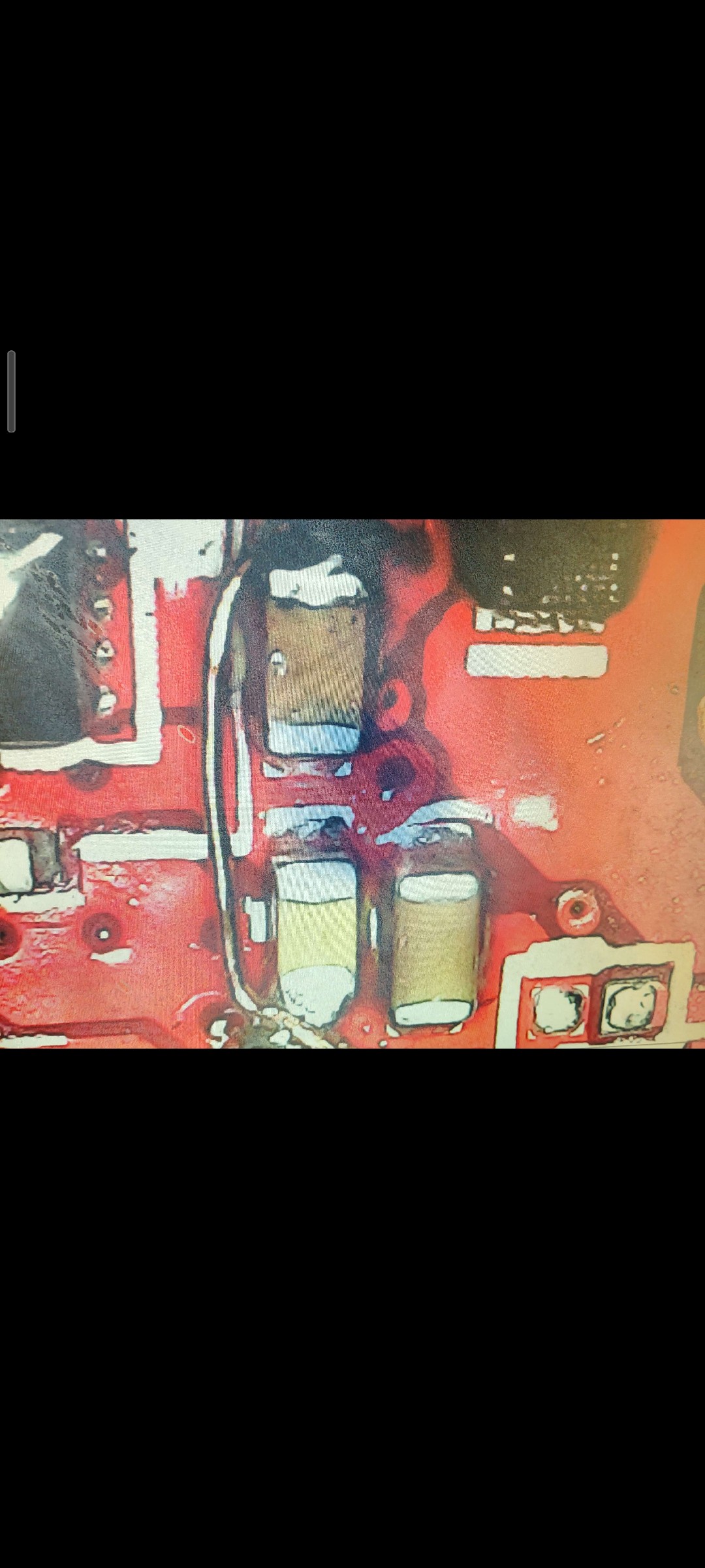

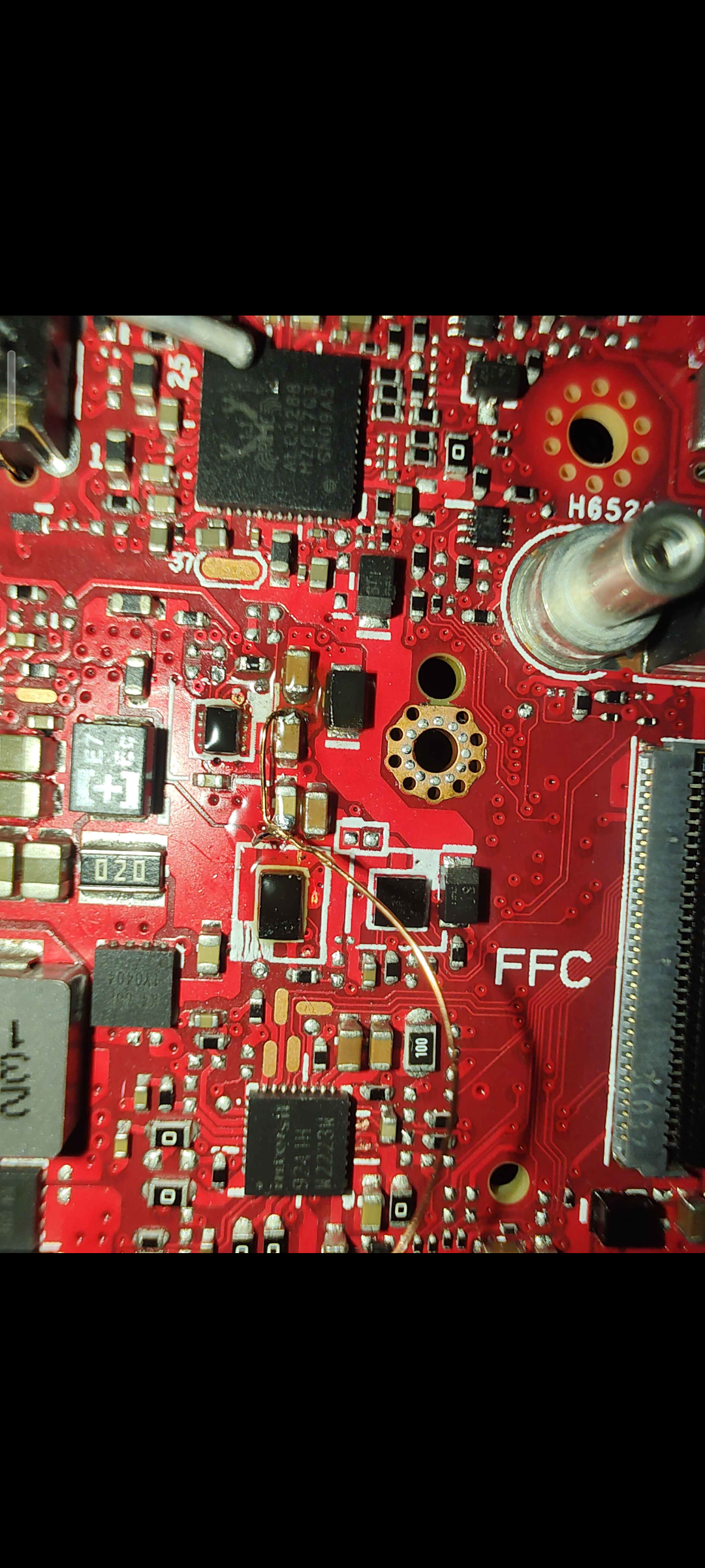

    Hello guys, I have a huge problem, I put a generic USB C DOCK on my rog ally, it gave an image and everything was fine, when I decided to put the charger on it, I heard hardware installation and it disconnected, then the DOCK stopped working and the console stopped receiving charge, I tried the charger and it works correctly, I decided to turn off the console to check the board and I didn't see anything burned, they tell me it could be the iTE chip, you may have to replace and reprogram it, what I do know is that it only has a 5v input via USB C, it does not modulate at 20The rog ally no longer turns on so it needs to detect the charger to start, can you help me? Because I really can't find any schematics or information related to the board.Thanks in advance

    Fixed bypassing over voltage protection

      Hello, good afternoon, I wanted to know about that jumper you made on the Rog Ally, did it really work? The device started charging again
      I have one that apparently has the same problem, nothing turns on after the battery is discharged

                  I just measured the voltages, etc.
                  The board has a short circuit on the VBUS line.
                  I haven't identified it yet, as the component isn't heating up.

                    VBUS is USB related. Review the local port USB load switches and also their bulk capacitors which are camped onto the VBUS pin (~100 uF). Start with removing the load switch off the board. Then measure again. If the short is still present, the fault is most likely the bulk cap on the VBUS pin.

                      I tested the capacitors, they are all shorted in the line.... maybe it is the IC itself that is shorted?

                        Correct. It may very well can be the USB load switch. Flux and remove it to test. On good motherboards, each USB port has a local USB load switch which acts like a current limit switch. Often these parts die under high current transients. They are low cost to replace.

                            Post pics of the USB area so we can review which USB load switches are onboard. There are many replacement parts for these common devices. Digikey / Mouser / Arrow should offer them and of course Aliexpress.
                            What needs to be determined if replacing the load switch is:
                            a) current rating of the switch
                            b) polarity of the enable pin (ACTIVE HIGH or ACTIVE LOW)
                            c) pinout of the device
                            The above are the key points.
