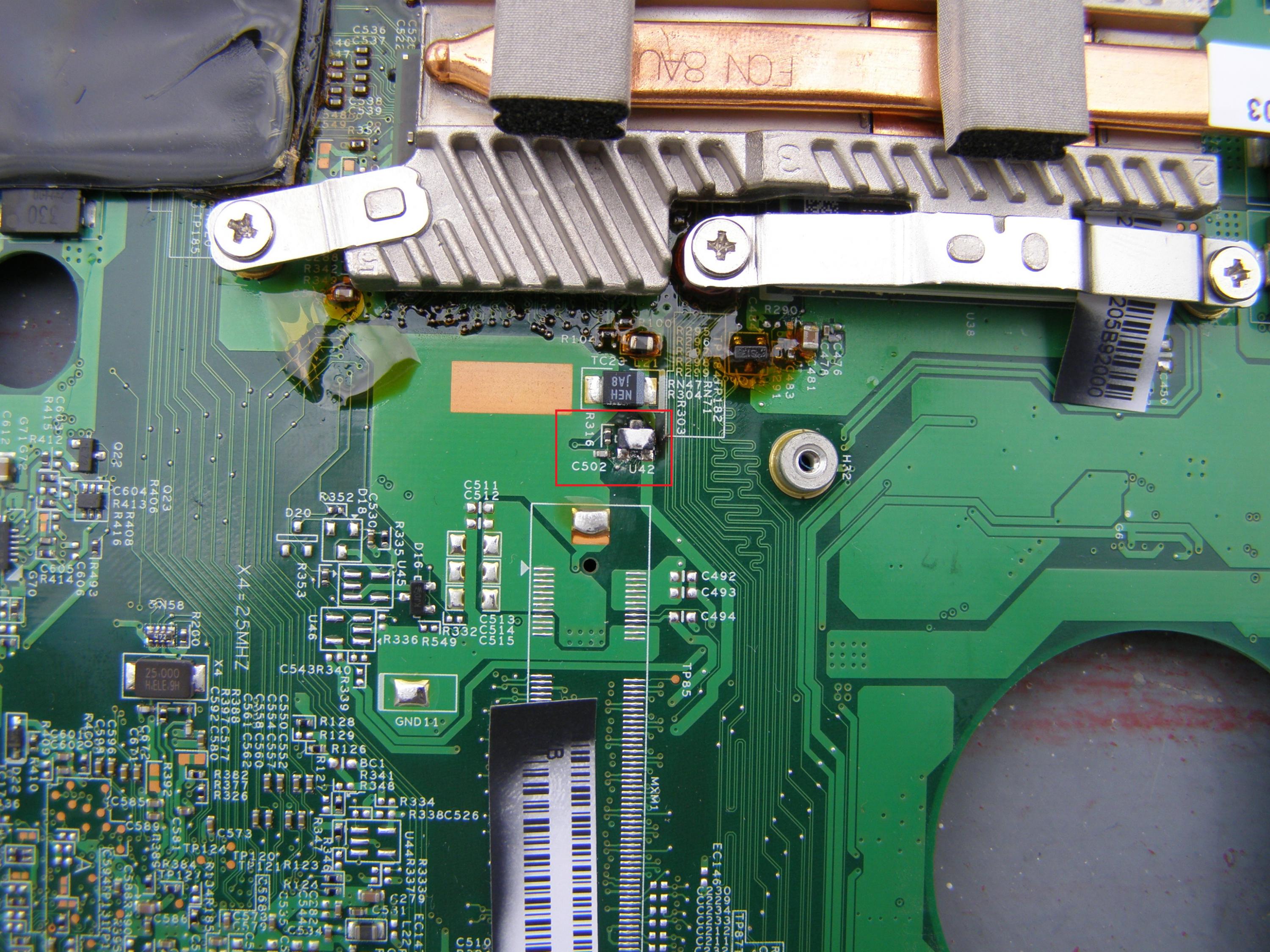

    I find on board burned SMD transistor U42.

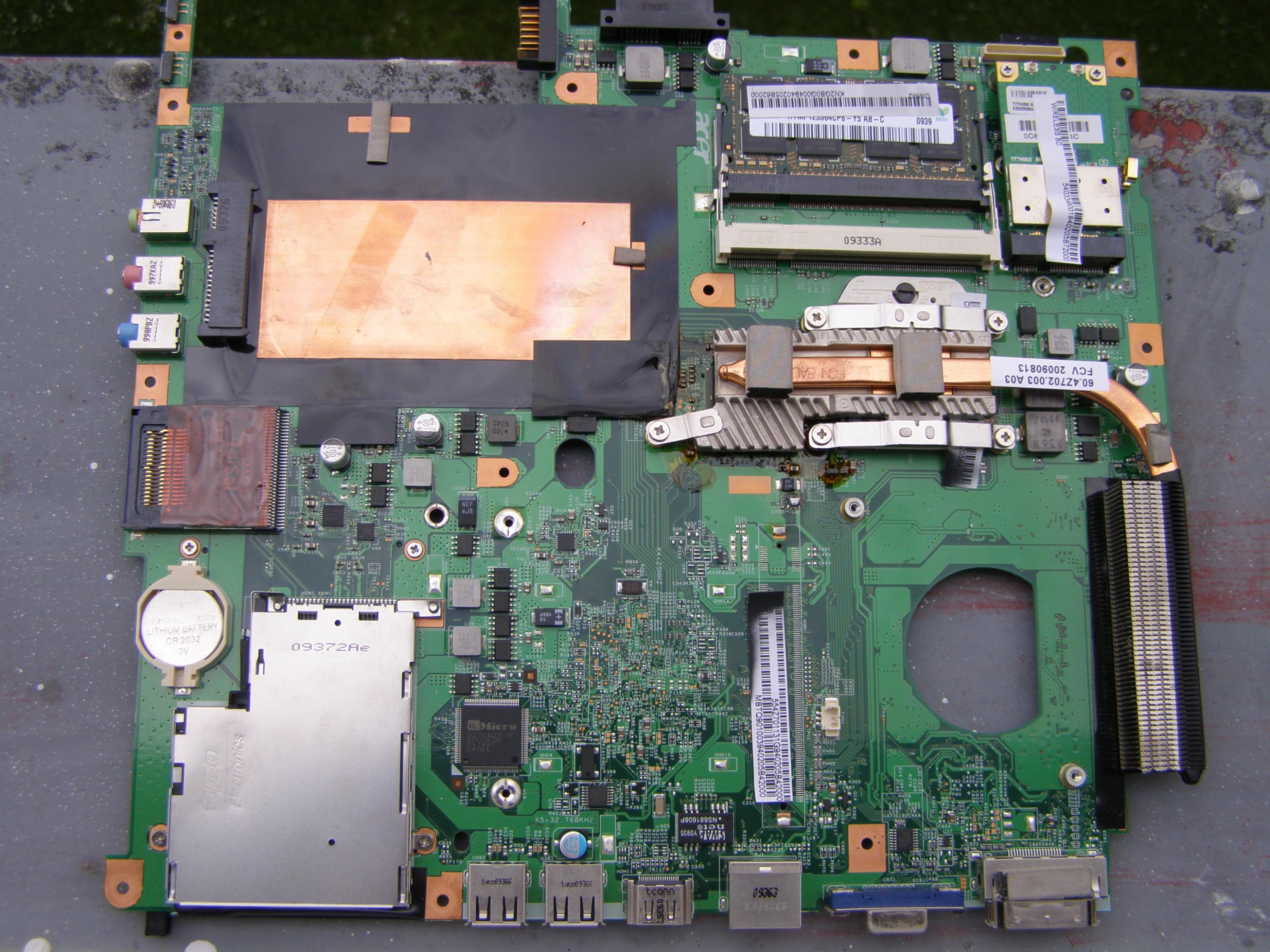

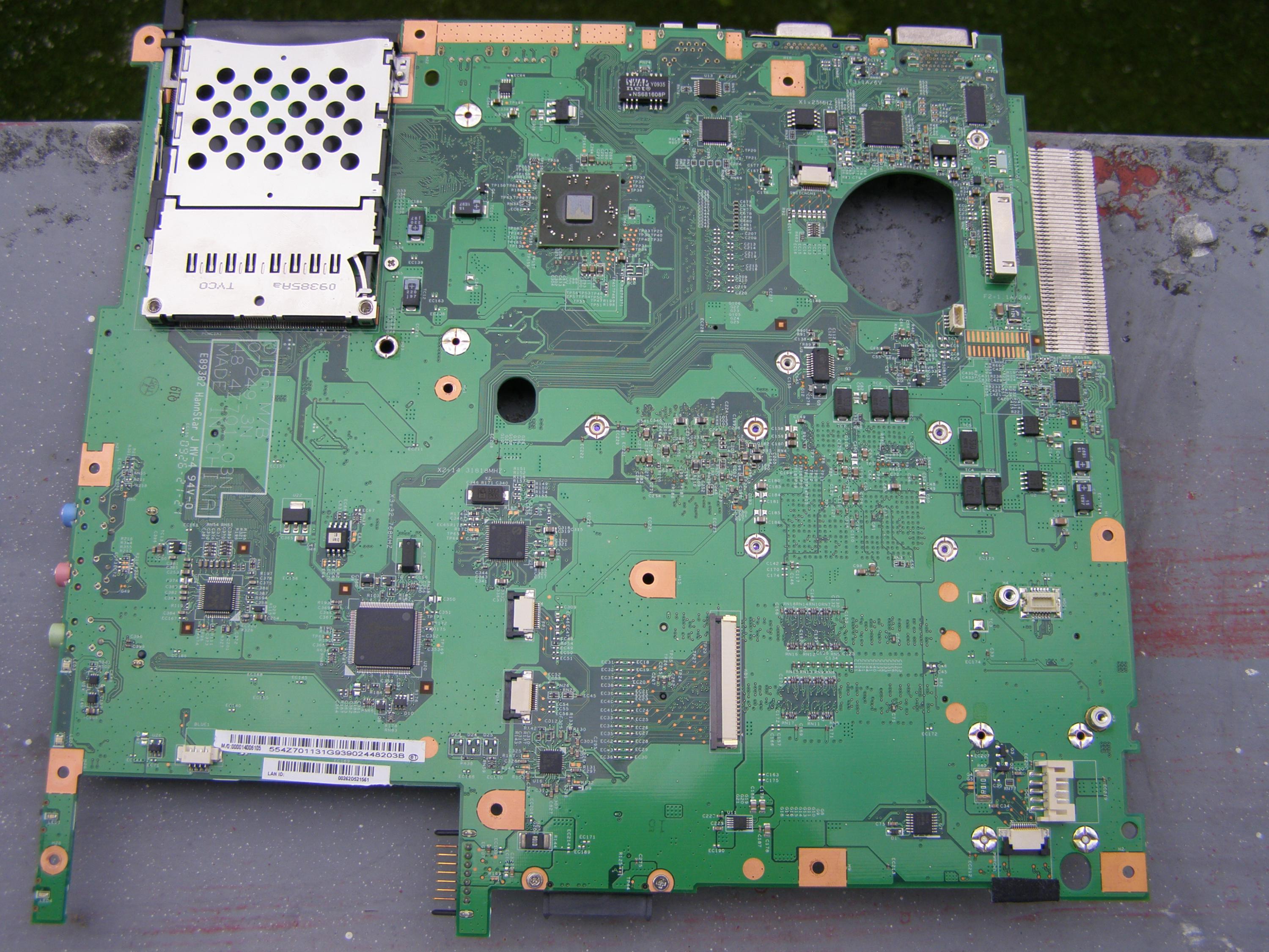

        Hello, here is photos of the board and detail of U42.

          U42 Have 3 pins, i think it is transistor.

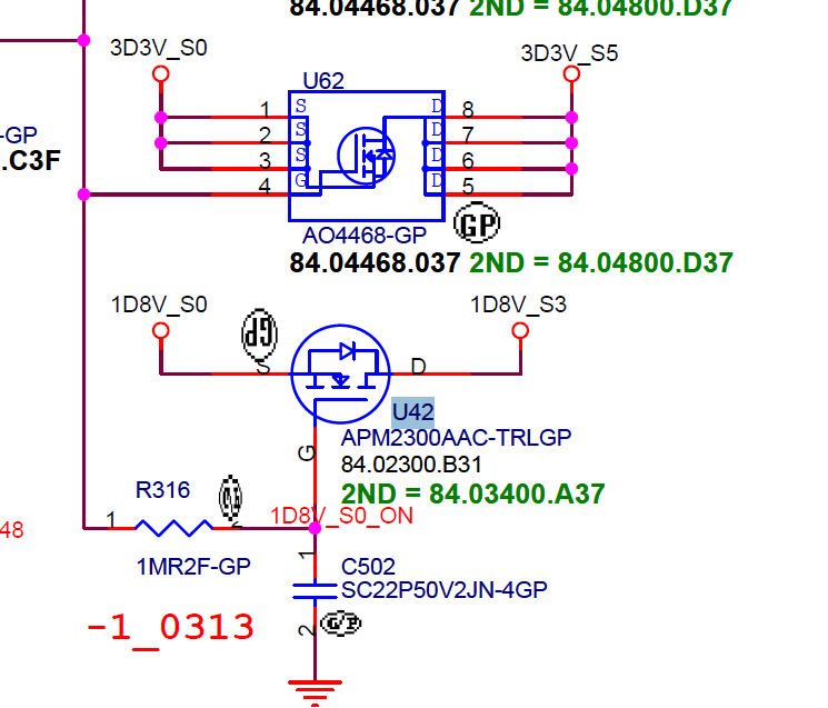

            On this schematic i find it is mosfet.
            On page 47 you can see it.

              U42 is an APM2300AAC n-channel fet. Check voltage on all pins after pressing power button to determine if fet is bad.

                Some one has heated up the gpu from what I can see in the pictures bad news.

                  On G is 4,52V
                  ON S is 0,35V.
                  ON D is 1,75V.
                  It is very hot and making little smoke when is powered on.
                  On battery I can turn on the laptop, but not turn off.
                  On AC power supply is turning on automatically, when i connect power.

                    Re: Acer Extensa 5430 Dead Board
                    And is this the problem?
                    Is the mosfet connected to the GPU?

                      Replace it and check KBC
