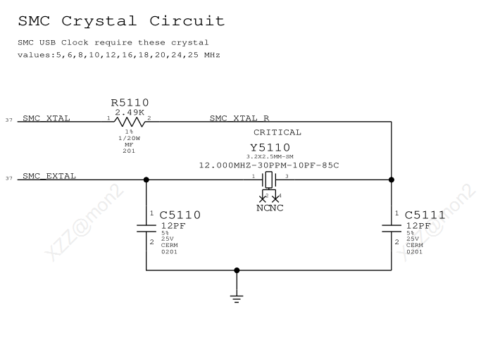

    https://logi.wiki/index.php/G3_to_S3..._and_Broadwell
    Check the operation of the local xtal of the SMC.

      Y1950=12MHZ
      Y5110=NOTHING IF I PRESS SMC 12MHZ GENERATED BUT NO POWER
