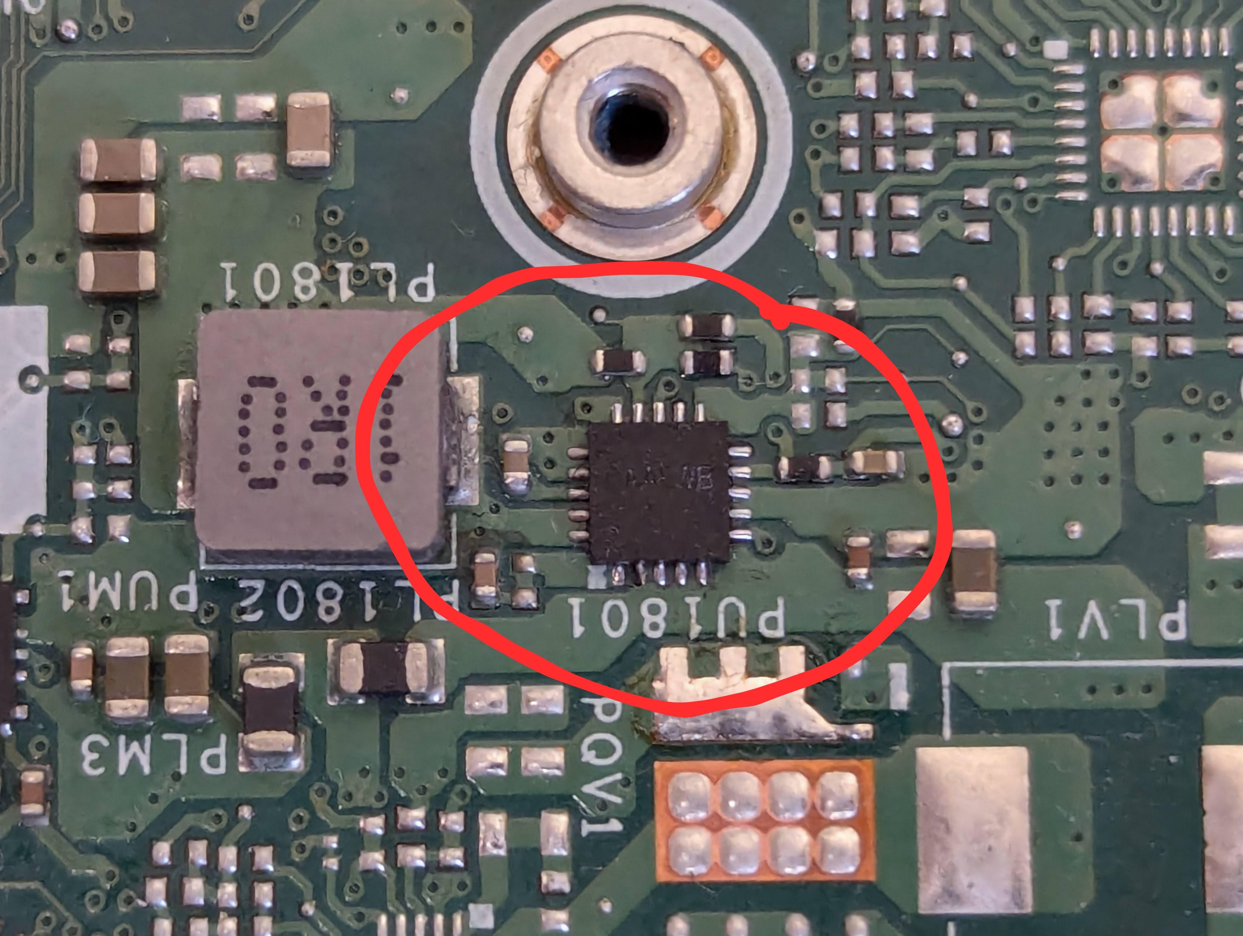

    Hello guys,
    I have an Acer A514-55-511P liquid damaged, and one component seems to have failed, but I can't figure out what this is.
    Thank you. Click image for larger version

    Markings are not clear but seems like silergy 3.3V or 5V pwm ic.What is the marking on top of IC?

      It says BAAEWB.
      The motherboard powers up for about 10-20 seconds, all voltages are right then but suddenly drop. Not 100% sure this IC the problem but looks like.

        https://www.badcaps.net/forum/troubl...12#post1538202
        BAA*** SY8286RAC (LA-F486P)
