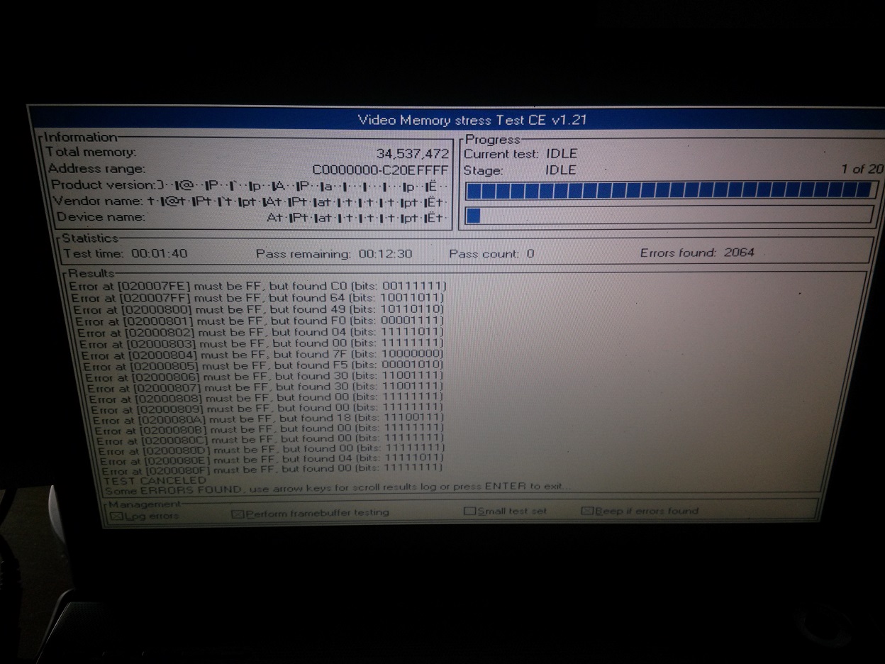

    Hello!
    I have a Asus N61JV with GPU or ram issues.
    I've reballed the N11P-GV1-A3 Nvidia chip and when I run the video stress test I get these results (see file attached) . The same I had before reballing.
    The device name and other infos are unreadable and the 1G ram isnt there...only 34 Mb??
    Any advices?
    bad ram ICs?
    Thanks for your support!

    Just to check, is there actually a problem with the laptop in normal functioning?
    I ask because some people ran Furmark on some of the newer graphics cards to check if they were functioning properly, and it came back with errors - people assumed the card was faulty when actually the stress testing program was just incompatible with them. The same could be true here.

      Well I've made a clean install and the 20 mins I had it turned on it didn't present any issues.
      Before the reball there were several BSOD.
      What would be then the best way to check the GPU integrity?
      Cheers!
