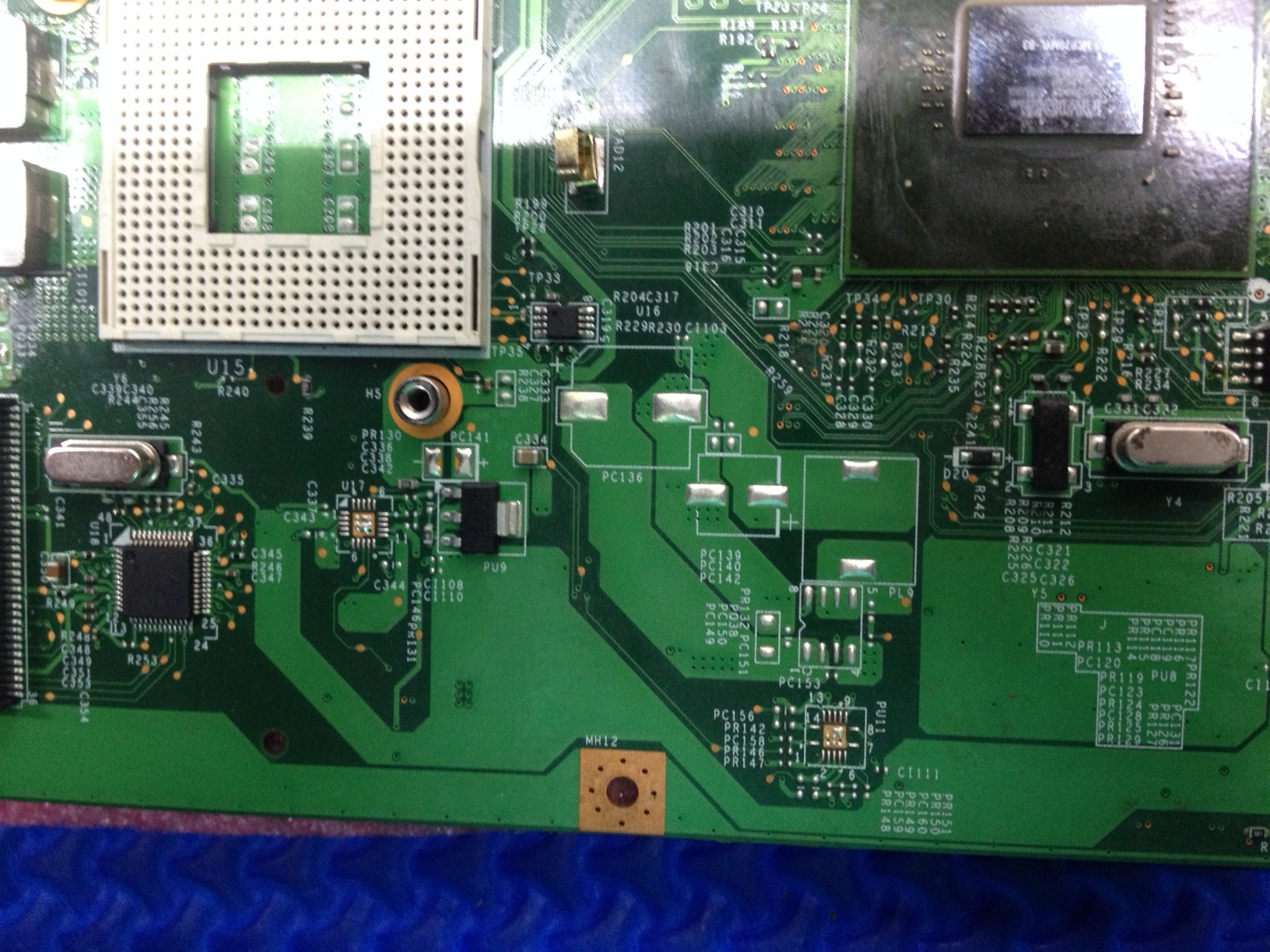

                  resistancce of
                  pl3=303
                  pl4=821
                  pl5=0
                  pl6=850
                  pl7=223
                  pl8=1013
                  pl9,pq38 and pu11 are empty
                  but pins are there see attached photo
                    Re: msi cr400 - no display
                    pepe,
                    page 28.
                    remove pl5 coil and determine which side is shorted to ground.
                    if on the right side, check components going in that direction
                    if on left, you know what to do
                      Originally posted by fddizon View Post
                      pepe,
                      page 28.
                      thanks for the reply fddizon
                      but already checked all components out of circuit towards the direction of the short, i ended up below the vga chip mcp79mvl-b3
                      its like the line of +mcp79_core is shorted?..
                      thought it was normal because in your other post you said that the vga is short and still the 4 x 330uf capacitors worked right?
                      again thanks for your time
                        my apology to that. i use diode tester with sound, when it measures low resistance value, it beeps.
                        forgot to post reading of resistance.
                        your reading is 0 which means that it is shorted as if you short your two probes.
                          To be 100% certain you have to remove and PU8, r257, r258 but my experience tells me that the problem is with the Media and Communication Processor (MCP), your conclusion.
                          You have to unsolder it and check of course first, if the short is gone on the board and secondly if MPC is functional.
